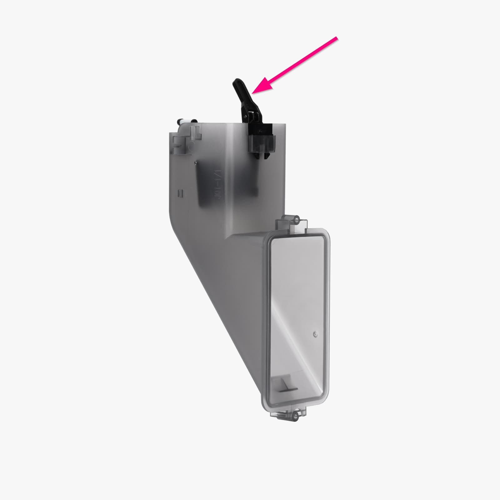

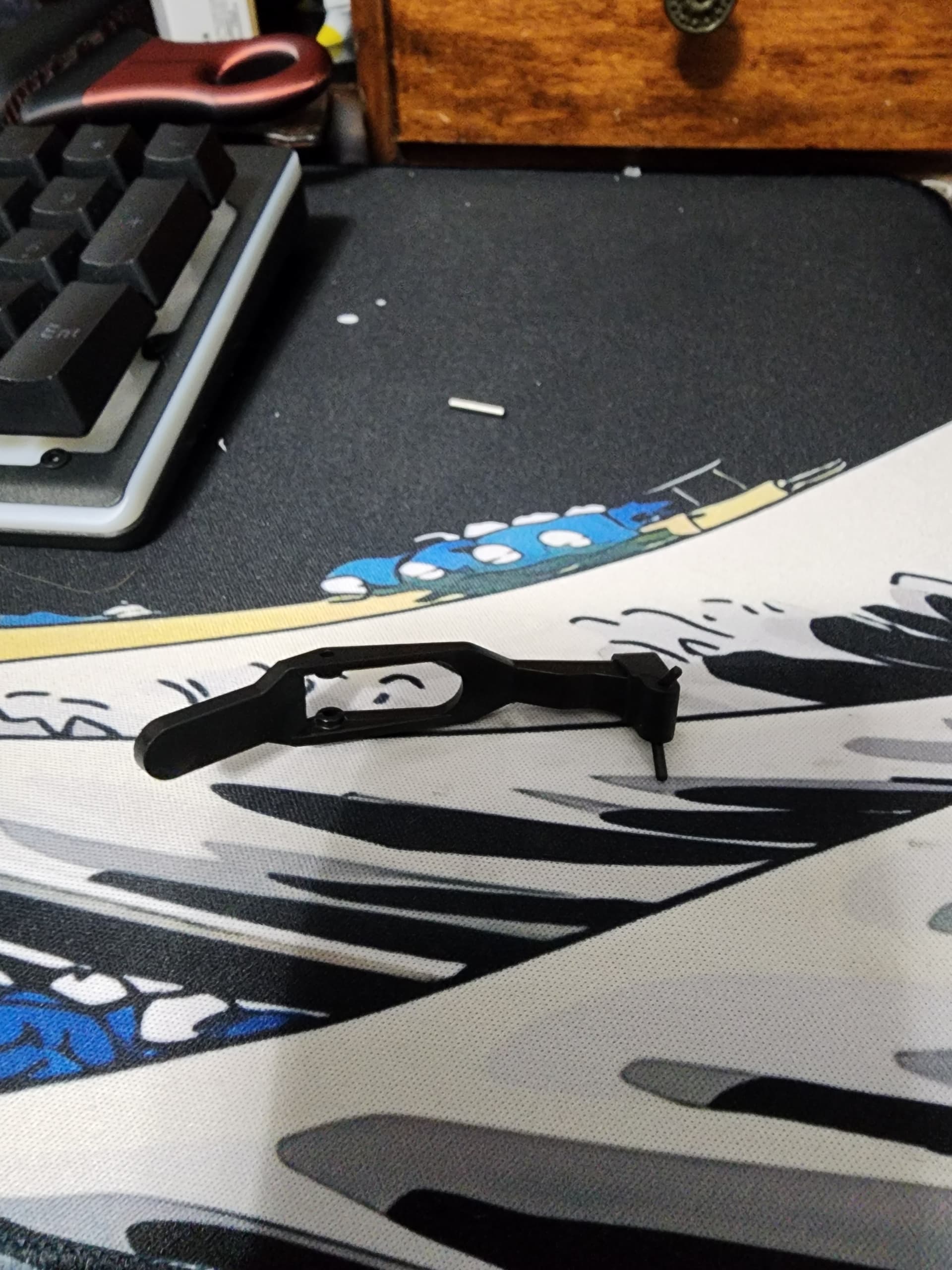

So, I am a relatively new P1S owner and have run into an issue for which I have not found a solution in this forum. That is, the $& U%) pin for the flipper/knocker has now fallen out twice, along with the flipper/knocker. Can I make a small print or other fabrication to make the darned thing stay?
Your description is a bit hard to follow. A photo of the part in question, is unclear. Are you referring to the lever at the back of purge chute AKA poop Chute?

Yes however nothings broken the pin just falls out. Not worth pulling apart the whole back just to replace the flipper in my opinion when there is likely an easy fix. Ive never done any modeling so i dont know where to even start making this fix for myself
Pins in that diameter don’t lend themselves to 3D printing as they are too thin and the resolution of the filament just isn’t precise enough.
