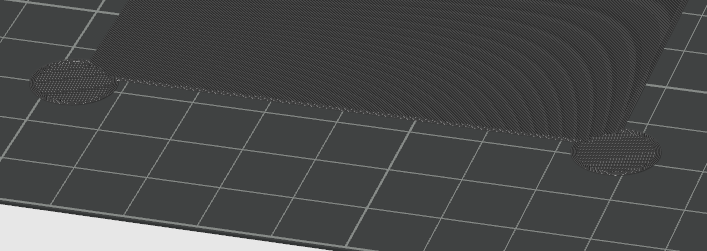

I am having some issues with corners of my prints warping. The prints have a large flat rectangular base and no supports are needed. The corners of the rectangles are warping, so following the steps from the Bambu forums, I am trying to add some disc parts:
This results in the the first layer of the print to be elevated 1 layer (on top of the discs), creating an error about a floating cantilever. How can I truly merge these parts so I have semicircles I just need to clip off when the print is done?
gcode i believe, but put picture, will be better
This is layer 1
And this is layer 2
Don’t use discs, use brim ears:
And make sure you have your auxiliar fan off.
I’ll give that a try if these discs fail. I rebooted my PC, added the discs the same way, the layers look the exact same, but Bambu Studio did not throw up a warning so I sent it.
I think the Disc page of the Wiki should be removed. Brim ears accomplish the same task with less effort and less opportunity for error.
