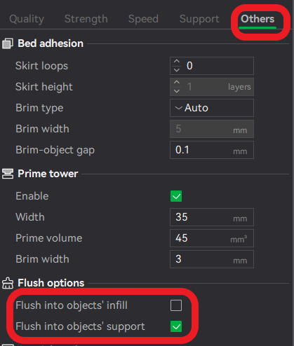

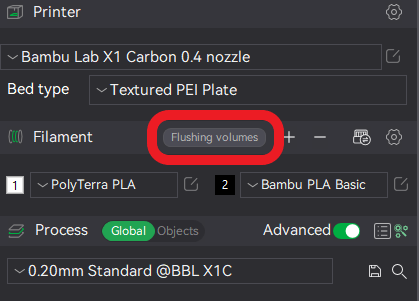

It is possible. Just change the flushing volumes to zero. Just ignore the red warning about it ![]()
Another way would be to flush into the infill where it is not visible.
Great, thanks so much. I did play with this but not enough I guess.
I’d keep an eye on it for the first color change. May not be enough in the layer infill and/or support if applicable. Flushing to zero, and a small purge block may be needed.
Just circling back on this and it seems like you need to enable the prime tower. I’ve never used a prime tower and see it just as a waste of filament. Is there any way to transfer directly from one filament to another without this option?
