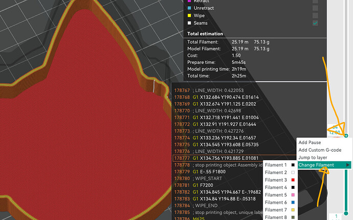

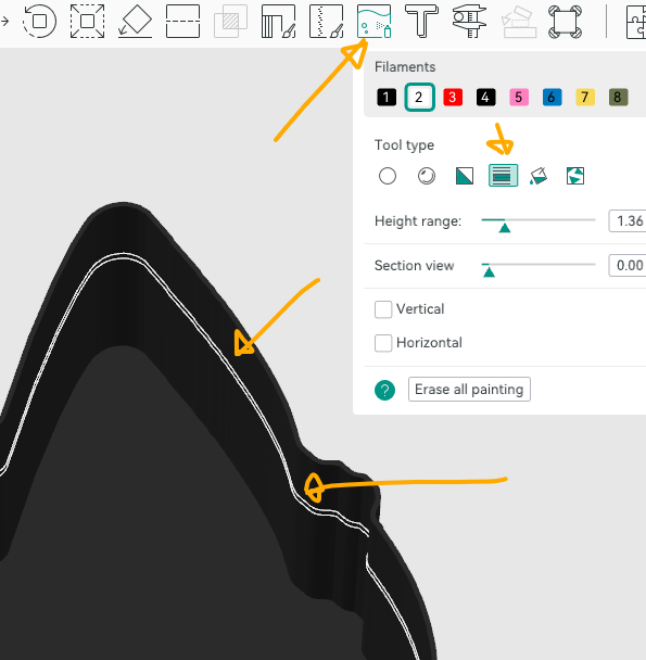

can u pls tell me how to do color for layers i mean for each layer if there is any way in bambu studio pls explain
thx
You can paint “by layer height”
Or you can slice, then add filament changes.

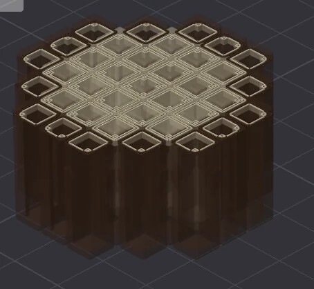

I’m printing Flexigrid Fidget Toy with custom colours, and the rectangles are two different colours, but the infill instead of being the same colour as the rectangle, is always the same infill for all the rectangles. So now in those layers with multiple colours, the brown rectangles in the area with beige infill come out poor quality in the print
When do I get to post pictures so I can get real help here
Here is my model (its a painted version of Flexigrid Fidget Toy - Free 3D Print Model - MakerWorld ):
But you can see its infilling with beige on the brown rectangles, even after I split these pieces into individual objects:
The print quality is bad specifically in the area where the brown rectangles have beige infill (only some of the layers at the top, not the other layers. And the beige rectangle layers with beige infill look perfect)
How can I fix this?
Fairly old post BUT - at least with the current release of Bambu Studio you can select Objects tab, select the object under Name and then set the infill filament to whatever color you want. I had black infill bleeding into my white wall so I set all the infill and walls filament to my white spool. May not have had that option back when this post was started?
