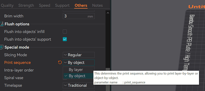

OK. Had I seen those photos first, I could have stated what was happening.
This is caused by the change in speed when traveling from one object to another.
The simple fix is to change printer order from the default of print Sequence from Print by Layer to Print by Object.
This will force the slicer to print each model completely before moving onto the next.
It is not an easy tool to use. Since one now has to take into account the fact that another model is present on the plate, the slicer forces a ridiculous amount of space as a safety margin. So let’s say you had four models that were large but fit on the plate when printing by layer. Once you change to print by object, you’ll see patterns around the models showing a new “exclusion zone”.
If the slicer didn’t do that, you could have the tool head smash into the other model. One way is to trick the slicer into printing the models in sequence so that the shorter models are near the back and the taller are in the front.
Sometimes it simply won’t let you do it all on the same plate. Here are three cylendar primitives 25mm, 75mm and 125mm in height. Note the slicer objects to the 125mm.
Using auto arrange works… most of the time but not always.
Note you can rearrange these in the objects menu as in this example.

He’s asking how to get a constant wall speed not how to print by object.
Honestly, I don’t understand the global parameter thing and what exactly is meant with constant print speed.
The printer always has to accelerate and decelerate.
