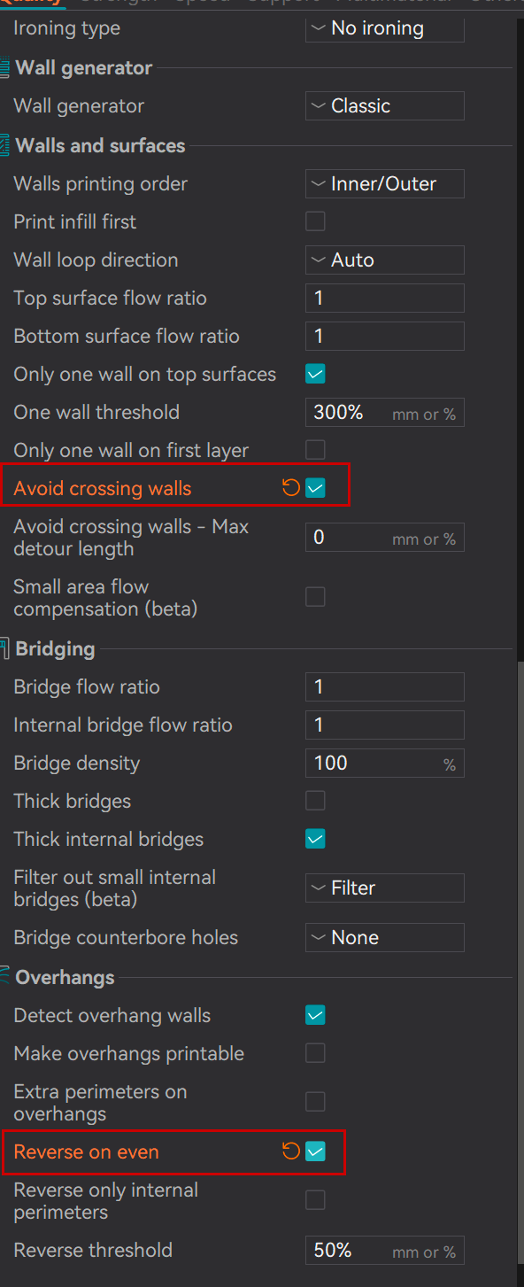

I’ve encountered an issue with a lot of unnecessary travel when slicing a thin structure for an aesthetic element—a single wall thickness where I’ve placed two angled sections on the back of the model to keep everything from not falling over while printing. However, I’m struggling to get the printer to continue the layer seamlessly above. Instead, it travels to the other side and resumes (see travel lines in the image).
I tried tweaking various settings, but I can’t get it to work.

There is no simple answer but have you tried to change the orientation of the model on the build plate to see what influences the nozzle movement algorithm?
The other question here is; what is the object or goal for trying to manage the nozzle movement? Perhaps if that were clearly communicated some of the community members may have alternate ideas to achieve the objective.
Have you tried either of these settings? It may not be what you’re looking for but both of them have an influence on nozzle path movement.

Tried Avoid crossing walls and that just made it travel inside the wall as expected.
I can’t find “Reverse on even” when searching for it

I would try Seam>Nearest. It seems like all the travel is to get back to the aligned seam (didn’t open the project, just guessing aligned, i’ll check it now).
I use Orca slicer and that may be why you don’t see it. Also, one must have the advanced option checked to view it.
Thanks, tried this and did not work weirdly.
Thanks. I tried Orca but does not work. It seems that “detect thin walls” and Arachne causes the issue. Doing classic without thin walls works. But it still makes a little loop when changing layers. Anyone know how to remove that?
