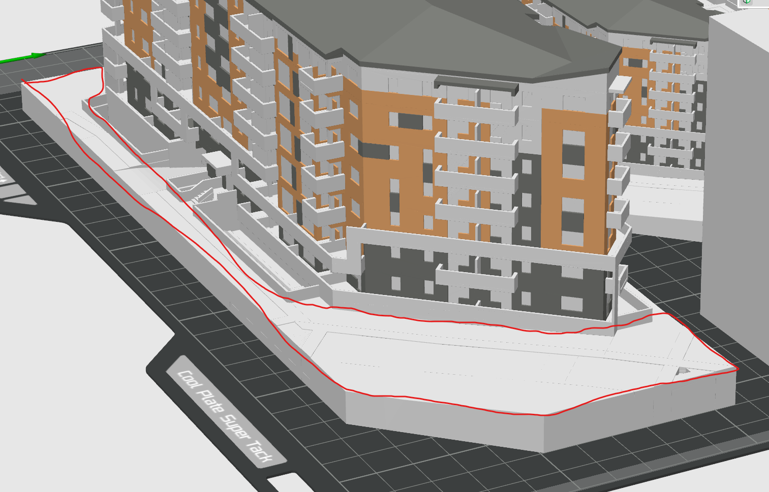

As the title says, i want to force the supports to generate from the build plate, unless it is impossible to do so otherwise. Is there a way to force priority for support generation?
1st pic is with build plate only generation enabled, where the supports generate from the outside, as they should.

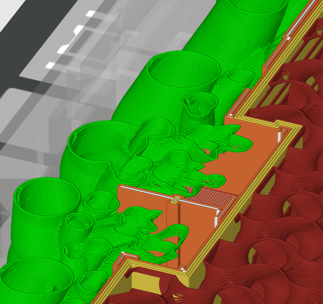

2nd pic: as you can see once i turn off build plate only, the supports start generating on the model, even here where it was not needed before.

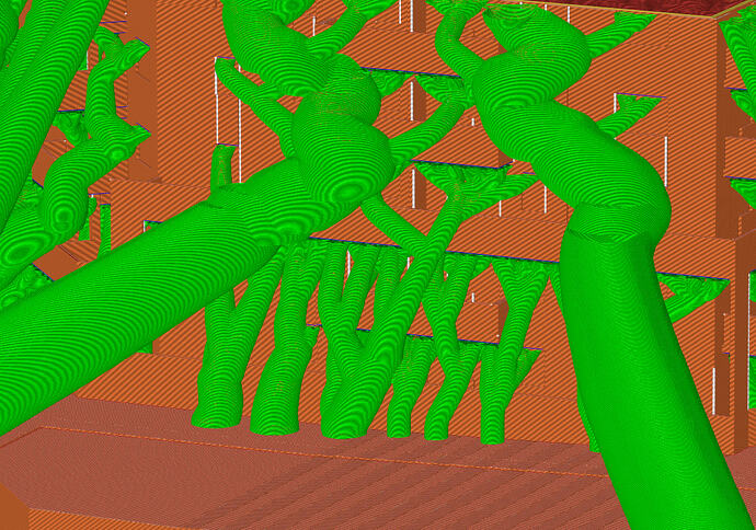

3rd pic: at the bottom here it is obvious that support generation is needed on the model itself, but i want the supports to generate like this only when it is absolutely necessary.
Is there any way to achieve such a thing?
or if it possible to enable on build plate only, and enable support generation only on this bottom surface

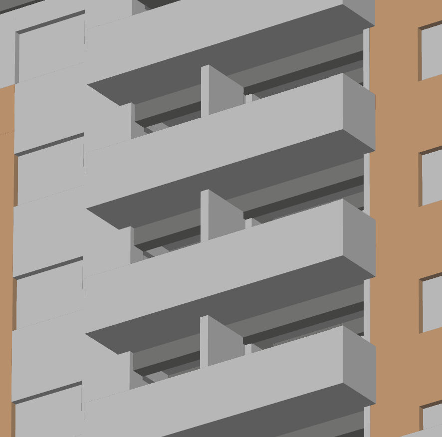

yes, the problem is all of the balconies have to be supported from the underneath, i don’t think there is any way around that.

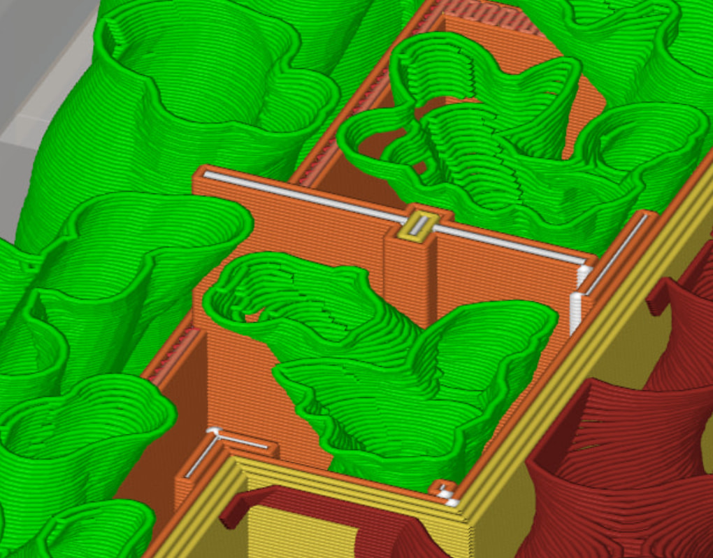

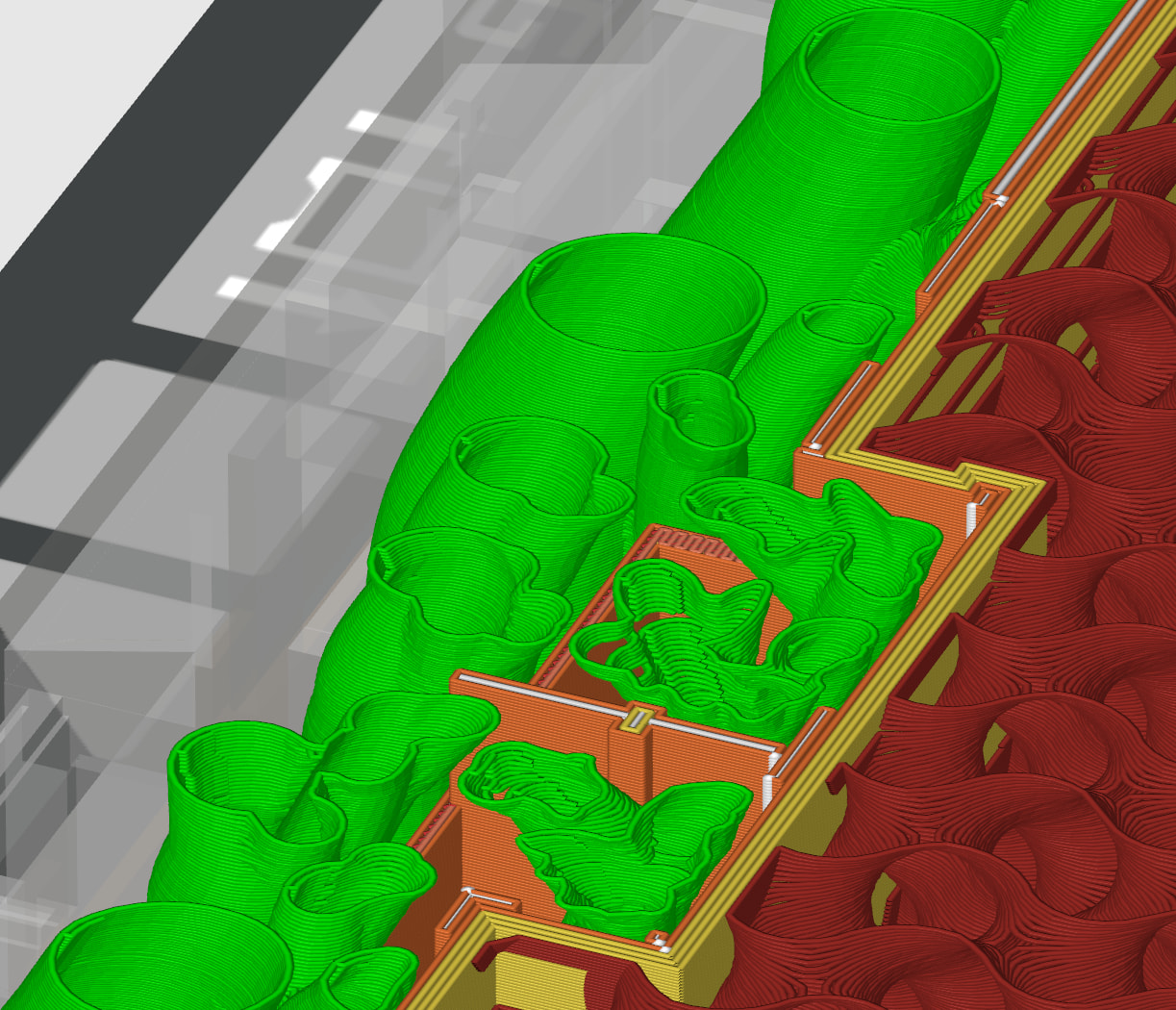

I think your underlying model is kinda unsuitable in its current form
Zoom in here, look at all these unconnected outer walls
I get that this architectural model is just scaled down hard, but there’s still an air gap in there. It’s trying to print those as freestanding bits, seperated by like 0.1mm. Gonna print like crap IMO, and pull apart when you try to remove supports.
Maybe experiment with “XY Wall Expansion” by like +0.1mm [or more, test] to make all geometry fatter, and it will blend all those discrete objects into one. Or go back to the CAD/design that created this and see if it can export in a solid mode.
I’m using an h2c with ams pro, all nozzles 0.2mm. I have ordered some pla support(new version) but it is due to come in 1-2 weeks due to slow shipping. I think it looks like a lot of infill because of the 0.2 gyroid. It is 3 wall loops with 7% infill. The reason it was a lot of walls is because of how the model is exported from rhino, I want it to be a thin shell of color over the model hence the many walls. I have printed such models before but the supports in the balconies were always a pain to take out, since they ripped the railing off even if I was really careful when pulling it out. Perhaps with the pla support it will be better. It does not need to be especially durable, but I don’t want them to feel too flimsy/light when held
In the cad they are all connected, I think the way rhino exports causes this. I will try the aforementioned XY wall expansion.

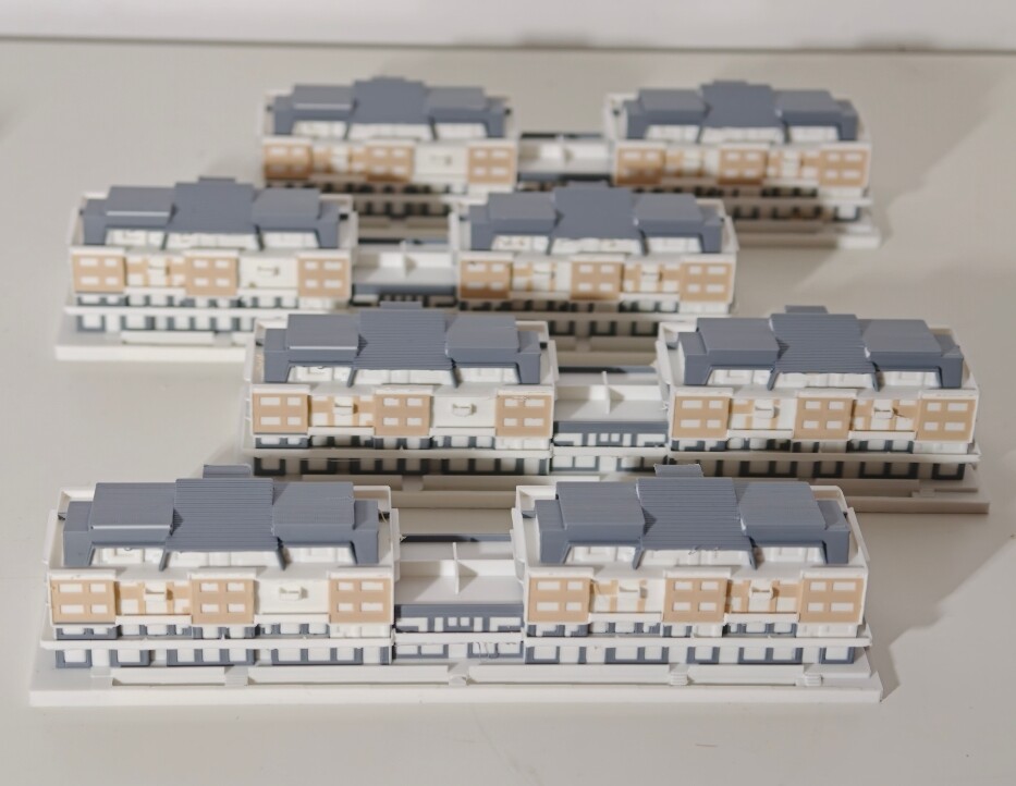

This is how they turned out before, on a smaller model without the balcony issue. The really thin walls seem to merge alright but I will give the XY wall a shot.

Oh, i take back [maybe?] some of what I said, if those are multiple filament types they might be properly fused together despite being outerwalls-to-outer-walls. Can’t see that data in the line type preview. Moreover if youre using multicolor; you cant use Wall XY expansion, feature doesnt support it.
