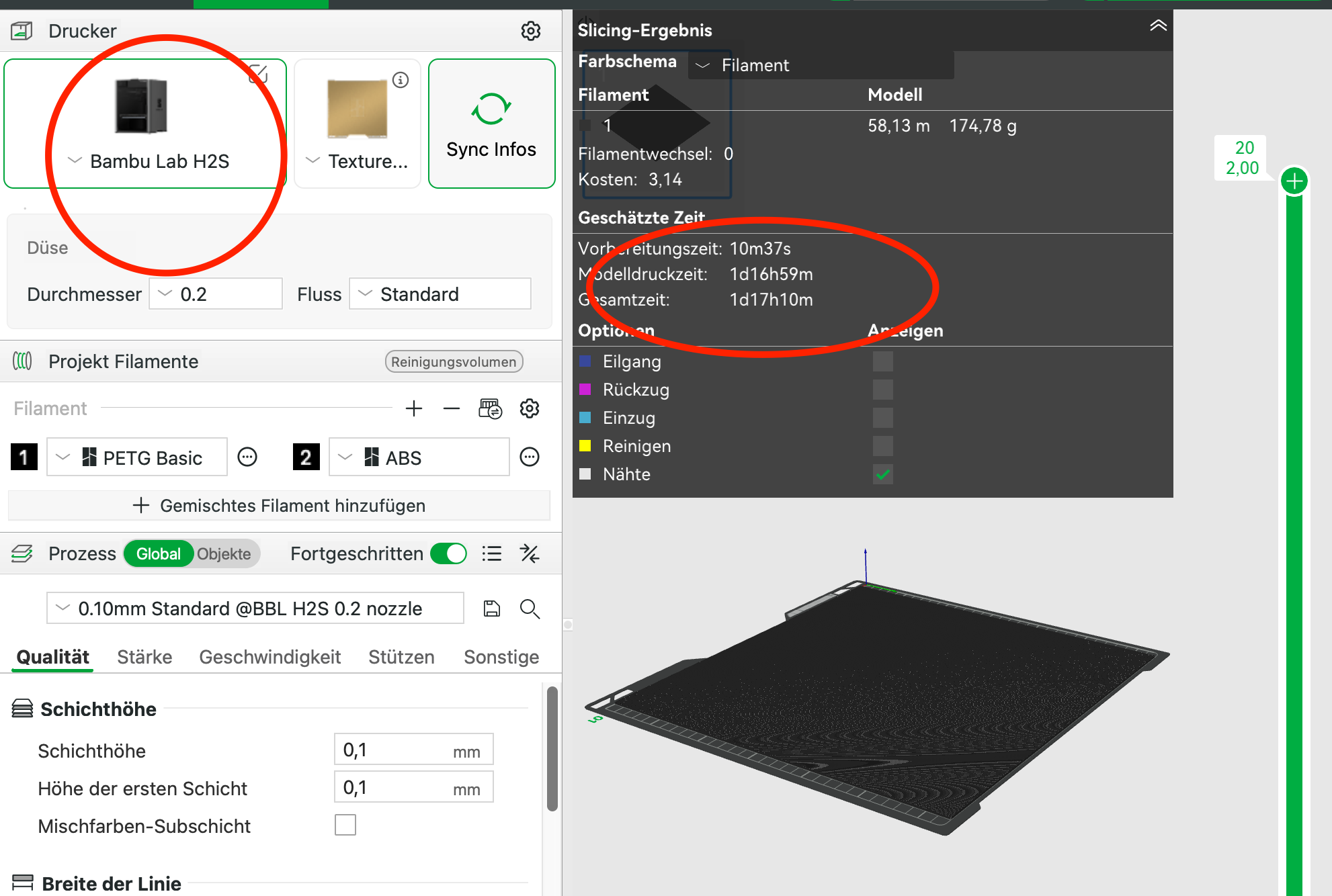

Hello,
I own a P1S and just wanted to test the maximum print area of an H2S. I don’t have an H2S, but I configured the printer in BambuStudio and tested whether my board (32x32x2 mm) could be printed: Yes, it can, but: The print time is listed as MORE THAN A DAY at 175 g!!! What’s the problem here? I don’t think it would take that long “in reality,” would it? I don’t understand it. Is Bambulab having trouble with it when a “real” H2S isn’t connected?
Well, you are using a 0.2mm nozzle (usually defaults to 1mm³/s max flow) for a full plate print with 20 layers. So very long print times must be expected.
Do you really need this level of detail, though? Slicing with a 0.4mm nozzle and “Arachne” wall generator can get quite decent outer wall details while “Adaptive Layer height” allows you to play with the z-resolution to layers where needed.
