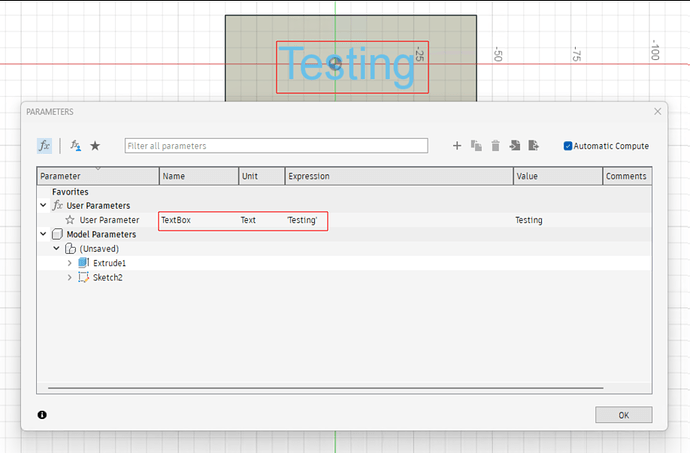

In Fusion, click MODIFY, then Change Parameters, then modify values to suit your needs.
