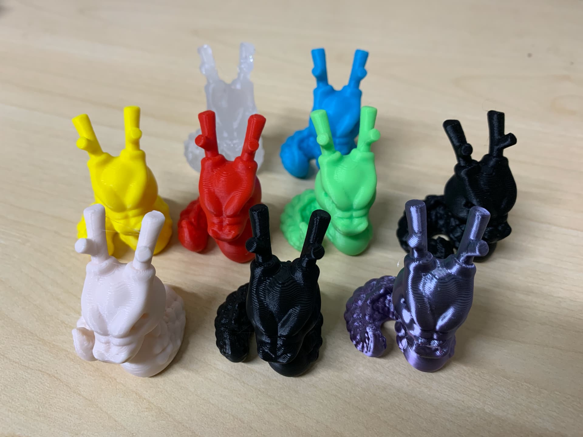

Here’s my samples (so far!) I think they’re much cuter than Benchy.
I am not spaghetti! Perhaps cavatappi, but not spaghetti! :smiley:

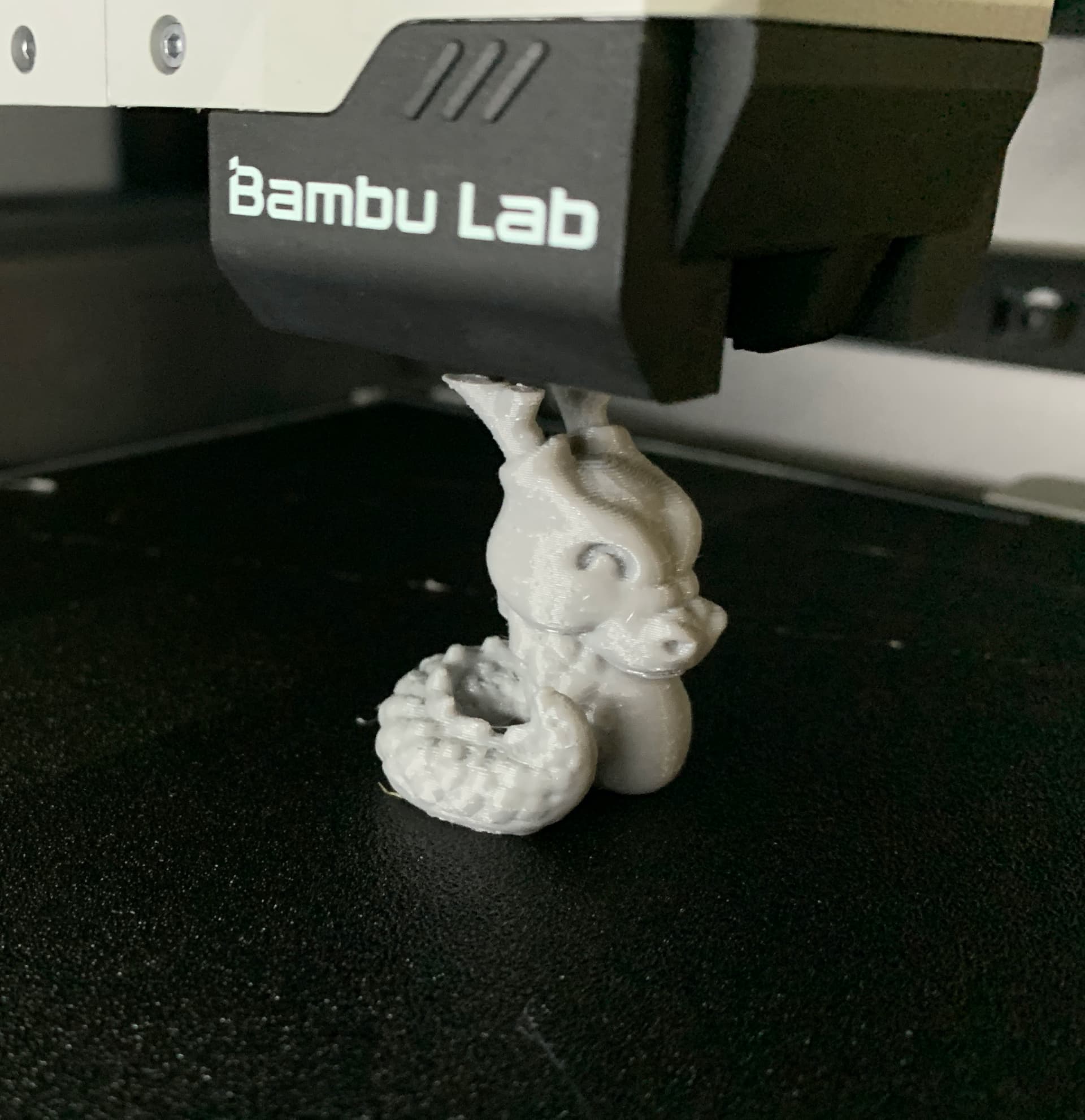

(This photo is from a print job that had just “soft reported” a possible spaghetti, and soon afterwards paused the print - a “hard stop” - for the same reason)
