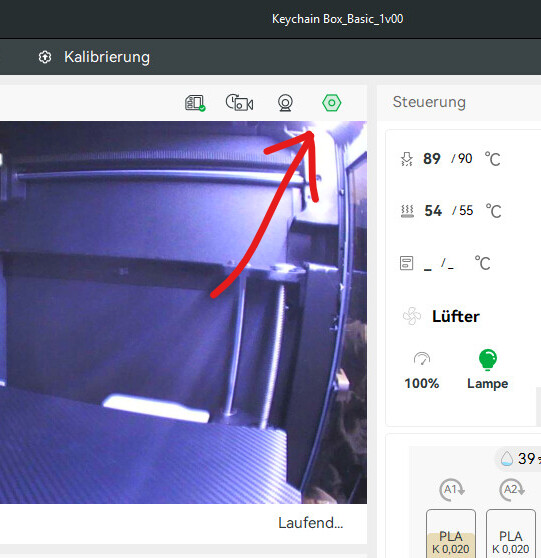

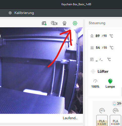

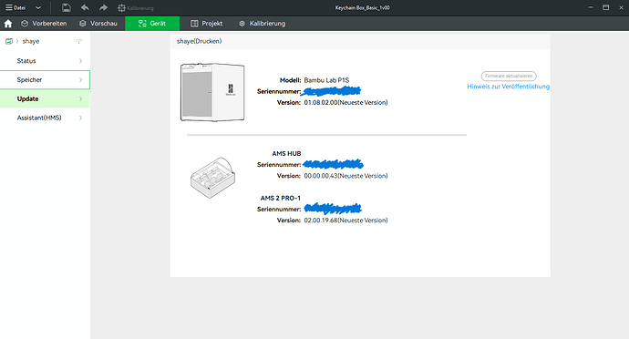

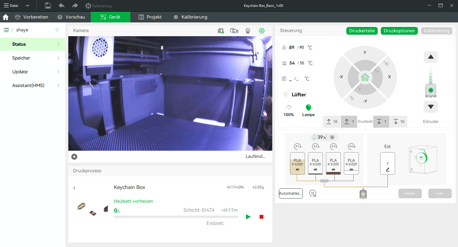

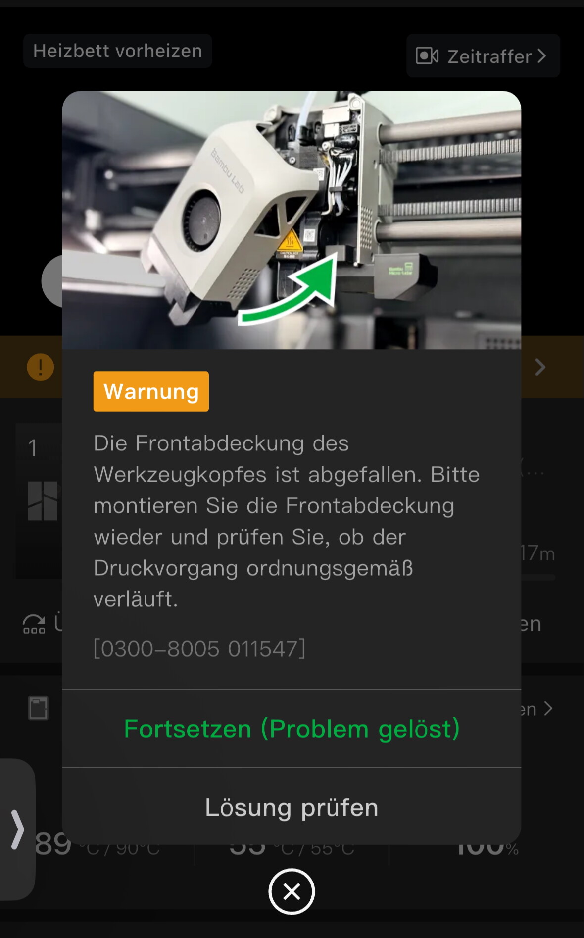

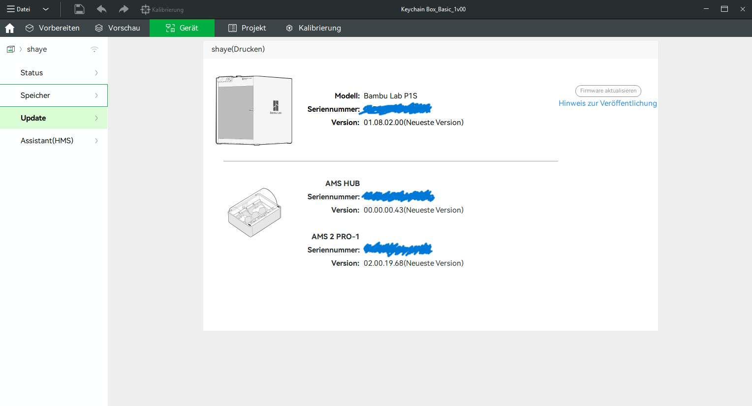

i keep receiving the error message: “Front-Cover fell off” on my P1S, which is almost new. This issue started after I replaced the printer’s cooling duct. (and after getting the error Messages i switched back) Since then, the error appears during nearly every print — especially when the printer attempts to change the filament using my AMS 2 Pro.
All cables are securely connected, and the front-cover magnets align properly. When I press Resume, the print usually continues without any problems. However, the constant interruption is very frustrating.
And today it was not resuming and i thought i need some help.
For reference:
Error Code 0300-8005-011526 – Bambu Wiki
(sorry for the german screenshot)
I would appreciate your guys help in resolving this issue.
