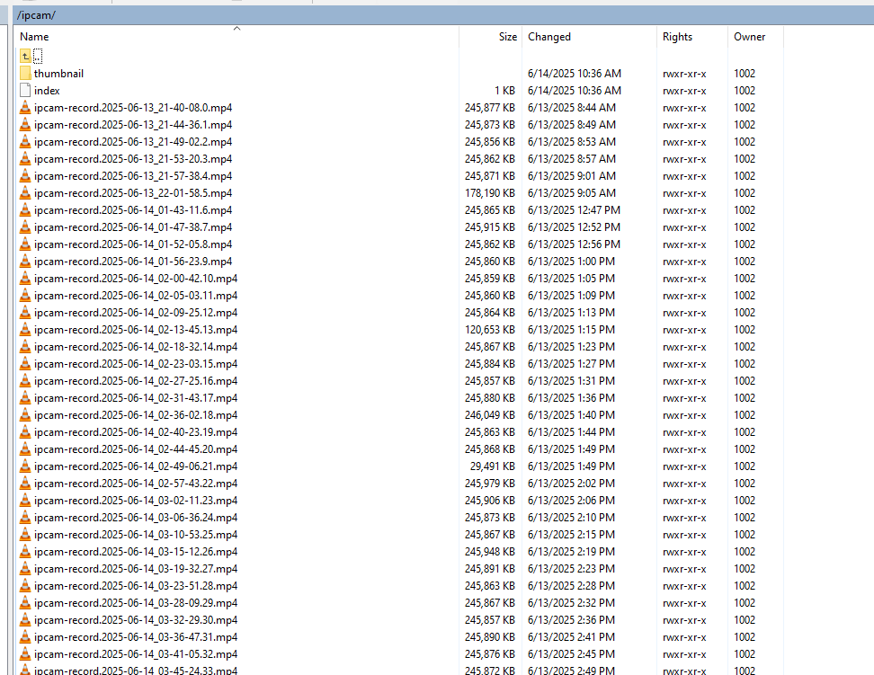

What is slightly annoying is my videos and timelapses are tagged with China date and time in the filename and even my P1S in LAN Only mode does the same like if it still accesses a Chinese NTP server.
This makes sometimes hard to find video from memory on the time I printed unless I substract 6 hours (I’m in Europe) from the time on the filename or rely only on the date/time of the file, not difficult but annoying.
That’s interesting, I do not see that behavior when I connect via FTP and all my times are accurate.

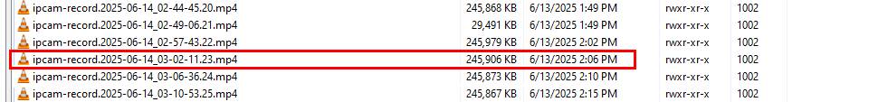

You have the same “issue”. Let’s take that file from your list:
The file is: ipcam-record-YYYY-MM-DD_HH-MM-SS.“index#”.mp4, in this case June14, 2025 at 03:02:11 but you recorded it on June13 at 2:06PM
The file is stamped 13 hours later (Shenzhen time) so I suppose your are located on Central Standard Time zone (CDT currently).
