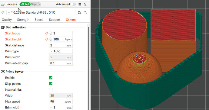

I guess you mean draft shield? yes, I think you can set it up in category others. If i remember right, you have to setup a skirt. then you can either select draft shield or at least change the height of the skirt to the same as your model. not at my computer at the moment to give a more concise answer.
Studio creates the wall as a skirt, in the Others menu. Just set the number of walls, the distance from the objects, and the necessary number of layers.
OrcaSlicer is similar, with a few more options.
Skirt type determines if one skirt surrounds all objects, or if each object has its own skirt.
If Draft shield is enabled the height is automatically sett to the top of the objject.
