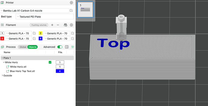

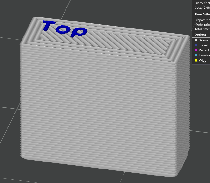

Top Horizontal Text
Steps
Fusion 360 - create text
  1. Create Sketch for text in main body component
  2. Create Component to put text in
  3. Switch to text component
  4. Extrude text away from main body - as new body
  5. Change appearance of Text to new colour
To Export
6. Export Main Body as stl or 3mf
7. Export Text Component as separate stl or 3mf

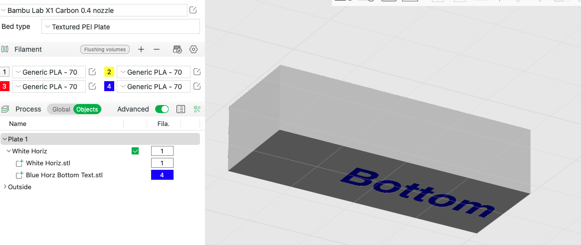

Bambu Studio
8. Import both STL files or 3mf
9. Assign files to appropriate extruders

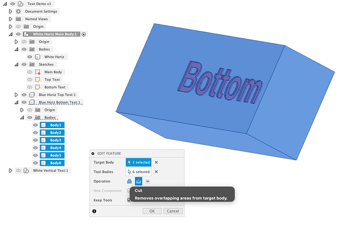

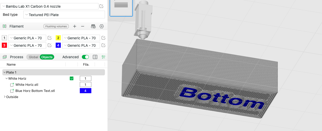

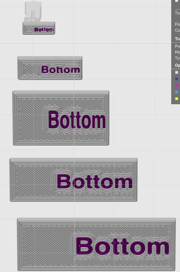

  1. Bottom Horizontal Text
Fusion 360.
  2. Create separate component to contain extruded text
  4. Extrude text up into main body - one or two layers thick
  5. Switch back to main body component.
  6. Combine main body component with Text bodies - specifying cut - so that text is cut out of the main body. Also specify keep tools.
  7. Switch back to Text component
  8. Set appearance of text bodies to be correct colour
Export
As top text -
  1. Export main body as stl or 3mf
  2. Export text component as separate stl or 3mf
Bambu Studio
As top text
  1. Import both stl files
  2. Set each file to correct extruder

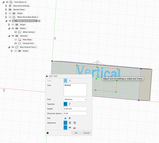

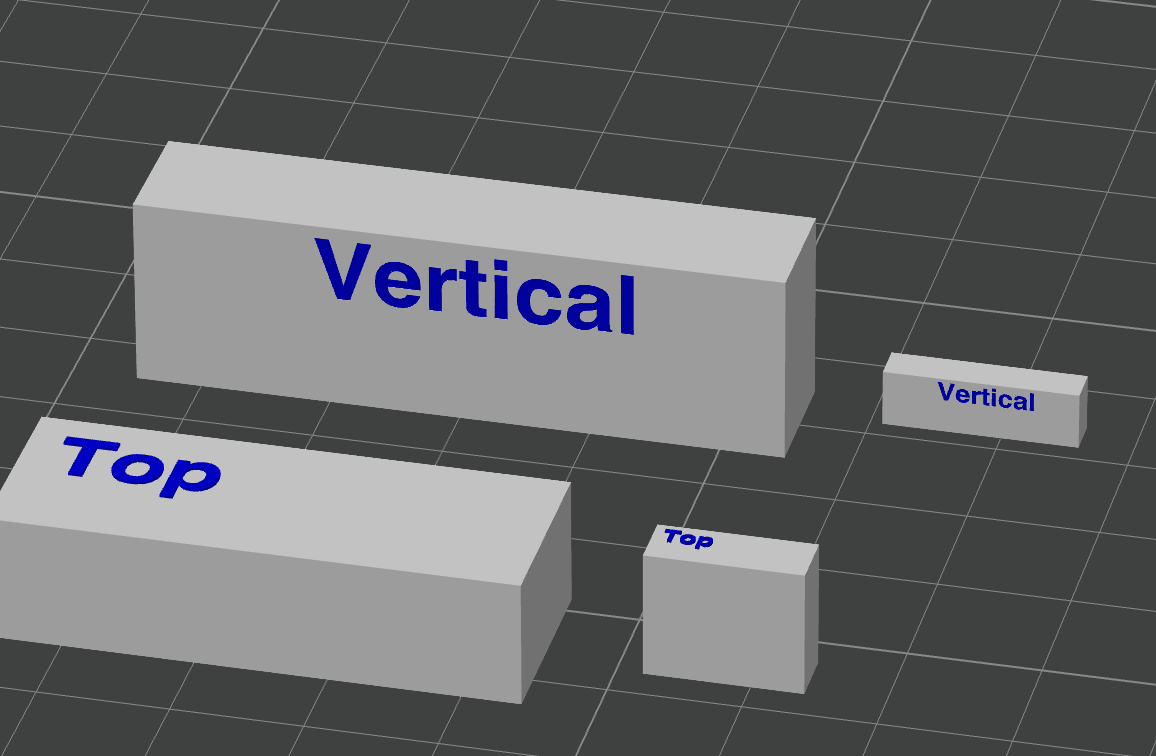

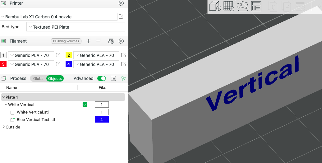

Vertical Text
Whilst Vertical text is quite expensive in terms of time and wasted filament - it does come out quite nicely, and can go pretty small - even smaller than horizontal text. I managed fonts down to 1.5mm
Fusion 360 - very similar to bottom text
  1. Create sketch on main body to contain text. - I found Helvetica Bold worked quite well.
  2. Create component to hold text
  3. Within text component extrude text into body - a few mm’s worked well for me
  4. Switch back to main body
  5. Combine main body with text bodies - to cut them out of main body. Keep to Text body’s by saying keep tools
  6. Switch back to text body and colour the text by specifying an appearance
Export
As previous two examples
7. Export main body
8. Export Text component
BS
9. Import files
10. Set objects to appropriate extruders
11. Check layers to make sure that text colour only appears on layers expected. I did some text on an angled vertical extrude and ended up with text inside the body that did not show - but required colour changes still and therefore wasted time and filament

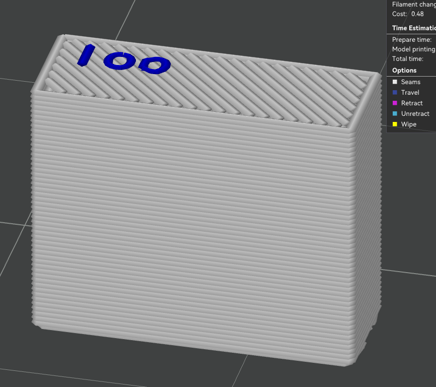

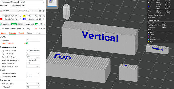

Small text - slicer options
With classic slicer - and some small text - such as this
Normal slicing doesn’t work that well on either lot of small text
Detect thin walls improved Vertical, but horizontal still not good enough - as some parts of text lines still too small to get created
Switching to Arachne wall generator - helps both I think

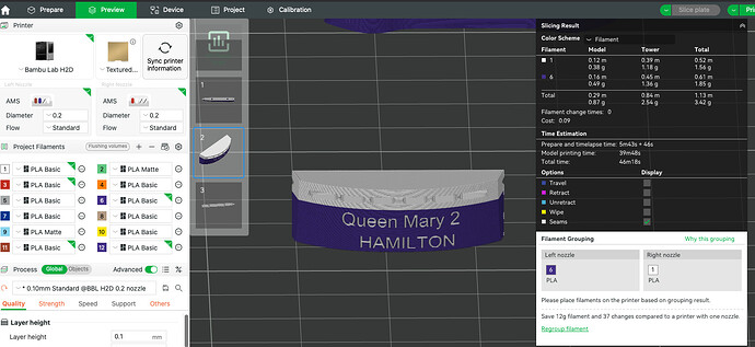

My primary issue is the lack of text clarity. I have found the Arachne wall setting, really slowed first layer down, set line width narrower, especially on the bottom layer it is not producing great prints.
Example, very simple 40 mm round key tag, white, add suitable size nnn-nnnn for phone number in color of choice.
The bottom layer always seems worse than the top (same font, same size) … and ironing the top can work great for the flat area, but when it irons the numbers and causes bleed on the top edge.
Mainly on the bottom, it leaves some small holes and the main color has " fuzzies " present in the lettering, and it just looks second rate …
( I may have to invest in a 0.2 nozzle to do this kind of thing, but I’m hoping to avoid having to get into nozzle swaps, between regular printing and then something more compact with colored letters. )

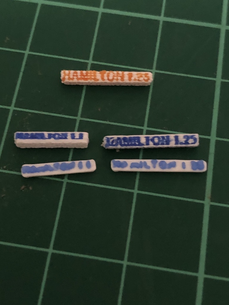

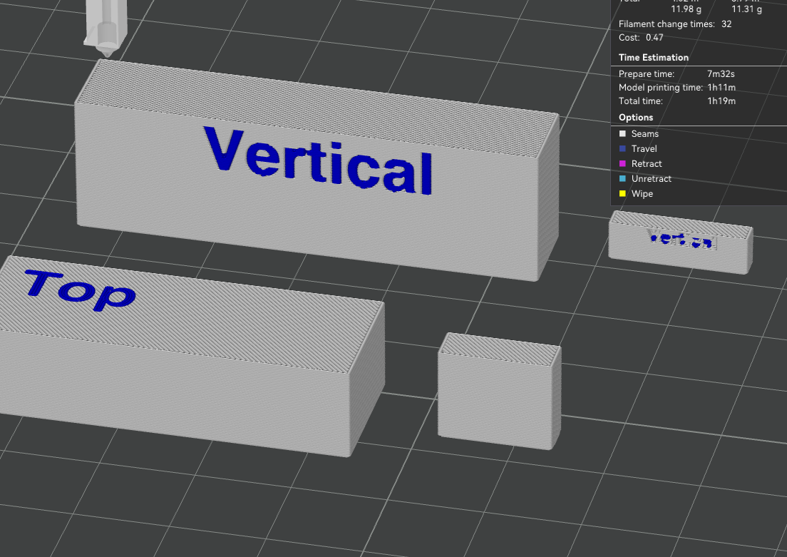

For Vertical text I have been able to get text size down to 1.25mm - see attached picture.
Orange text is vertical with classic slicer. Blues are with Arachne. Top two blues are Vertical and bottom two are horizontal top surface.

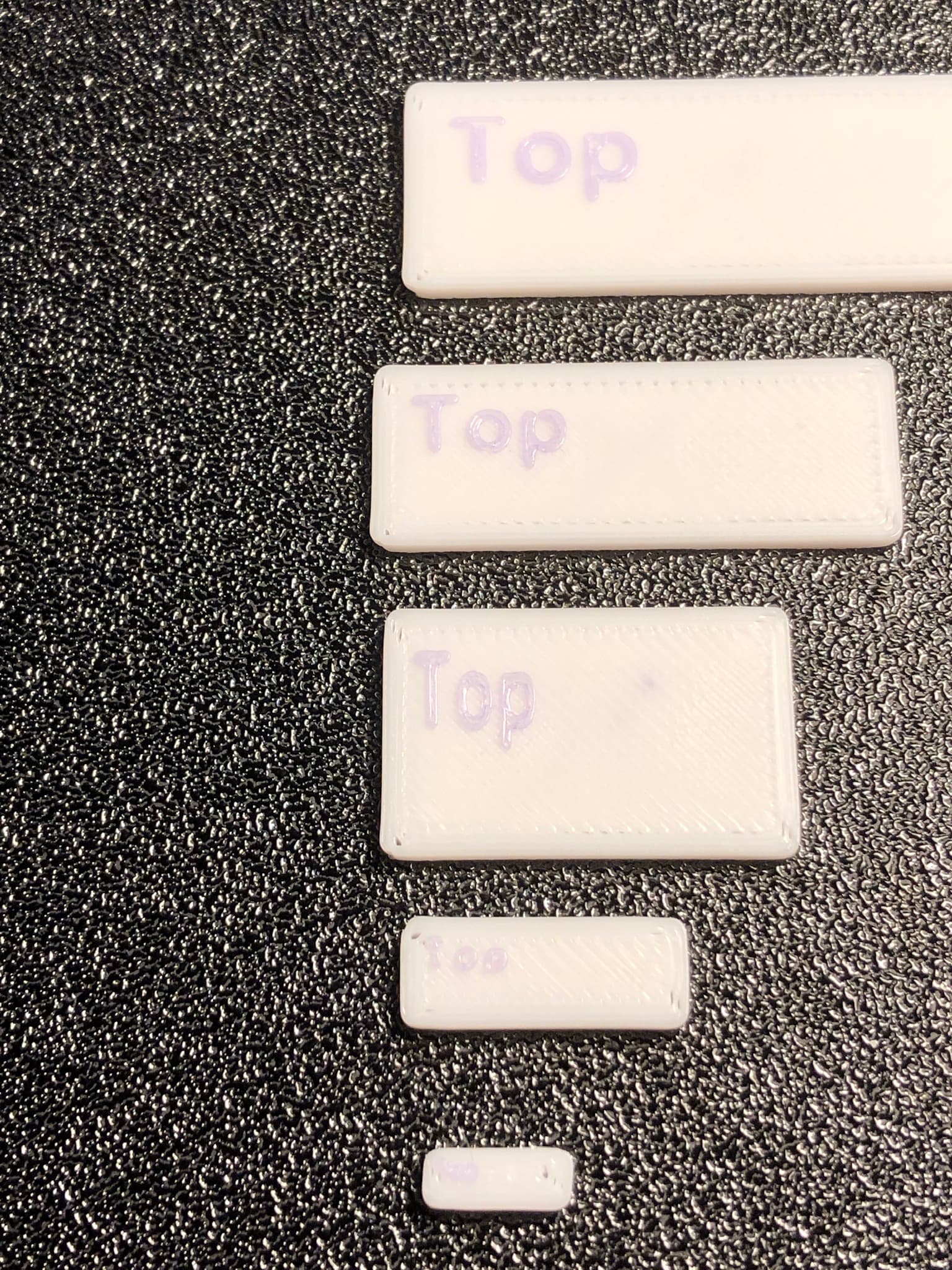

In terms of how small you can get with Arachne on Horizontal text - the following examples are of 5mm down to 1mm text.

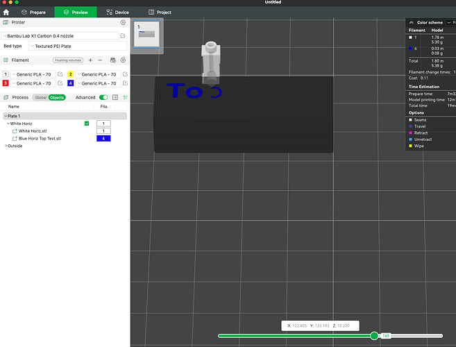

Top text - slicer view
Top Text actual print - where it shows you can get down to 3mm, but not down to 2mm. NB/ This is with no special settings like slowing down etc.

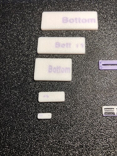

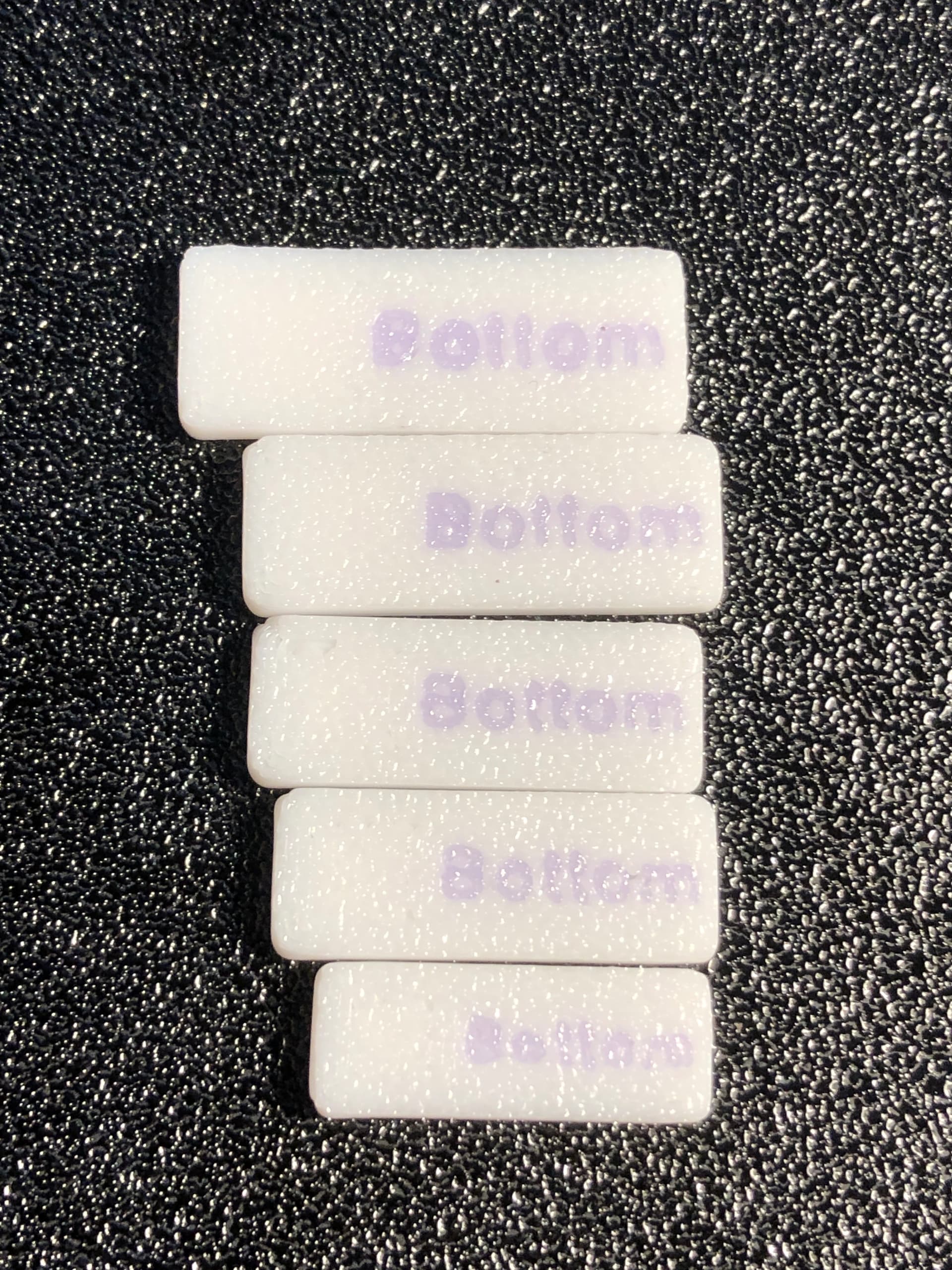

For bottom text
Slicer view (Arachne)
Actual results - not sure what went wrong with 4mm - but looks like 3mm ok, 2mm not
I suspect results will be similar with text created using Bambo Slicer.
So in conclusion 3mm or maybe 2.5mm is possible with Arachne on horizontal text with a 0.4mm nozzle - and no special slowing down.

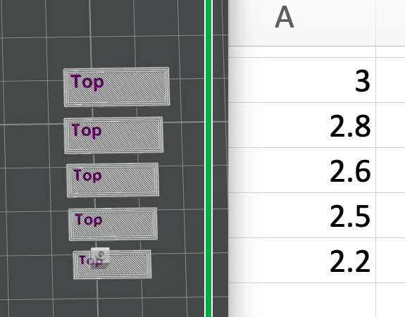

Further testing on Arachne - to try to find the text size break point between 2mm and 3mm for horizontal text on the top and bottom
Slicer
Screenshot 2023-02-11 at 16.57.56
Top Text. - 2.8 works, 2.6 doesn’t
Bottom text - 2.6 works, 2.5 marginal
PS/ I suppose for a definitive test I should have used the same text on the top and bottom as it may be that the letter ‘p’ for example is more tricky.
