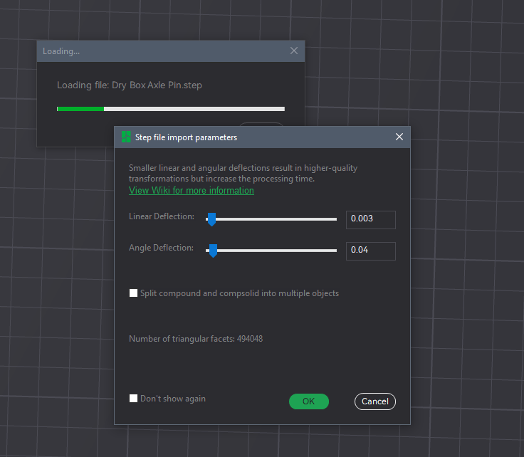

I’m not sure what you mean by tolerances, though you’re right of course that STEP is going to be the truest representation of the original model. But what do you think the slicer does with that when you import it? It turns it into a mesh, then stores that mesh, in 3MF format. The original STEP file isn’t preserved anywhere. The mesh accuracy/detail is determined at the time of import. Which is the same as when you export a mesh format from the authoring software in the first place (except it has to be done/repeated with the exact same settings every time it is imported into the slicer).
From my POV there is more control when creating a mesh from a “real” CAD/CAM program (or even a dedicated converter program) than the 2 sliders available in Studio.
Fusion:
vs. Studio:
That’s also the case with STL, and to a large part 3MF (seems very widely supported these days). I’d argue that from a consistency standpoint, using the same exact mesh, generated by the original design software, would be more consistent than relying on any particular slicer’s meshing implementation or settings used during import/conversion.
What I don’t know is if any slicer works from original STEP files, w/out converting to mesh first, in which case using STEP may indeed have some advantages. But I know Studio and all the other Slic3r derivatives do not.

PS. I didn’t realize it before, but my screenshots show an interesting, I think, point. The model doesn’t really need 500K (!) triangles to be accurate (like in the Studio import dialog), but I really have no way to determine that since there’s no preview. (Are those even counting the same thing?) So I’m likely to make it more complicated than it needs to be, which will slow down every plate slice. OTOH in Fusion I can see that 11K trangles is plenty. I know there’s some way to show a wireframe in Studio, but I can never find it… something with boolean operations I think.

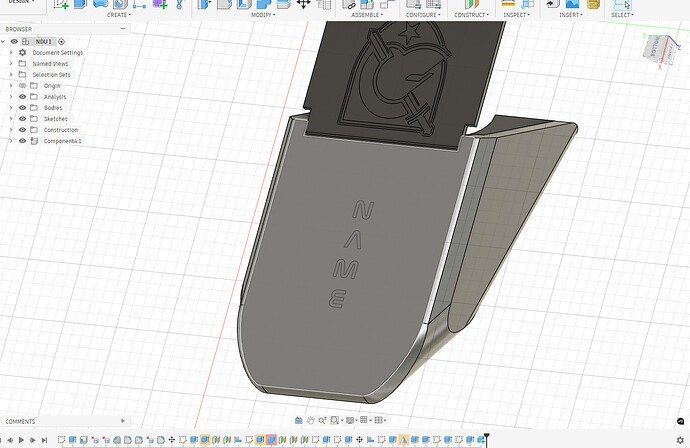

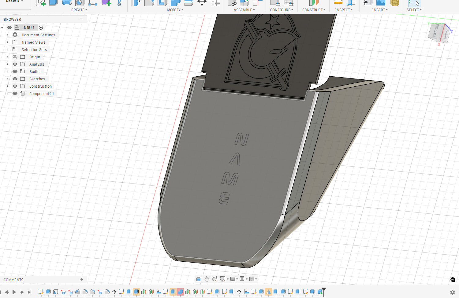

I apologize for the lack of information on my end. Let me help you out a little. Attached
is an image of what I am trying to export. Everything in it is bodies. Somewhere along the way, Fusion or Bambu has an issue processing or exporting the design correctly.

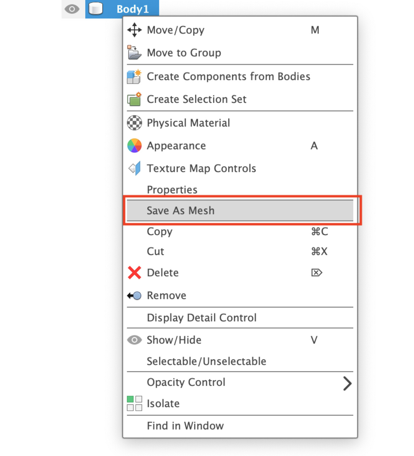

IMHO “Save as mesh” is quicker and simpler than exporting. In many tutorials this is how people recommend exporting for 3D printing. With Autodesk’s own “3D Print Tools” extension that is available in their marketplace, “save as mesh” is right on the toolbar. And at first there’s not much to understand besides “high, medium, low” and the nice preview that tool can give you (unlike export, IIRC).
To each their own of course, but I know it can get confusing when one source recommends one thing and another something else. There’s no reason “save to mesh” shouldn’t work for export. The real issue is elsewhere.

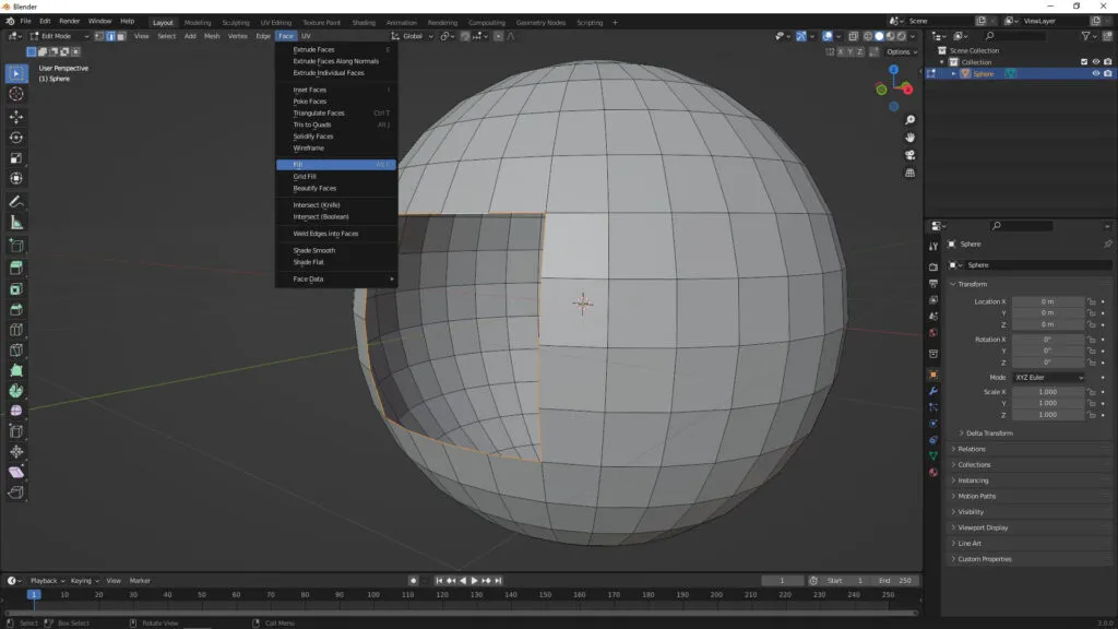

A mesh file, on the other hand, as the name suggests, is a net and therefore hollow. Nothing inside. Therefore, mesh files must also be mainfolded in order to be understood by the printer.
This is what each mesh looks like from the inside: Hollow
In theory, a CAD object can also be infinitely spherical, whereas a MESH is limited to tiny surfaces:
You also have to understand this: Solid bodies are used for 3D printing. Mesh is used for Blender, for example, because you work with hollow objects there. Even though Bambu understands Mesh, of course the program has to, there are fundamental differences.
So, to clarify once again:
Mesh = Hollow
CAD = Solid
- (Hence the company name: SolidWorks)
That’s why there are always problems when inexperienced users want to cut a mesh, for example. Why? What happens when you cut something hollow, like a sphere? You end up with two open shells or bowls instead of two half closed spheres. Unless you manifold.
