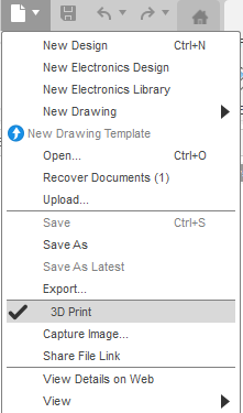

Hey MZip. Where exactly in Fusion is that 3D Print Export feature. I can’t seem to find it. I ran into the excessive facets on stl’s on a large print.
Select File>3D Print.
Then select Export in the new menu that pops up and open the refinement settings portion:
Thank you. That did it. I just didn’t see that 3D Print choice on the main menu. I kept digging in the manufacturing menus. It’s funny, my work around was to use the step files like you mentioned. But that has been erratic for whatever reason. I only ran into this with a really large print. My friend has to print a full size WW1 aircraft engine for a museum.
