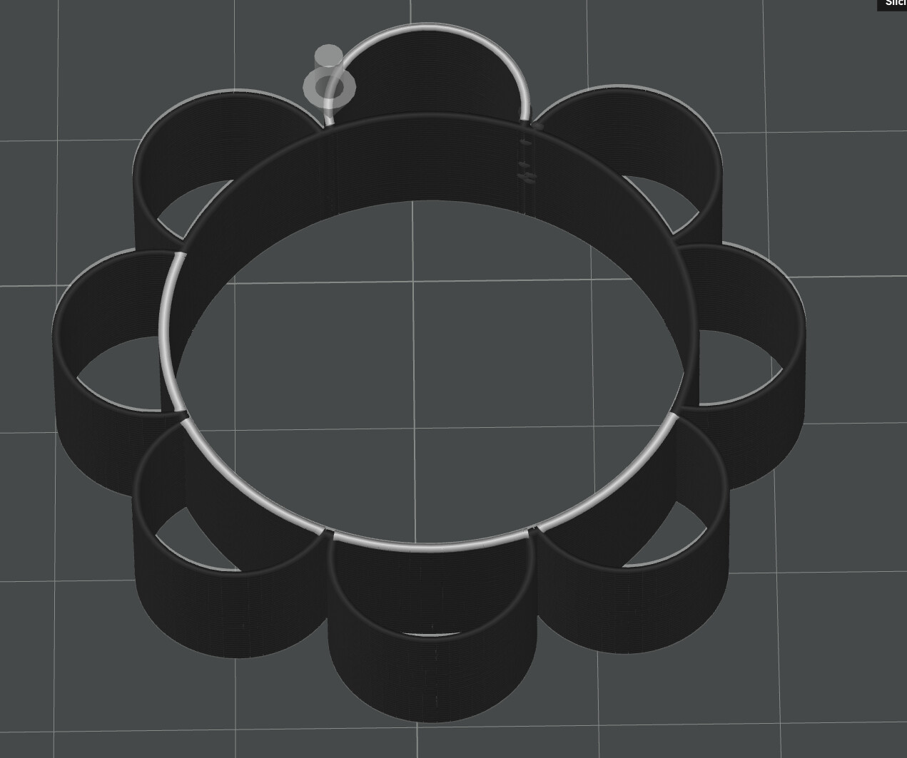

Here is what it looks like sliced. Wall Generator was set to Classic.

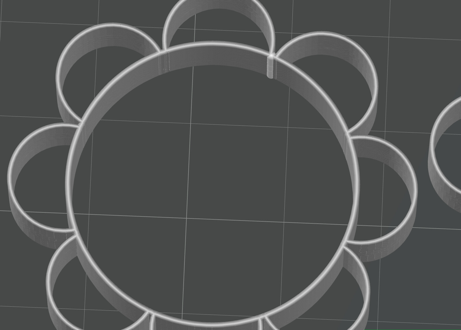

This is with Arachne:
Tried printing again. Seems to be something in the way it is printing. Possibly the STL is not great, or the way the slicer is making the g-code. It does the complete outer part in a single continuous pass, but the inner ring it breaks up into 4 individual segments, not a continuous pass.
Tried messing with a few settings with no luck. Here is what the G-Code kinda looks like before it starts doing the outer part. The outer part is done in one pass, without lifting the nozzle, but the inner ring is being connected with small segments.

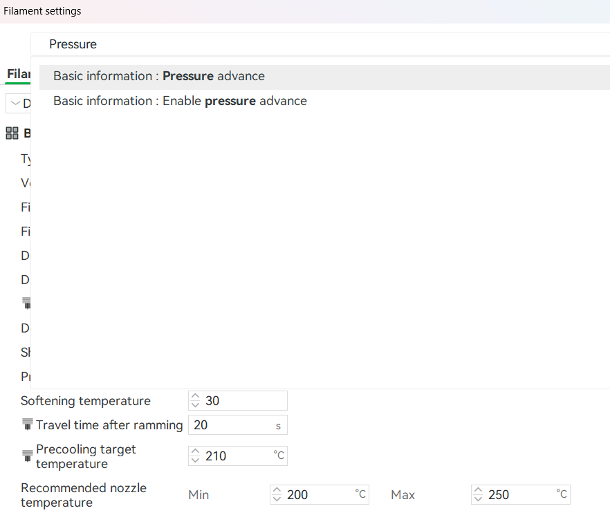

Please calibrate Filament Flow Dynamic ( or Pressure Advance) Very important for TPU printing. My PA value for 95A TPU is K=0.158, it is a ballpark figure to use as a starting point.
This would suggest you may need to run a PA test and get a good value because there is no room for variance in the wall thickness.
For Generic TPU, I couldn’t find where to set the K Factor.

Not sure I would use the author’s setting directly, but you set the K factor by running the calibration (recommended, run the automatic calibration), or through the manual calibration. I believe you can also use the JSON profile and edit the profile directly from the JSON file, but never tried that.

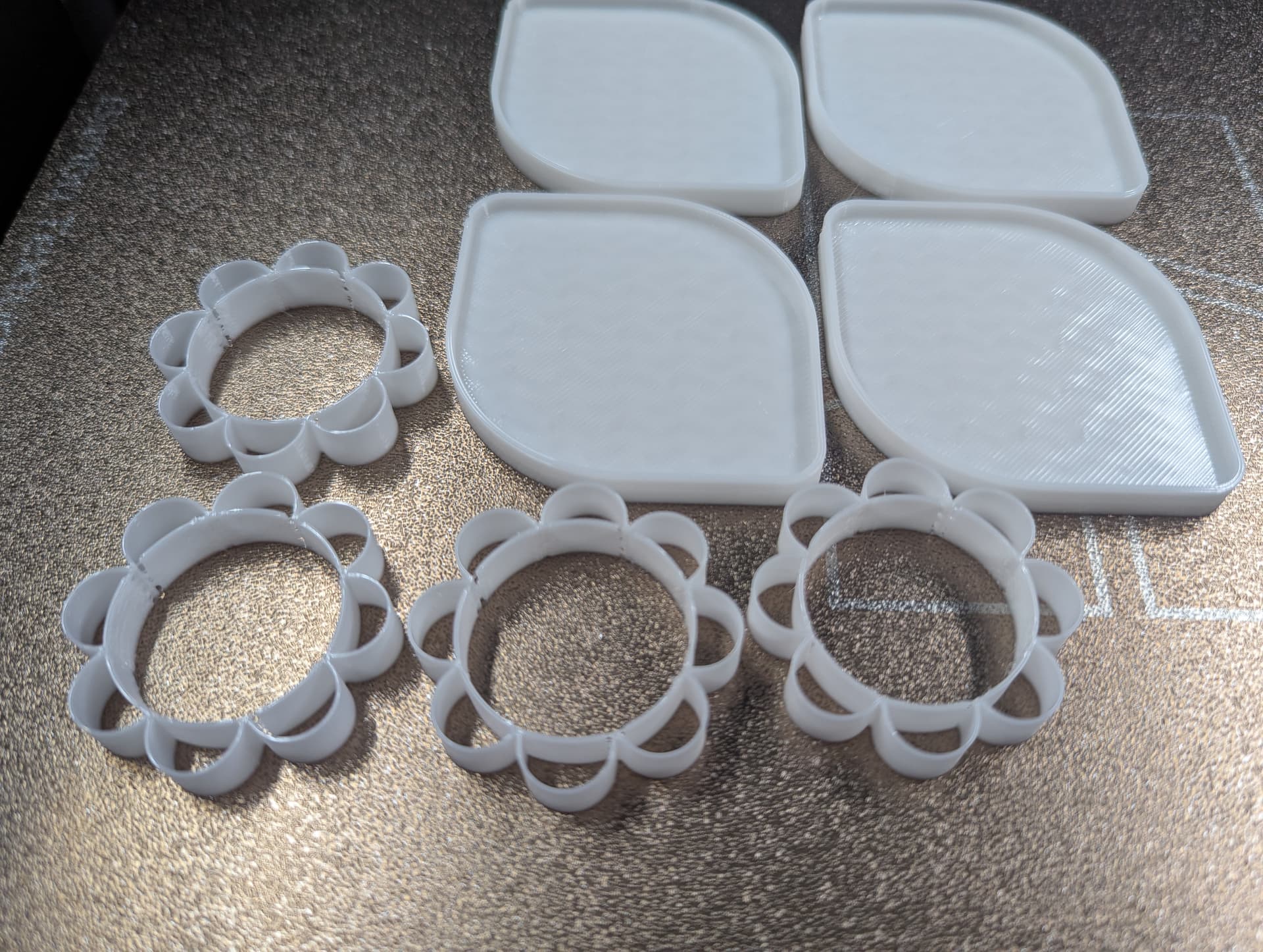

So I just tried adding the STL, rather than using the 3MF file from the repo, and the slicer behaves differently. It does a complete inner circle first, then does the petals. Going to try this again.
Edit: Printing way better already. Issue appears to be the 3MF and Slicer are not getting along.
