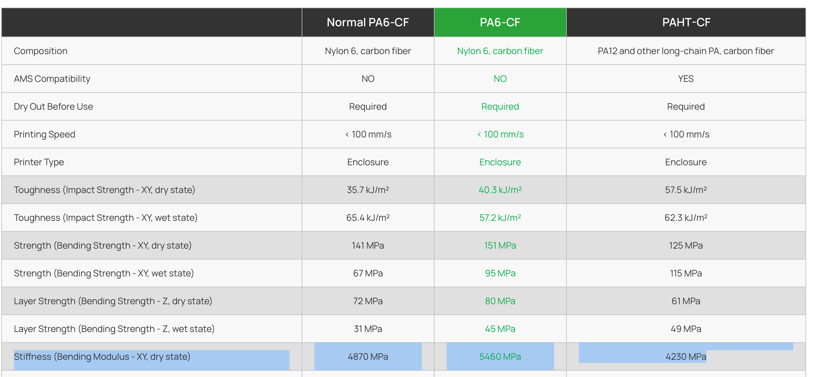

Just noticed this text on the PA6-CF store page but what makes PA6-CF incompatible with an AMS? The PA6-GF is compatible.
Is it the abrasiveness of the carbon fiber and the fiberglass is less abrasive?
I personally would just accept excessive wear on the nozzle as an incurred cost of printing with CF.
Usually it’s just due to stiffness, which also applies to the raw filament. Feeding through AMS is a much longer feed path compared to external mounted so it’s more frictions, especially towards the end of spool.
PA6-GF is much less stiff, just like PAHT-CF (PA12), these two are compatible.
