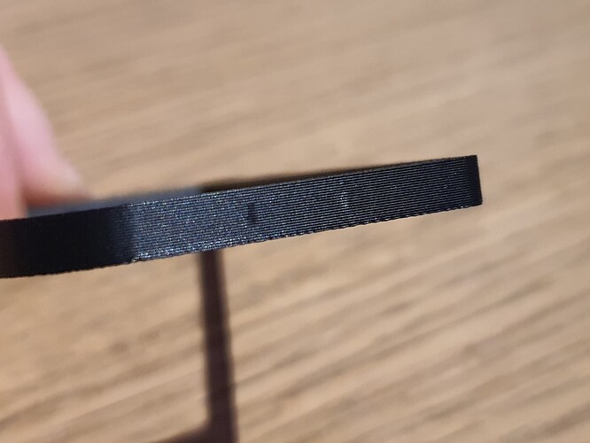

I have an issue that’s been bothering me. When I print a wall with a recess on one side for a latch, the opposite side, which should be perfectly smooth and flat, shows an imprint or reflection of that recess. I’m not exactly sure what’s causing this. From the front, as shown in the photo, all the layers look fine, but when viewed from above under the right lighting, you can see that the layers don’t align as evenly as they should.
I’ve tried printing this with different filaments and settings, but it didn’t make any difference. I’m attaching some photos and the print file below. If anyone could try printing it themselves to see if they encounter the same issue, I’d really appreciate it. Has anyone experienced something similar and knows how to fix it?
Printer P1S.
Test.3mf (1,5 MB)

The cause you’re seeing is the interior filament shrinking at a rate different from the surrounding walls because there is a difference in material thickness.
Your model is only 4 walls thick and 3 layers where this feature appears. You appear to expect the single outer layer to not be influenced by the one behind it. That simply won’t work.
The only thing you can try in order to diminish it–but not get it to disappear altogether–is to change the wall sequence from the default of inner/outer to outer/inner. This will give the outer wall a chance to firm up first.
Also, slowing down the outer wall speed may help but I doubt it will eliminate this.
Alternatively, you can design the model to have thicker walls.

I understand that, but I was changing the wall settings. I changed the line thickness, set the type to Arachne, and it didn’t help. I understand that this is probably a limitation of the printer with such a thin wall.
However, I now have a question about the second issue, where the layers don’t seem to align evenly. I mean, from the front, the layers look fine, but when you look at them from an angle or slightly from above, you can see that they are uneven. What could be the cause of this? Is it due to printing too quickly, or could it be that the belt is too loose?
I don’t know if I can concur. You may be expecting too much of the technology. True, from your posted photos, if one really wants to take a closer look, yes, you might say it’s imperfect. But from another angle, I think this is really a great print and I would be happy if it came off my printer.
