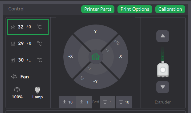

Also, how do I “heat up the hotend” to soften the plastic.
All I know how to do is click print in the bambu studio.
Use the display on the printer to set the nozzle temperature.
Or via Bambu Studio
If you remove the glass lid you can carefully turn the printer upside down and rest it on a table. The printer will function for the post part inverted. You can heat up the nozzle and this will allow you to hopefully clear the blob easier.

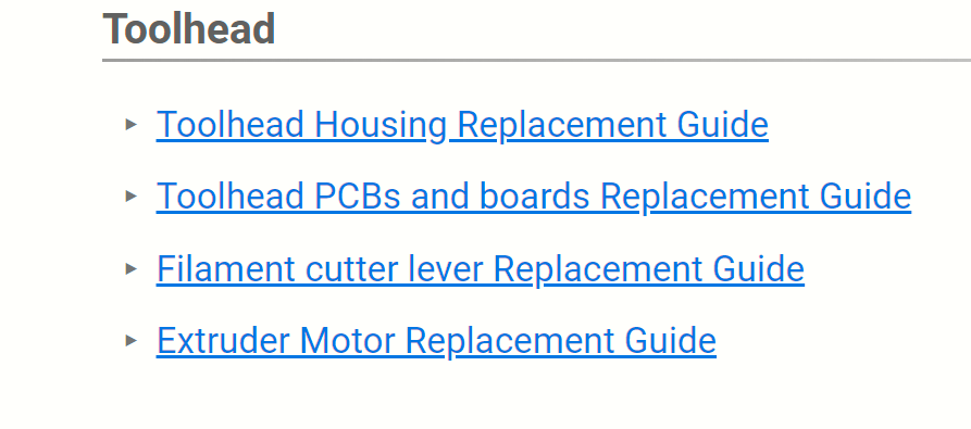

There is a step by step wiki article for this.
I’m following the linked wiki article but nothing happens when I set the nozzle to heat using the control panel (the first number stays stuck at 0)
In your photo you have the speed selected, I assume that is unrelated to your attempt.
  • Use that screen, select the first entry (showing 0/270 in your photo).
  • Press the central select button
  • You now see the value screen
  • Use the control directions to increase the value
  • When you have the value you want, press the central select button
  • The printer should now heat up the nozzle
  • You can use the back option to go back a few stages
If the nozzle won’t heat up, it’s likely that the blob severed the heater/thermometer’s wire[s]. You’ll have a harder time cleaning this out, and definitely have 1 part to replace :wink:
