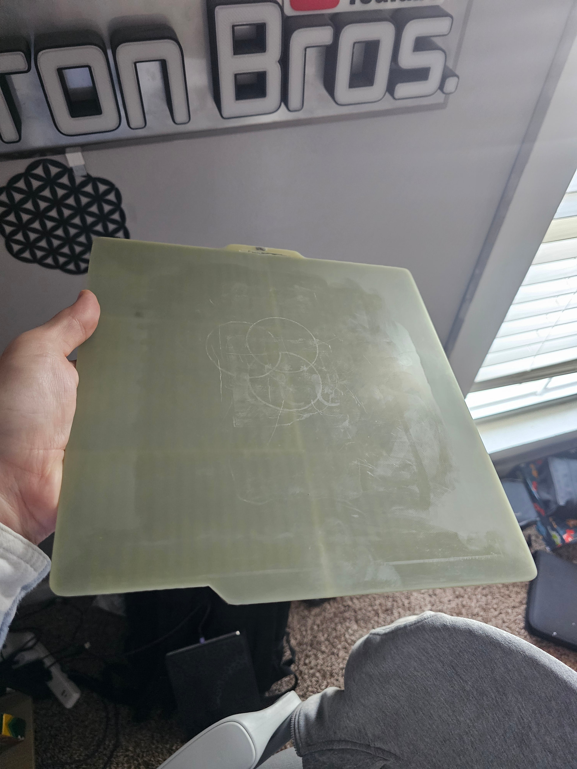

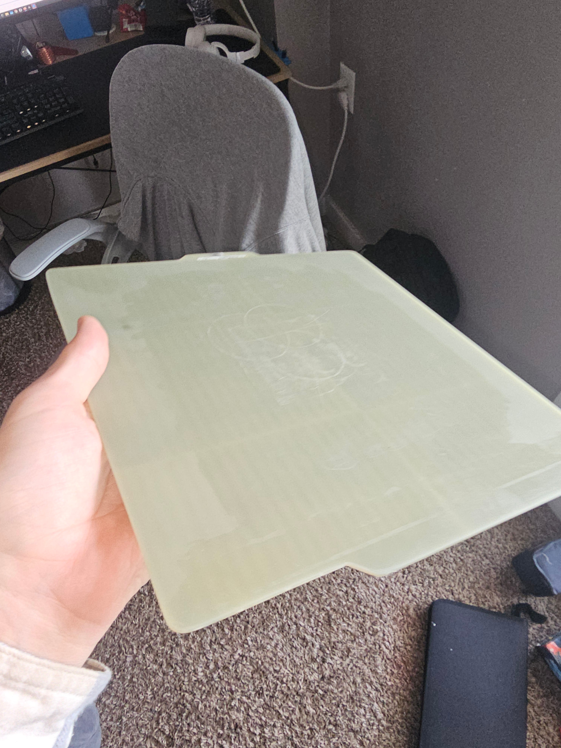

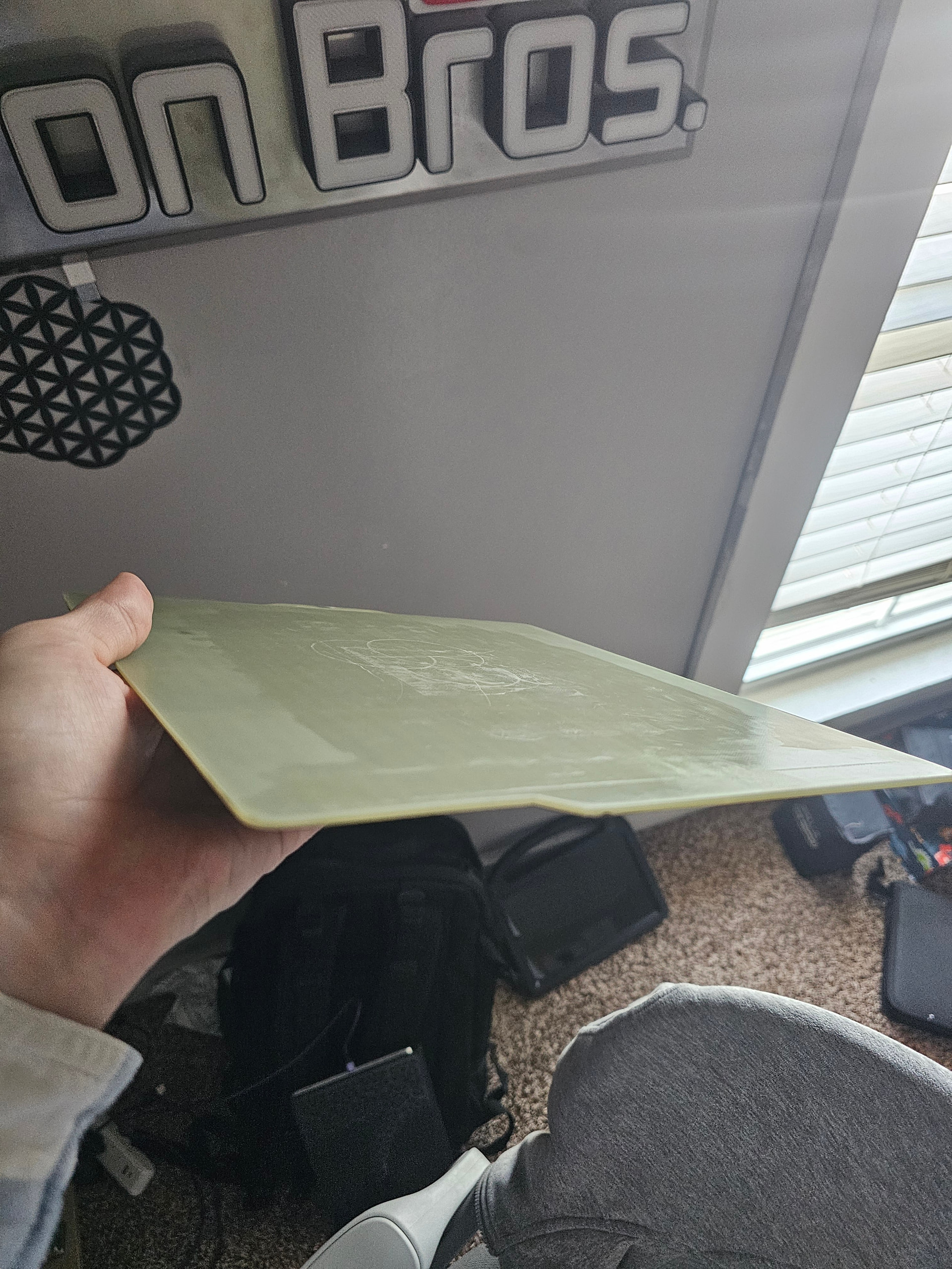

I made a custom bed out of G10 aka garolite material. Its an extremely un-bendable material its about 5mm thick and nothing bends its including cf-nylon. Its a bit of an effort, order it from mcmaster carr, then cut it out with a jig saw, bond a sheet of metal to the bottom. But it a beautiful material for a bed to be, you can but thin ones and they have incredible reviews
