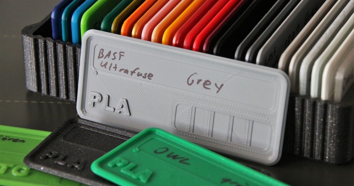

I am thinking these filament swatches might be good:

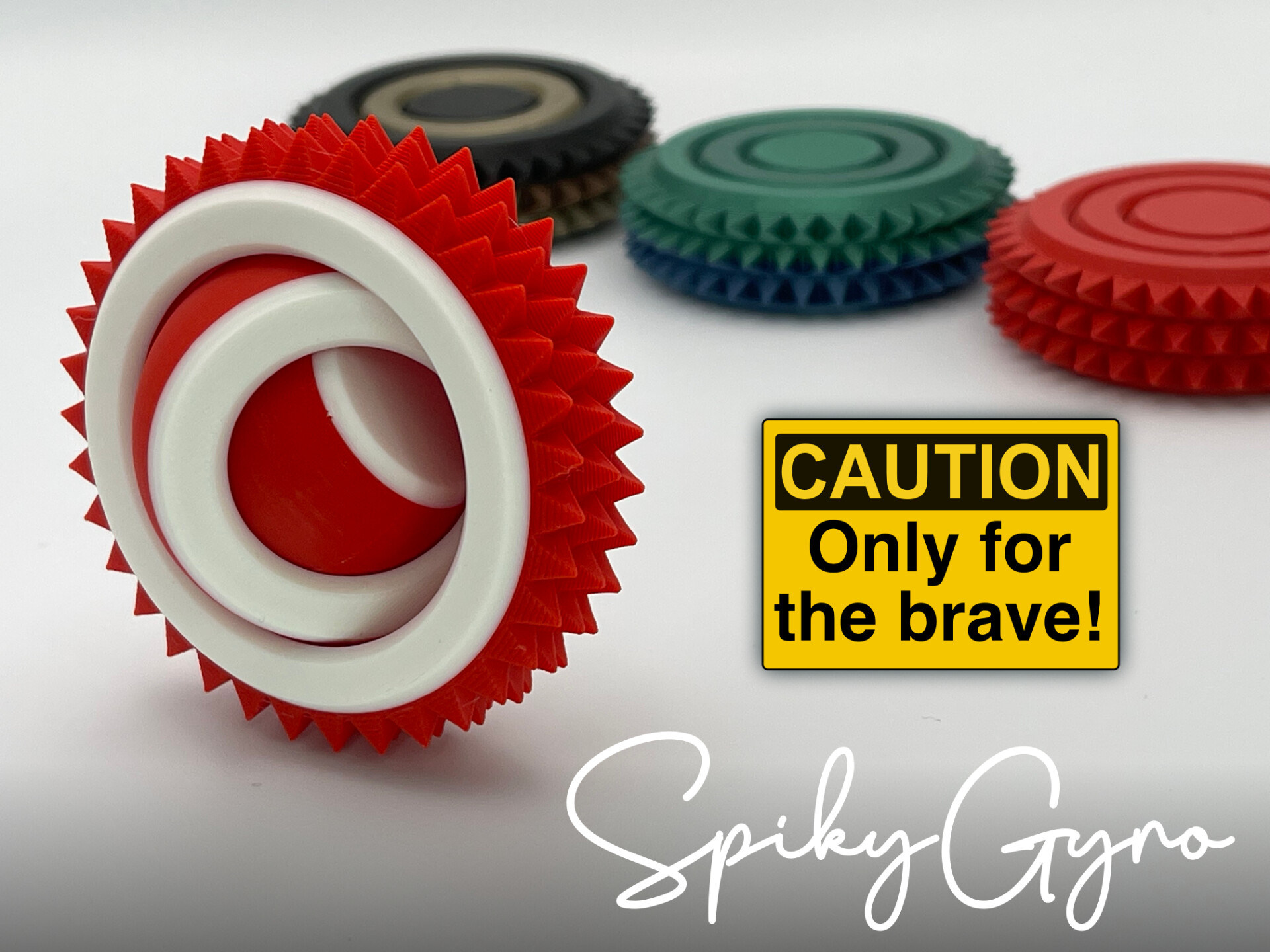

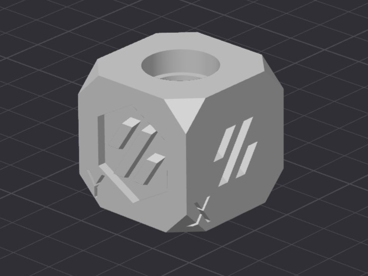

The Voron cube is a classic. There is a Bambu version too if you prefer.
If you want a stress test with a model at the end of it.
Those spikes are designed to work on the very edge of bridging capability.
You also end up with a Fidget Gyro for your time and effort if everything works.
Granted, not your typical test model, but, you asked for something that wasn’t typical.
