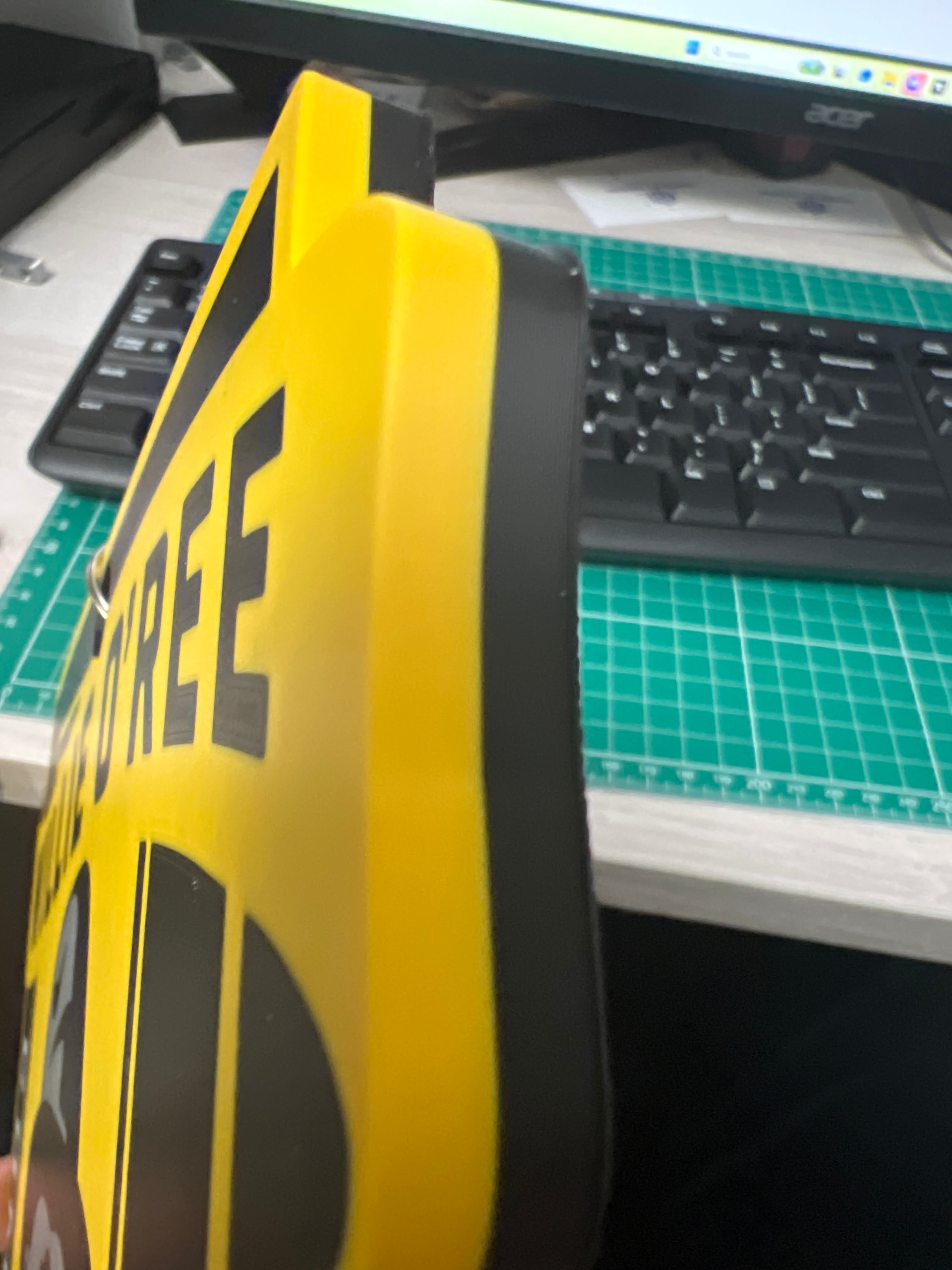

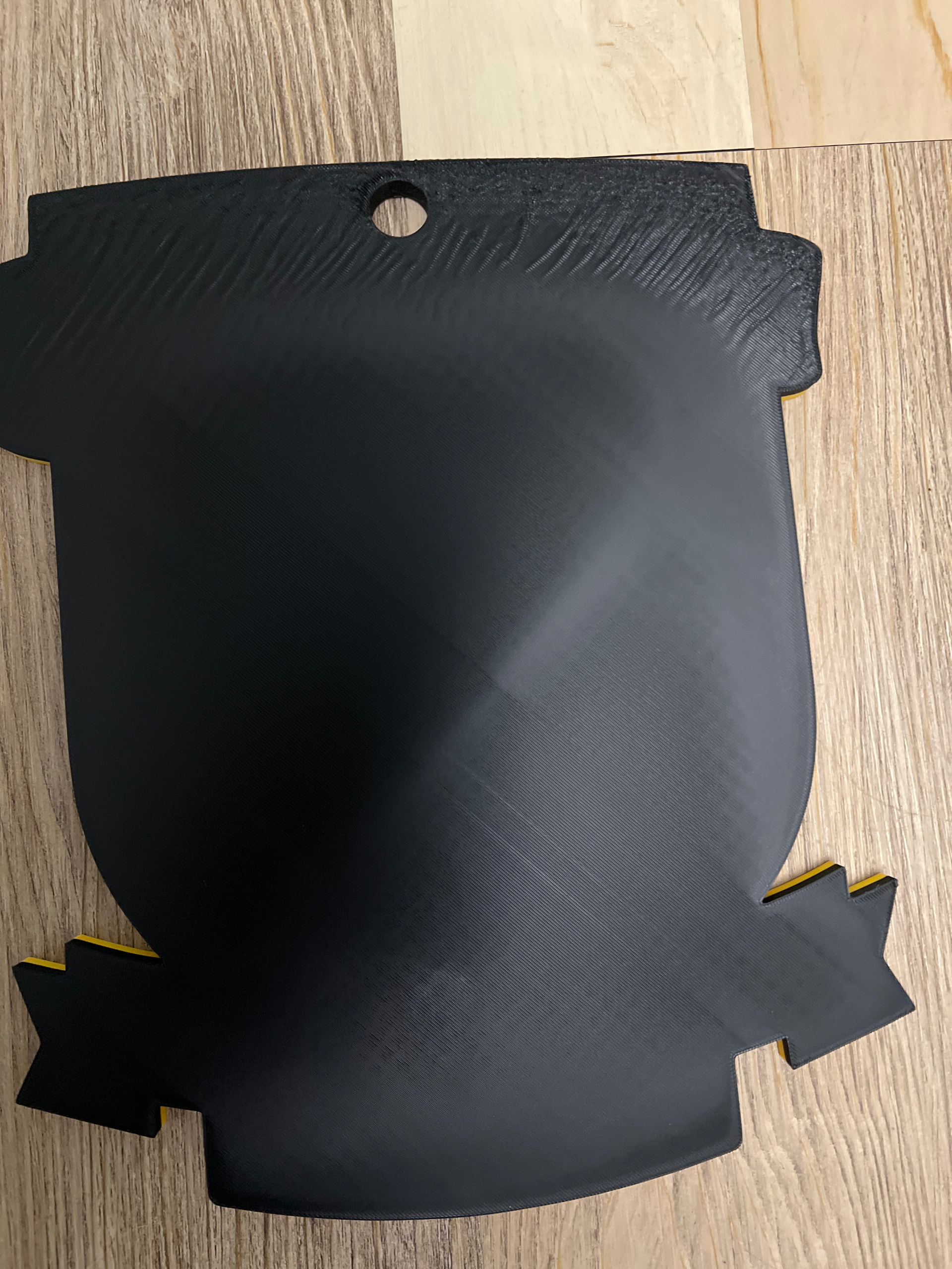

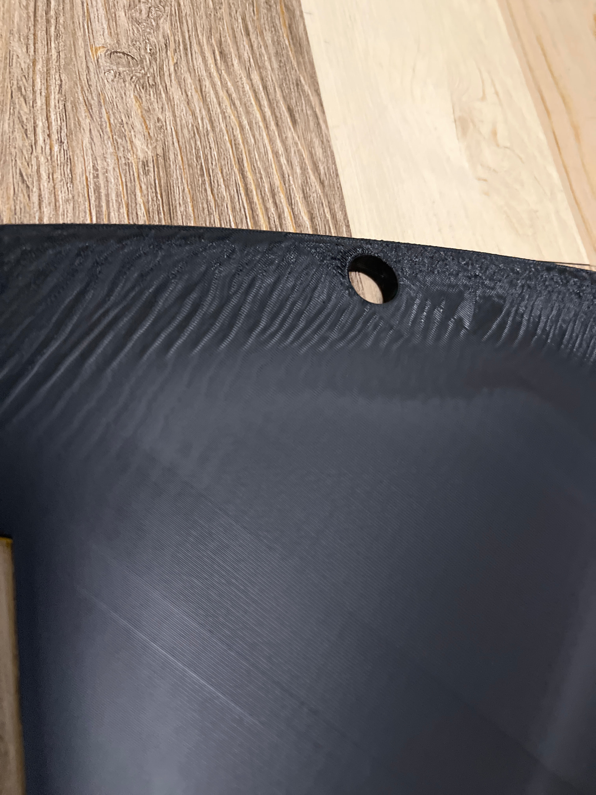

So like I just printed this on my h2d with bambu black pla and no ironing I’m just confused with this is as this is the top of my print and that’s the only spot it happened does anyone know what it is
is there any chance there are not enough top perimeters to cover the infill smoothly?
What do you mean by that if you mean the size of it. It is the size of the h2d bed
I believe he’s referring to top layers, how many top layers are you printing? It would be great if you can upload your .3mf file. It could answer a lot of questions for those able to help you.
Probably has to do with the 1st layer losing layer adhesion there and transferring it all the way to the top of your print.
I bet you can see evidence of the same issue by looking at the bottom side of your print in the same spots it s happening on top.
Well i have lost said original file as it was a one time print so I did not save it but all the settings are default but I turned off ironing
Yeah. That makes sense.
So the bottom looks nice and uniform, no deformities or weird lines there flipping it upside down?
Maybe needs a brim or something. Hmm
Well it’s just werid as it only happens on the top of my print in the back section of my bed so it may be a printer issue
