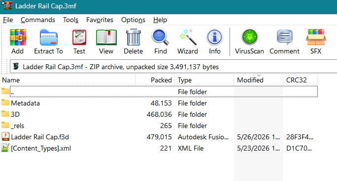

FWIW, a .3mf is already a zip archive, and you can add any file you want using your favorite zip utility. I keep local copies of my Fusion designs by opening the associated project file with WinRar and adding the .f3d file. I add a note (Others>Notes) in the Process profile as a reminder that the Fusion file is included in the .3mf.
This keeps related files together in local storage, but I do not know if MakerWorld checks the contents of a .3mf for “extra” files.

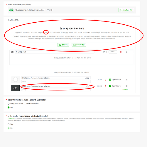

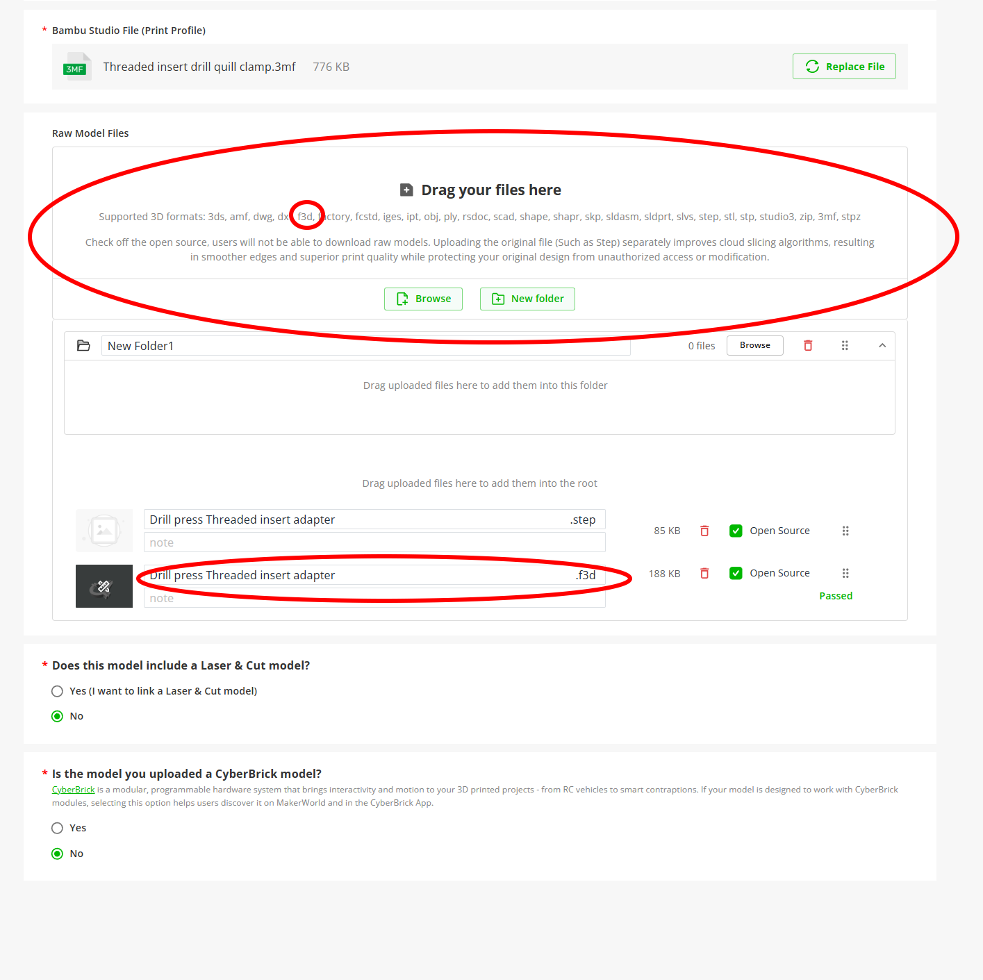

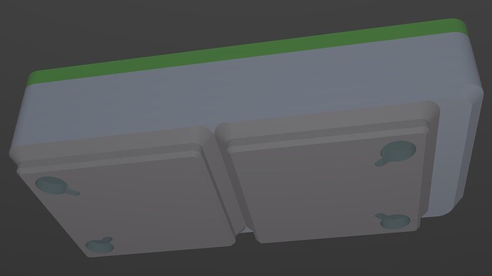

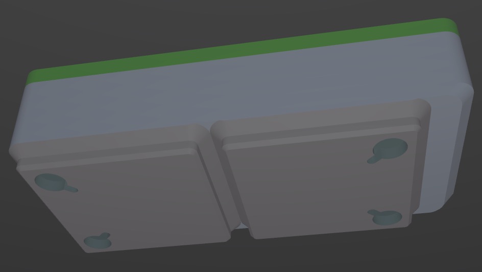

Before I tried explaining my idea, I tried adding the .f3d file to a .3mf for Makerworld, and it was rejected. BUT, I also found that Makerworld lets you add an .f3d file directly as a raw model:
So that should provide a way to distribute the Fusion design file.
You might also take a look at the organization of the Fusion file I use for Gridfinity. It includes many designs in a single file, and in Fusion you can turn on/off the features you want in your model.

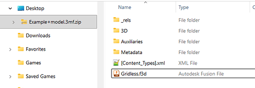

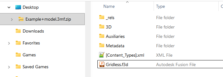

Your .3mf project file is already a collection of files combined into a .zip file, but with a different extension. You can see this by opening the .3mf in a zip file utility. Or, in Windows, add .zip to the file name: Project.3mf→ Project.3mf.zip. With the .zip file extension, Windows treats it as a folder, and File Explorer shows the project contents:
You can copy or drag a Fusion f3d file or any other files into that “folder”:
If you then rename the .3mf to remove the .zip extension, the slicer will ignore any “extra” files that you have added. Apparently, Makerworld checks uploaded .3mf files and rejects any that have been altered, but this does work for local storage and for .3mf files uploaded here on the forum.

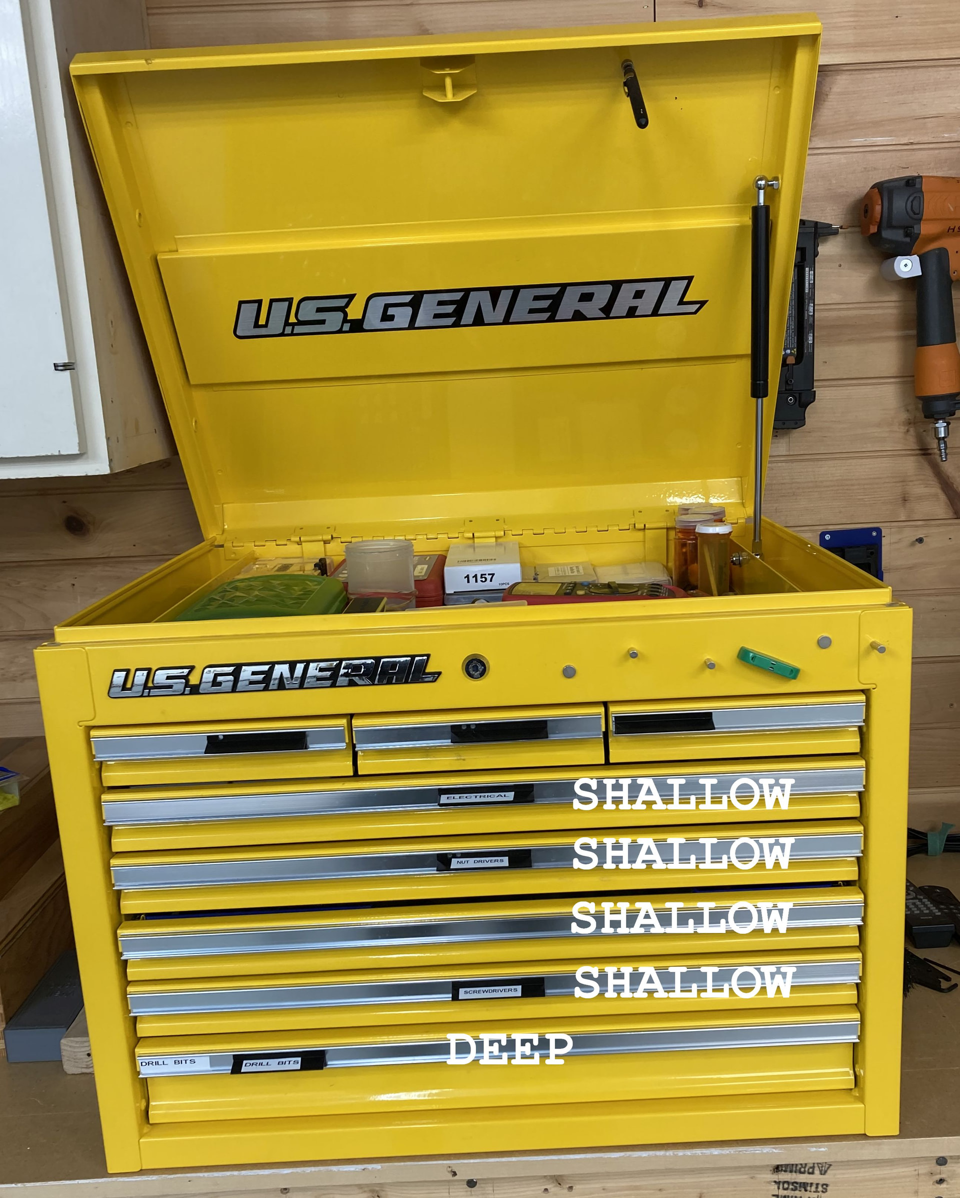

Thanks for taking a look. As to the issue or someone having 1/2” left over– they shouldn’t if they use GridLessFinity because it covers 100% as long as they use the right files. And the files available at this moment are for the three shallow drawers of this box. Hopefully, I’ll have the files for the deep drawer uploaded in the next half hour.
Got it. I guess I was referring to someone who had an off brand and the drawers were not the exact size and couldn’t design an exact fit.
Right. I’m hoping that people will send me dimensions for other brands like Snap-On, Craftsman, whatever. Then I can upload files for them too. The goal is to serve the CADless 3D printer, but… if one knows CAD and would rather just download some files already designed for their particular tool chest, well, it’s there for them too.
At the current time, I feel that GLF is confusing and I don’t know how to fix it. And that will keep it in the shadows. Just the same, I’ll keep at it for a while until I get discouraged. Going to go now and upload the files for the deep drawer. Not sure whether it should be a separate MW project or an add on to the one focusing on the shallow drawers.
The first post on Gridless finity was for the shallow drawers for the Harbor Freight U.S. General top tool chest. This one:
Go there now if you to get the files for the deep drawers as promised. I would also appreciate your dimensions for a drawer from Snap-on, or Craftsman, or Kobalt, or whatever you have.
CORRECTION: I was hoping to make a subfolder in the existing post. Couldn’t figure out any way to do it. So, I’m making a second stand-alone post for the deep drawer.

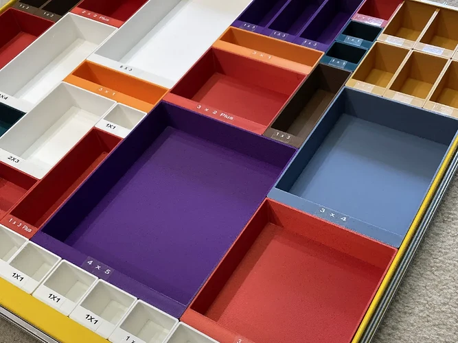

I’m sorry but I’m so dense and obviously missing something. I don’t see the difference between GridLessFinity and many of the parametric Gridfinity models that allow flat base(girdles) and partial gridfinity units or exact mm sizing.
I’ve been organizing 5 large tool chests over the past year using Gridfinity and I able to generate Gridfinity cups to the exact mm with flat bases(gridless), labels, magnets(if needed). The parametric Gridfinity modeler I use also allows a combination of Gridfinity base and flat base where partial gridfinity grids(spacer, filler) is used.
Thanks. I wondered how long it would be before someone told me that my system was useless. I have a lot of self-doubt and I wondered myself if GLF might be a nothing-burger. Looking at your photo, I can see how you have a container hanging over the grid. And that… would take care of any shortcoming that I was trying to fix. Oh well, back to the drawing board. I guess my system does at least do away with the need to print the grid. But, for drawers that aren’t yet fully populated, it would be the grid vs my placeholders. Samey-same.
Thanks again. I value constructive criticism.
