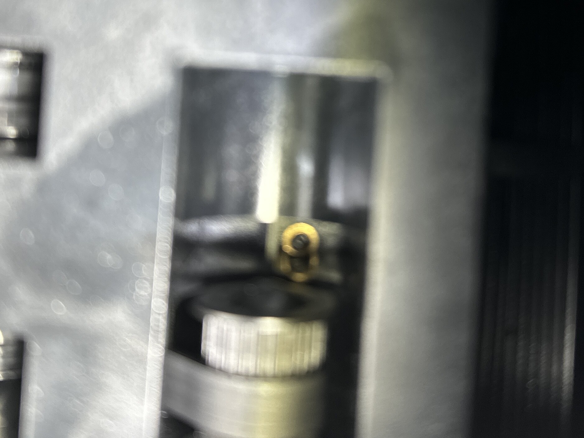

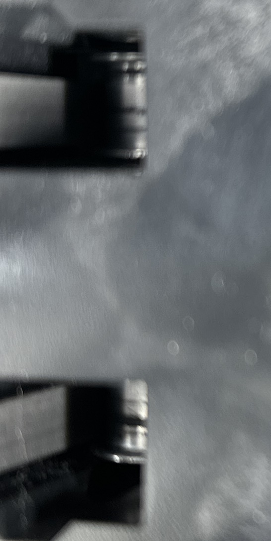

They are not running centered on the pulleys. I can center the ones on the back then others are on the flange. Theses are images of the smooth ones in the back. Noticed the build up.
Your post has got me thinking though. If one of the pulleys is seizing up during operation it would cause this issue? I would need to disassemble the machine remove the belt and check all of the bearings. Has anyone had experience where this was the case. I am new to this and need all the help I can get.
Hmm your photos are definitely not in the winner circle of an in focus competition.
That the belts are not perfectly centered is normal and they will also move up and down during operation however if the belts are riding hard against the sides then that could indicate an underlying problem and the belt could get damaged/delaminated from too much side pressure which in turn could cause snagging.
Build up on the wheels can happen over time and as such is not an immediate concern. Clean the build up and the belts the best you can and if that build-up comes back in a short time then investigate a little deeper.
A systematic approach to troubleshoot your issue will serve you better then to just disassemble everything and throw new parts at it needed or not.

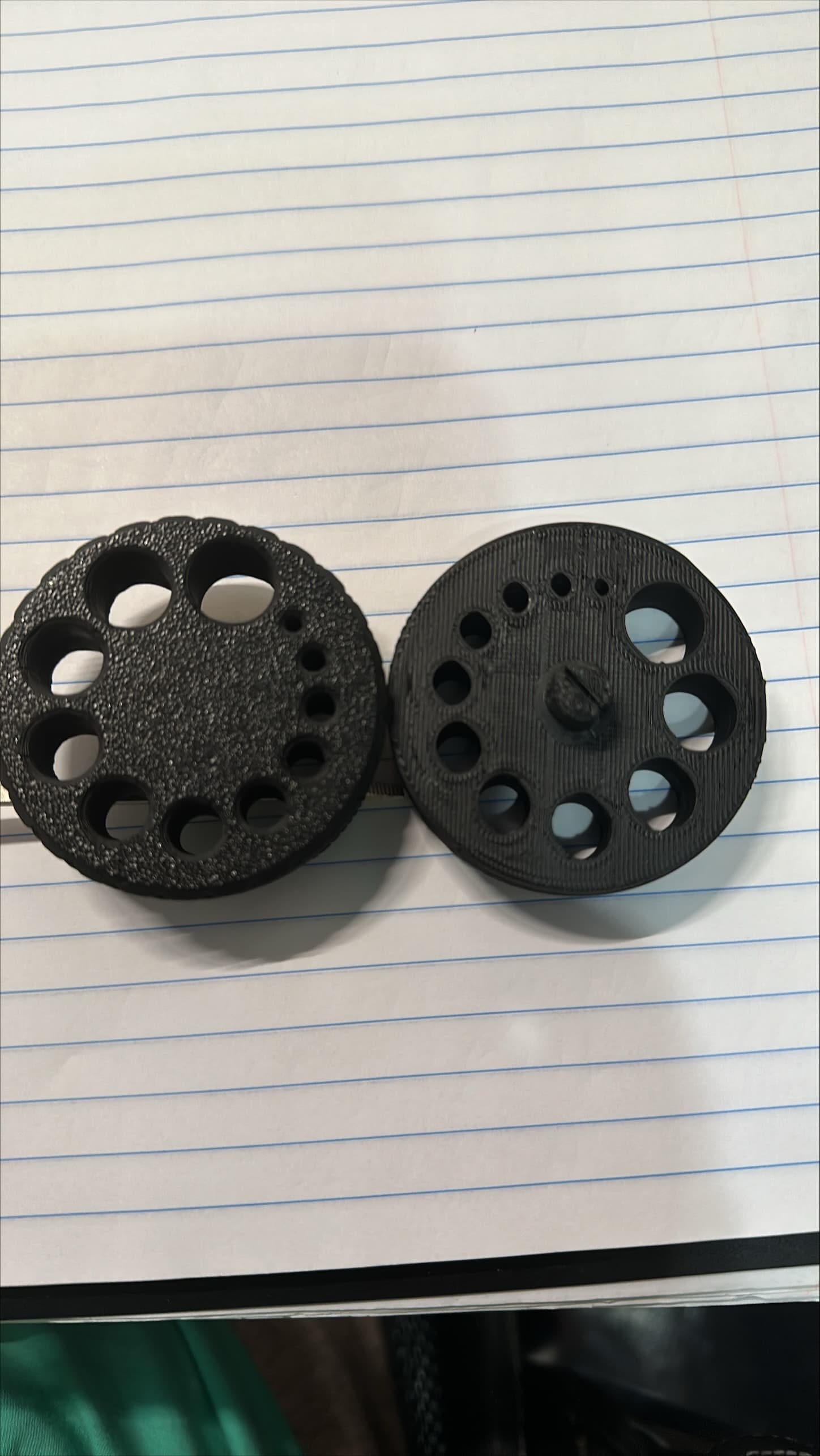

The printer has 532 Hours on it now. Bambu customer service is not helping me so far. I am at my wits end on this. I am including pictures here to show how out of round the circular holes get as the print adds on layers. The left is the bottom of the part and the right is the top. Perhaps someone will recognize this and it will help me solve the bigger problem of the steeper motor loosing step and rehoming.
