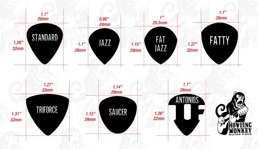

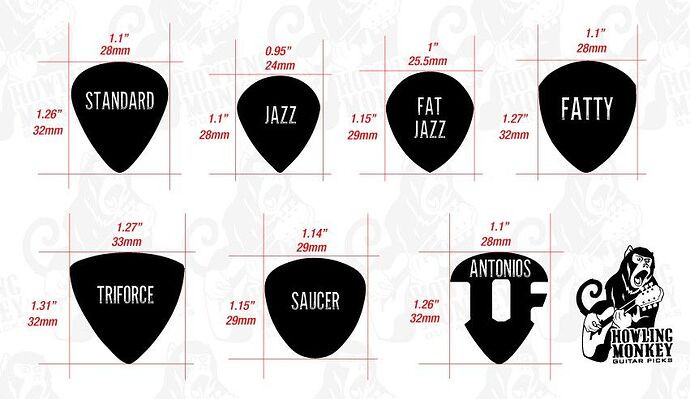

As CarbonForge has already mentioned: Guitarists choose their picks based on strength, and each pick has a different level of flexibility. You can’t replicate that with either 3D printing or laser cutting. The picks, as simple as they may seem, have a specific shape and unique properties.
Because of the FDM process used by 3D printers, this specific flexibility can’t be replicated or controlled at all. As cheap as these picks are, there’s actually quite a bit of expertise behind them. Same problem with laser cutting.
I can’t show them all here, but here’s just a small sample to give you an idea of how precise these things are. In addition, there are various materials.

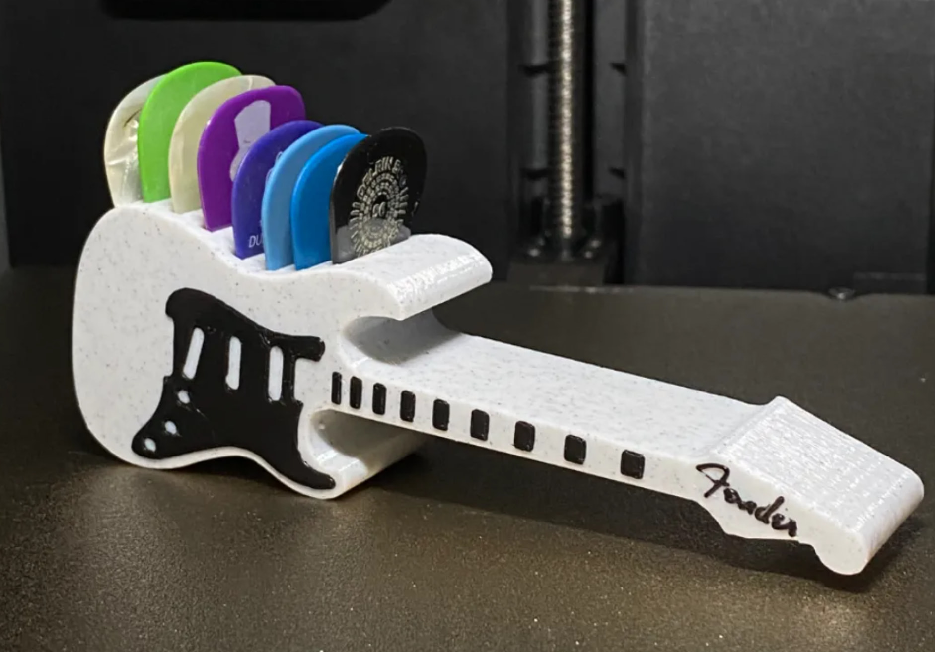

If you want to make your brother happy, just turn the picks into a pendant featuring his favorite band - or make a pick holder:

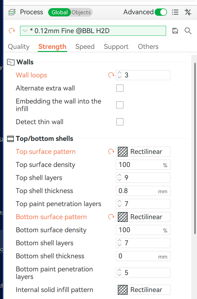

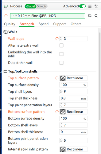

A thickness of 0.5 mm is probably not enough. I tried it with PETG Basic at a thickness of 0.7 mm. That worked quite well. I’ve chosen a layer thickness of 0.12 mm, 3 wall loops and a rectilinear top and bottom surface pattern.
The wear resistance of PETG is, of course, significantly lower than that of nylon, for example. Nevertheless, the pick should remain playable for a reasonable period of time.
