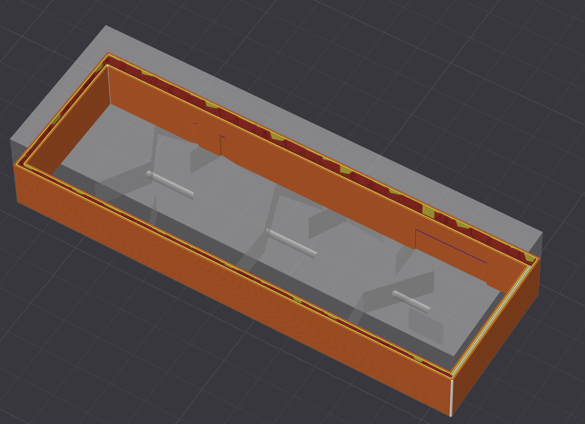

The model I was working on has what I will refer to as a submerged Logo inside the model. Also, the model in all instances is in STL format. If you import the model directly into Studio this logo is not immediately obvious but when you hit the Slice Plate button you will see it momentarily when it is slicing the model.
When you use the slider bar and go through the model layer by layer it does not render. Here is where it gets maybe into guru stuff.
I need to modify that STL model to accommodate a motor so I imported the model into Fusion. Same exact STL file. In fusion you can choose to look at models in different ways. As a solid object (Same as Studio) or as a wireframe. The submerged logo is in the model in Fusion, same as Studio but is more viewable than the momentary view you get in Studio.
I brought the model into Fusion, did a minor edit entirely unrelated to the submerged logo, saved it with the same name and exported it to a different location to avoid the “File already exists” flag.
When I imported the file into Studio and sliced it, the submerged logo does render. Subsequently I imported the original model into fusion and turned around and exported it right back out of Fusion into Studio with the same result.

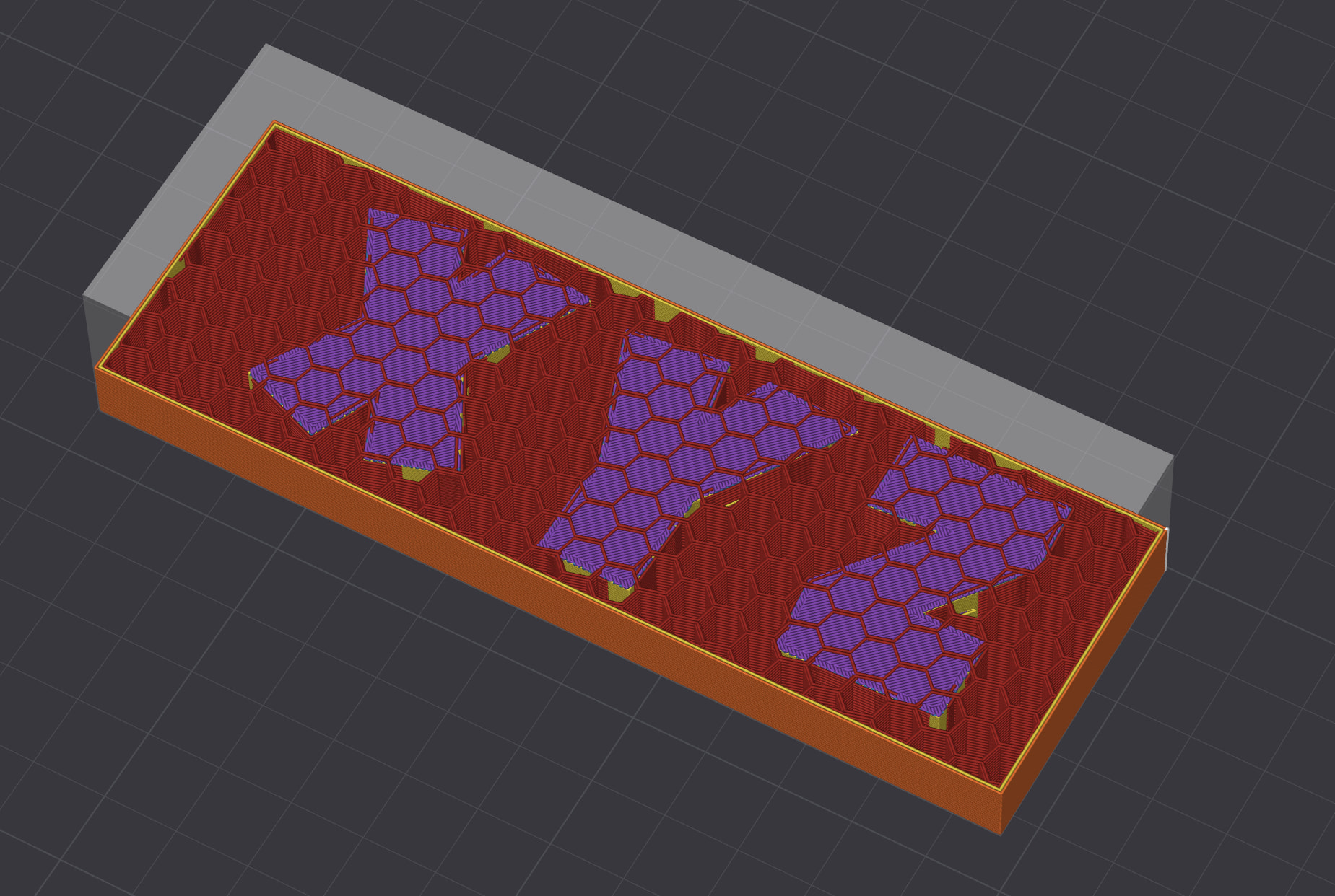

The entire baseplate model is 40 layers thick. The logo starts at Layer 4 (so .8mm above bottom surface) and stops at layer 19 at which time it resumes normal infill pattern. The logo is not flat either. For lack of better terminology it has a baseplate of 5 layers (or 1mm thick) and then text of 10 layers (or 2mm thick).

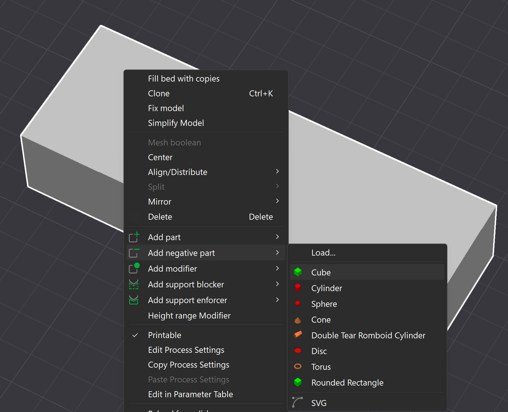

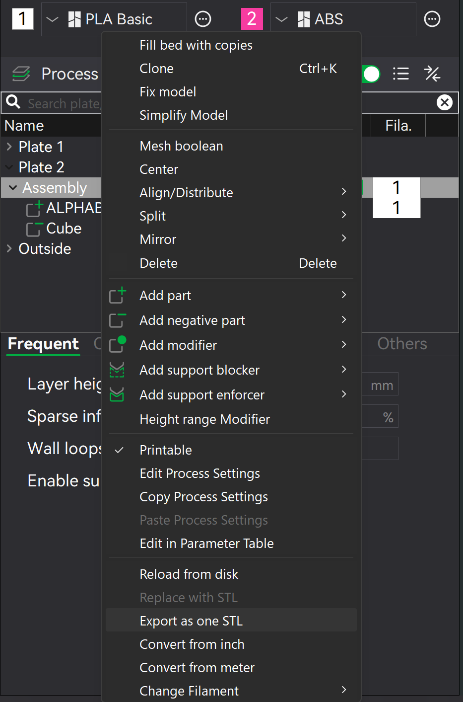

As an alternative, I’ll post a workaround for those who are lazy: Quick and dirty in Bambu Studio
Object with text inside a 3D object:
Add negative cube to the group: Don’t worry - push the negative cube partially under the plate, too - and make a really nice hole. Important: Make sure to pull the negative cube all the way through the plate - it’s better to pull it too far than not far enough, otherwise you might get error messages. It’s also better to set it too high.
Delete that logo; make a big hole!
What you’re getting now is a hole, but that’s just the first step.

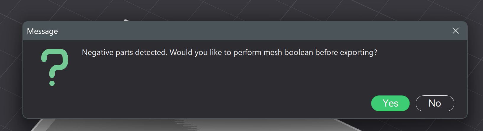

Here’s the trick: export as one stl file:
Important: Confirm the warning by selecting “Yes” to save the STL file with that hole.

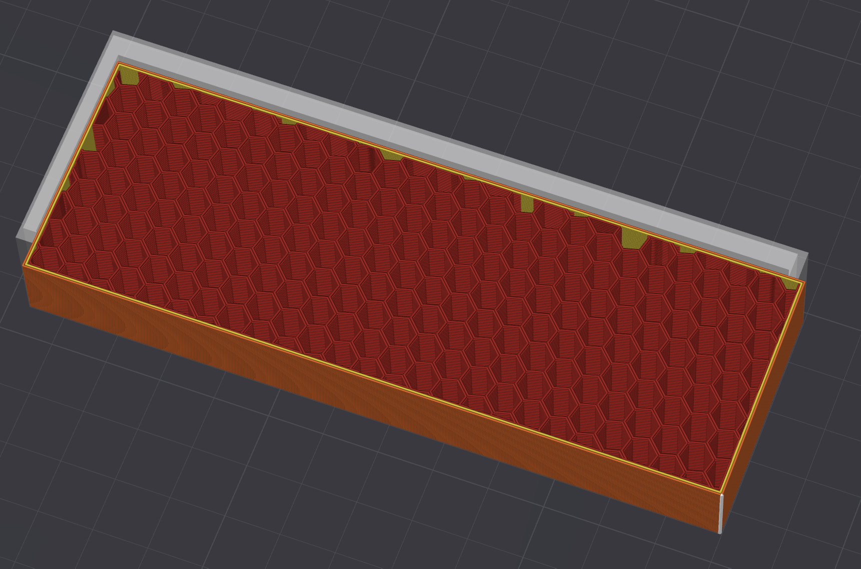

Now you’re going to say, “Wait a minute, now I have a hole!” - Yeah, exactly, and now you do the same thing with a positive / solid cube. Slide it over and inside the hole. Check in the slicer to see if it looks like this:
Then export it again as one STL file:
Problem solved - quick and dirty. However, it doesn’t always work. Bambu isn’t designed for that. Still, it sometimes works for quick removal.
Nevertheless, I also recommend Blender, since that’s the right way to remove something like that that’s embedded inside an mesh object. Unfortunately, most CAD software isn’t designed for mesh operation, and Bambu Studio certainly isn’t.

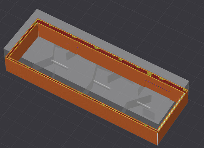

I felt like whoever it was who put that logo in there 1) knew what they were doing and 2) were adept enough to make it hard to delete even if you were able to get at it. I’m curious how just passing the file through Fusion but literally downloaded the file to a folder on my PC, imported into a New Project in Studio, sliced file and the logo was in the file but it did not render the logo when sliced.
Bringing it into Fusion doing convert mesh exporting it back out created the file but allowed the logo to render

In other words, punch a hole through where the hidden logo is, and and then fill in the space. This can also be done in Fusion.
I did a variation on that that also worked. Added a cube primitive with dimensions that covered the logo in its entirety merged the primitive with the baseplate. Once the two parts are merged I used the Mesh Boolean tool and logo was gone. Nice clean slice with no logo.
