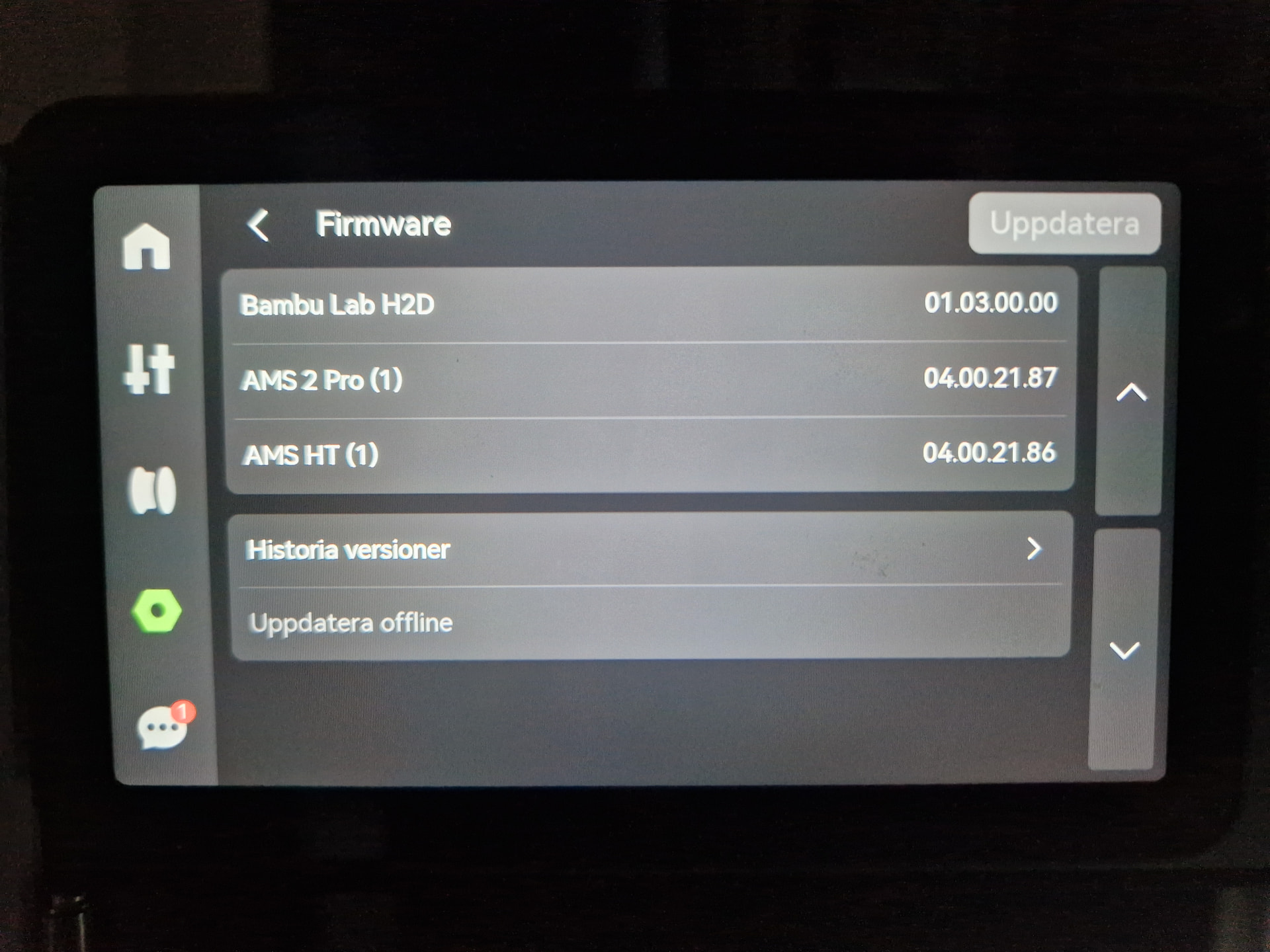

Before suing the H2D I uppgraded the firmware to the latest version. That worked fine. I then added the AMS Pro, and that worked fine too. I then added the AMS HT and then nothing worked anymore.

  1. The first thing that happened was that the printer started to complaining that I use an old version of the firmware for the AMS units. So I investigated to see if there was a newer version to install. As far as I can see, the AMS firmware is bundled with the printer firmware. As I already had the latest version installed for the printer I asked support. The answer I got from them was to install the latest printer firmware. I politely conveyed that I had already done this and that this is the reason I contact them. I asked them to clarify if I there are any separate AMS firware files to be found and if so, could they please provide a link? So far I have gotten, no response, to that.
The printer was still usable despite this message though.

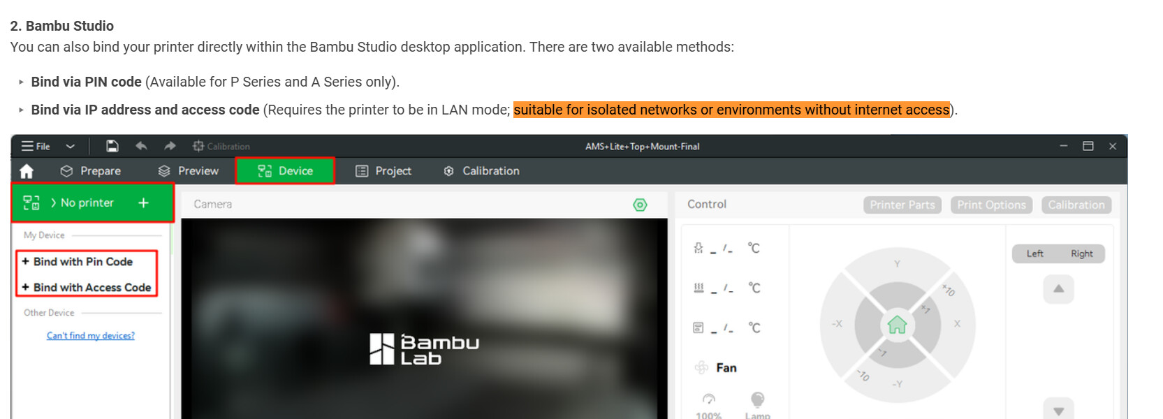

Yes, Bambu H2 printers can be operated entirely offline. There’s a LAN mode in the printer settings menu that you enable. Done. You can also load files directly off a USB stick.

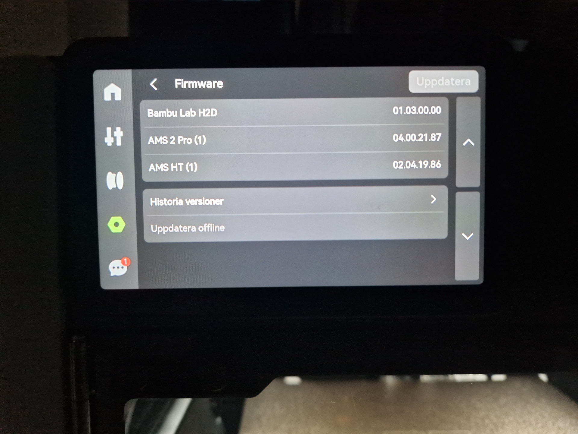

No, the number just changed on the printer (!) when I installed a new version of Bambu studio. I didn’t do anything. When using Bambu studio 2.7.■■ the firmware for the AMS HT was 02.04.■■ even after uppdating the bundled firmware on the H2D to the latest avaialable offical version. I got an error message for this in the printer and I asked BL support how this could be since the latest H2D firmware should include the HT firmware update, and if I could update the HT to the latest version (I still have not got an answer to that)? I then installed Bambu Studio 2.8.■■. When I looked at the printer for the first time after the new install of Bambu studio, the firmware version had changed on the printer. Just like that. I have no idea how that happened, but updating Bambu Studio altered the printer software. As far as I can see, that should not be possible.

About that, I am not sure if that is really possible? I am no expert but to me it seems the printer can be set to LAN-only but I am not sure Bambu Studio actuall can? When I stopped Bambu studio from having internet access it stopped working. But the Wiki does indicate that this should be suitable for off line environments. But I am not sure how if Bambu studio requires internet access? And if Bambu studio requireds internet access, what does it matter that the printer doesn’t have it when Bambu studio has connection to both the printer and internet?

So just the AMS HT version changed, I see. I can unequivocally tell you that updating Studio did not update the HT firmware. There’s just no mechanism to do that. I can’t tell you why the version changed now, all of a sudden, not enough info… perhaps a printer restart, or some cached data (finally) got refreshed since your last offline update, or just connecting to Studio somehow refreshed it… :person_shrugging:
So you’re binding to the printer with the access code (and IP address), and that works?

printer in Lan and dev mode (not sure dev mode is even needed). firmware update was done via usb. ZERO issues. printer has been blocked from internet access by router. Never even once connnected to the cloud (cause there is no need and no benefit)
Bambu studio hasnt been blocked (as there is no need), if you are worried about that I recommend you use orca slicer.

The printer does not control any Studio settings. The only relation between the two, in terms of connection, is that both Studio and printer have to agree on a communication mode (cloud or LAN), which is a manual choice from Studio side (PIN vs. access code). Studio has its own settings for online features like sync, login, etc. Neither the printer’s mode nor the current connection method (if any) makes a difference here. I understand it can be confusing at first figuring out what is controlling which part of the overall system!
