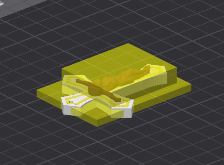

I really wonder why they restrict this for the H2D or H2C models, which actually support multi-material printing! For instance, I have this amazing STL
that blends art and geometry: the first layers could be printed at 0.6mm, then the rest at 0.4mm—perhaps using adaptive layering to transition between the two nozzles. I might not even need that, though, since the two parts are glued together, and only the figure of Christ requires fine detail!

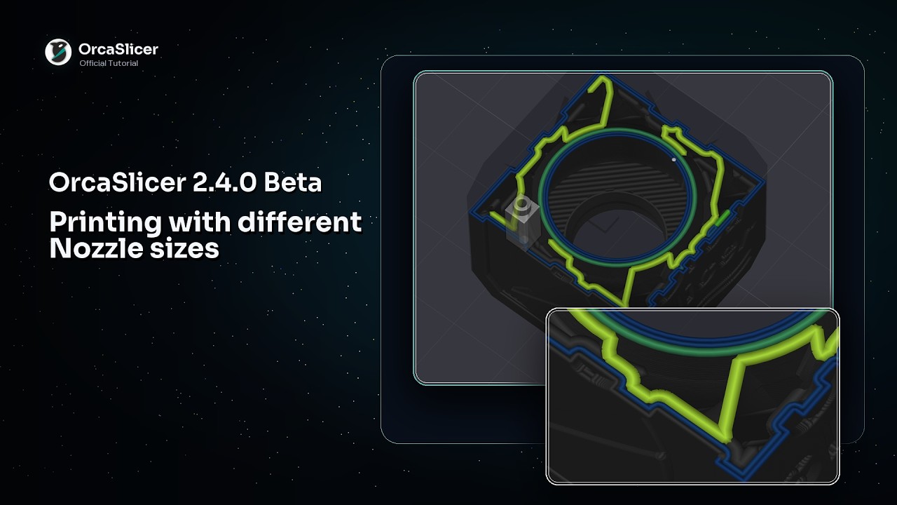

In your case you could consider the Orcaslicer beta to do this on the H2D/C
2nd option is to use the split command in Bambu Studio (using interface pins) and print them separately.
I don’t know if you are talking large volumes, otherwise running it fully with the smallest nozzle, would probably have been finished by now.
