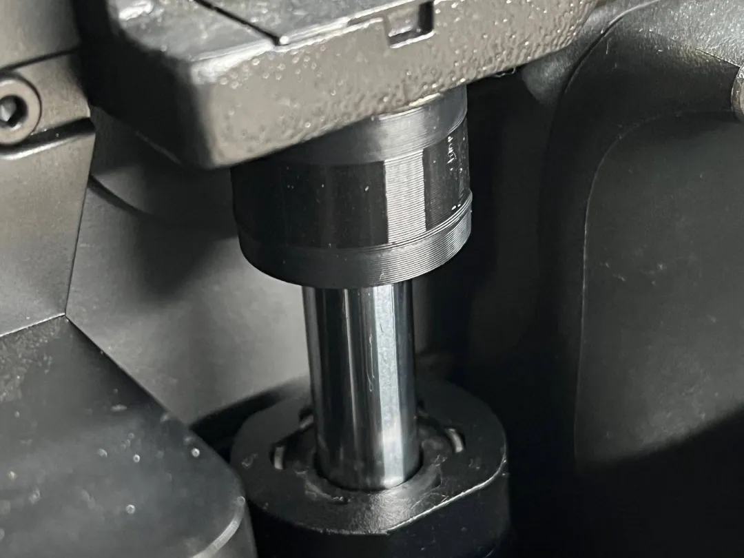

I do it every so often, I don’t really mind when it hits the bottom and continue until it stops but I never liked the up travel because when the head is parked, the bed hits the fan vents of the toolhead and force on it.
I finally came up with a hard stop on the rods to prevent that:
