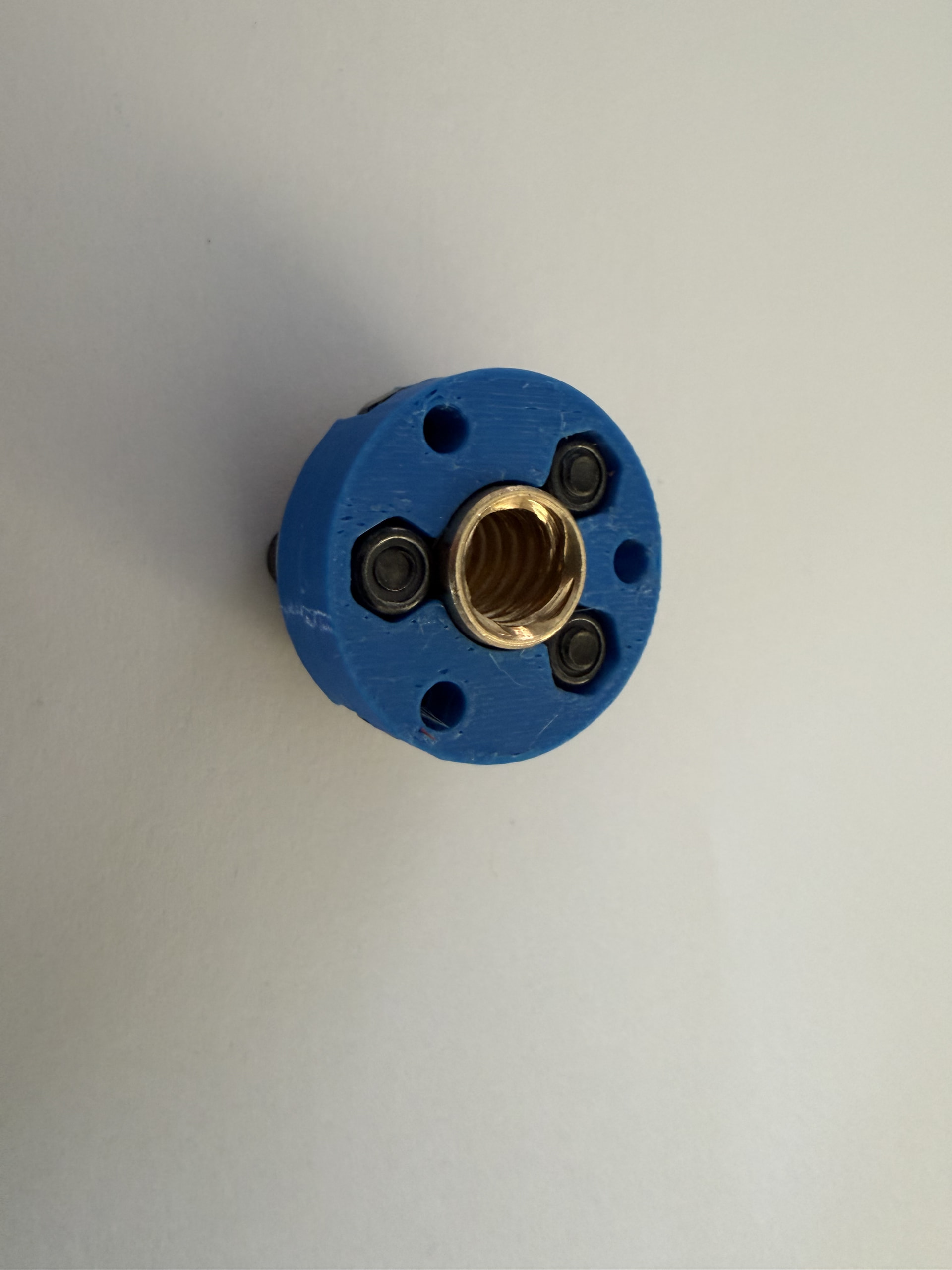

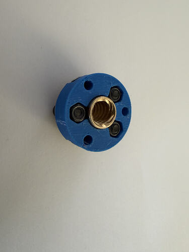

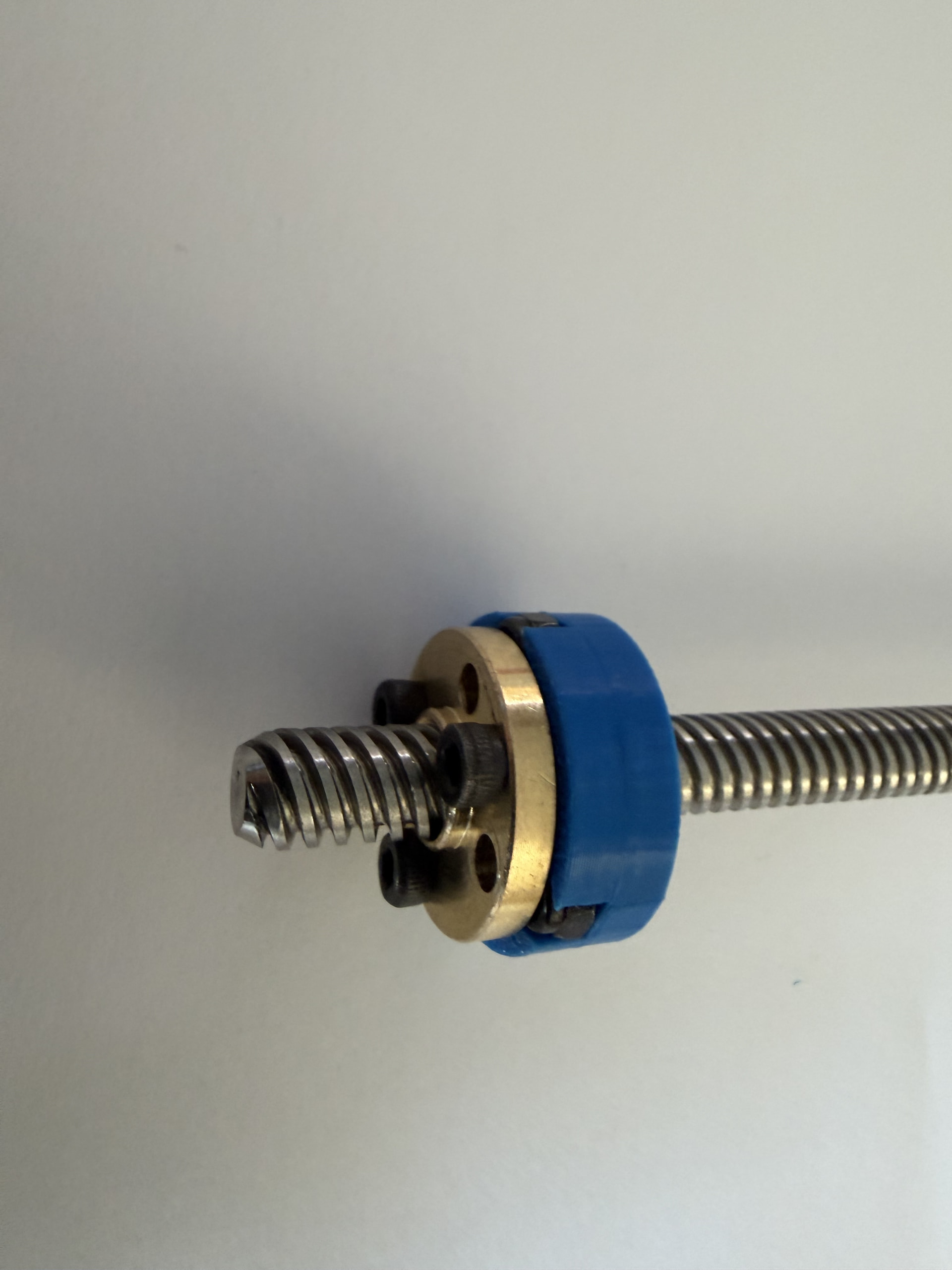

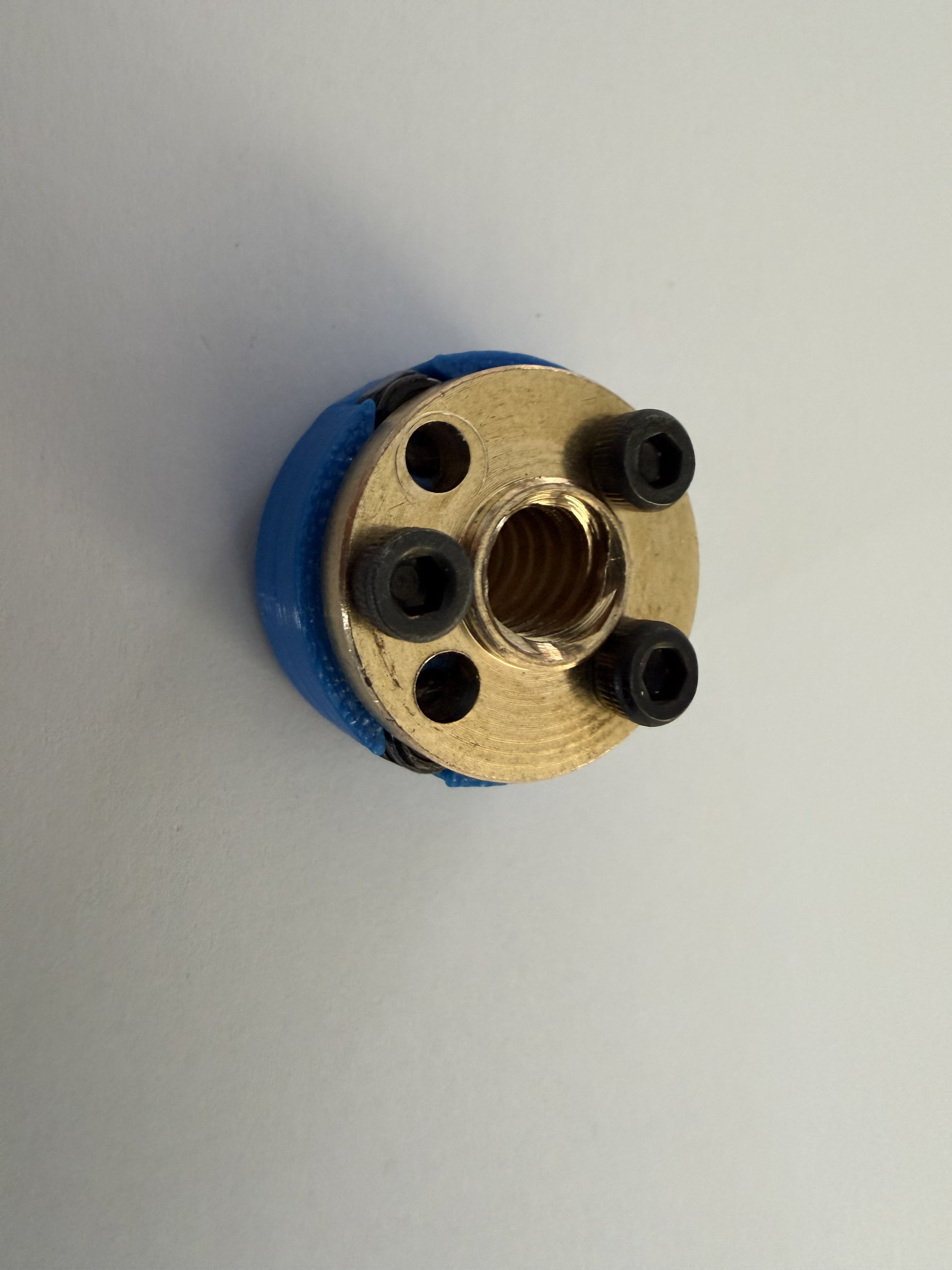

PRINTABLE ADAPTER FOR AFTERMARKET NUTS
(See post 16 for aluminum version)
This adapter installs exactly per Bambu Wiki for the leadscrew kit.
Uses 6 fiberlock M3 nuts, adapts standard aftermarket Brass or POM leadscrew nuts to the H2 3 screw pattern.
Aftermarket nut faces down when installed.
Link to dowload

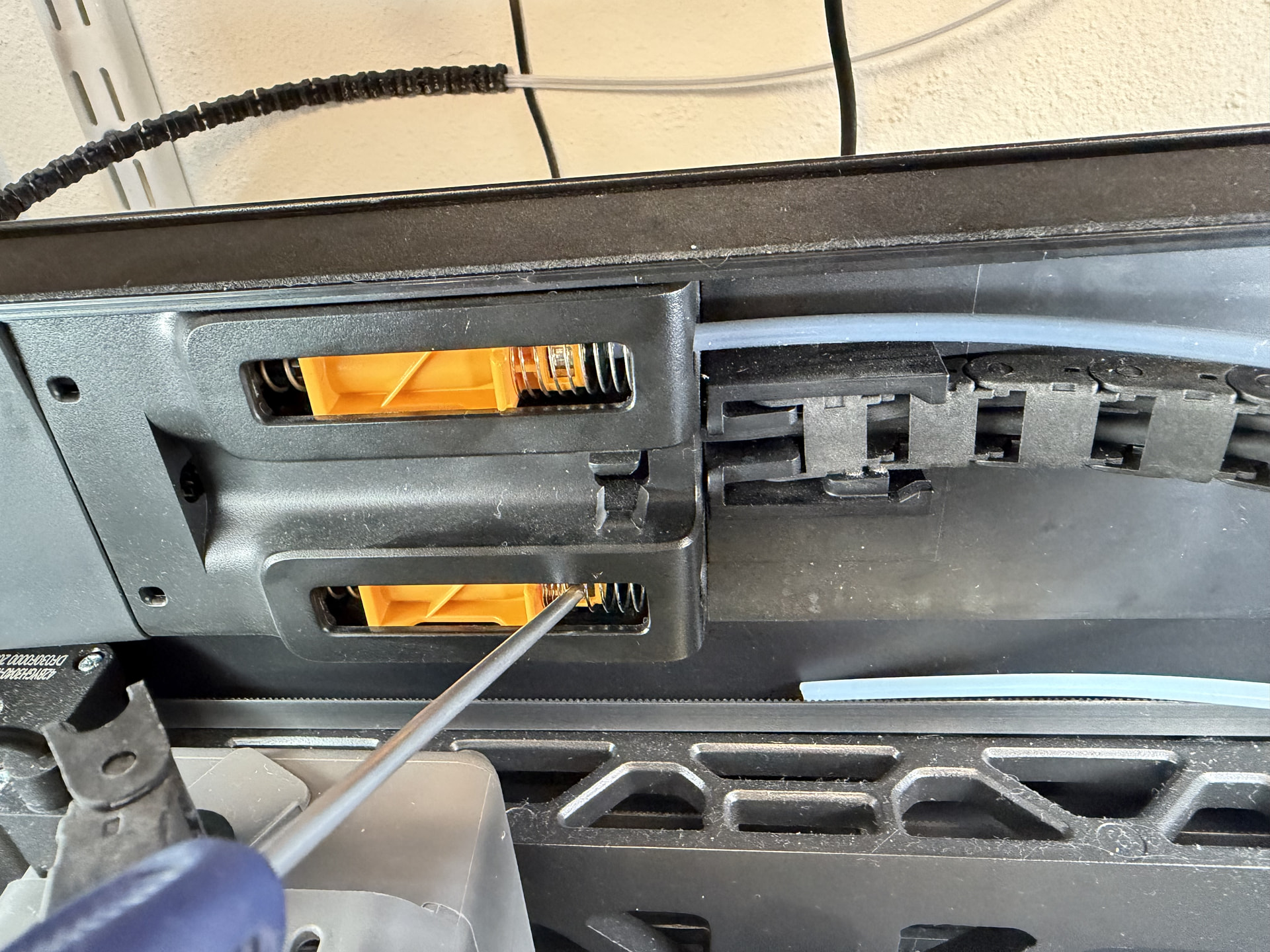

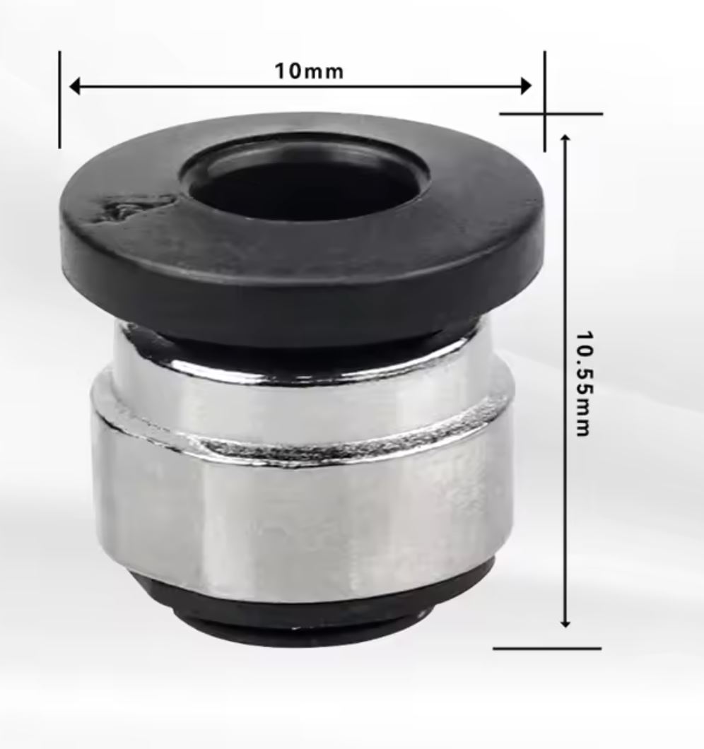

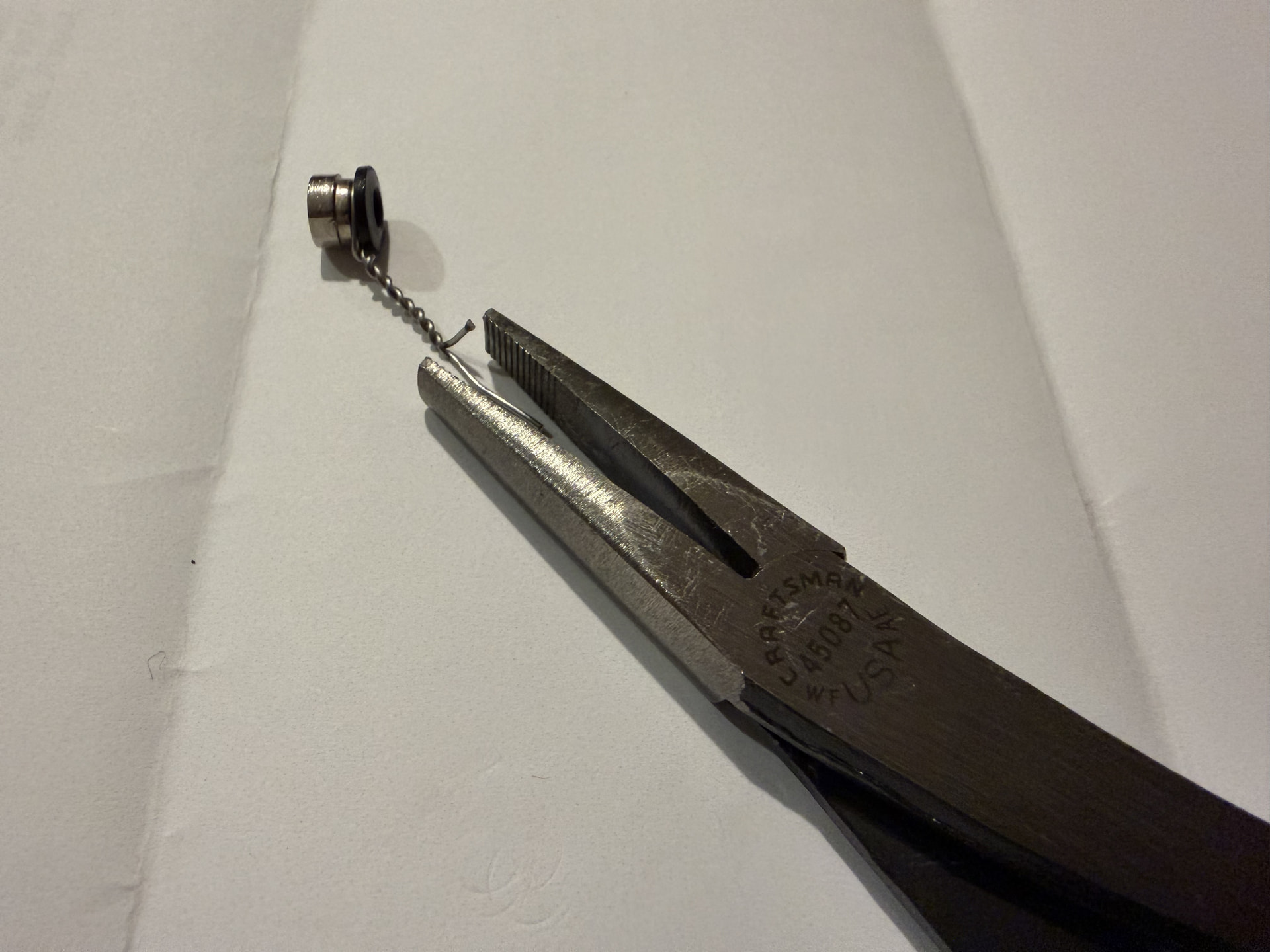

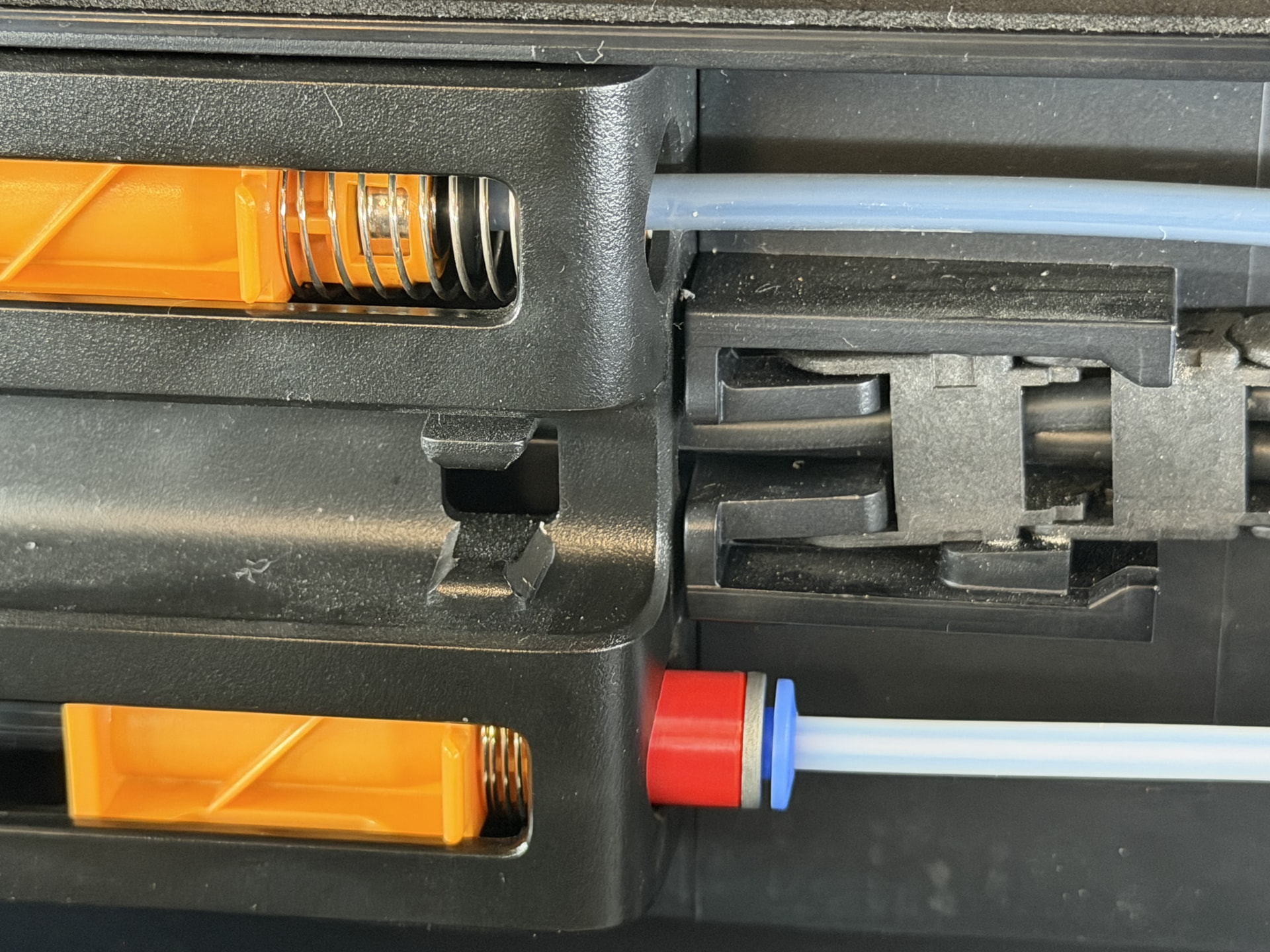

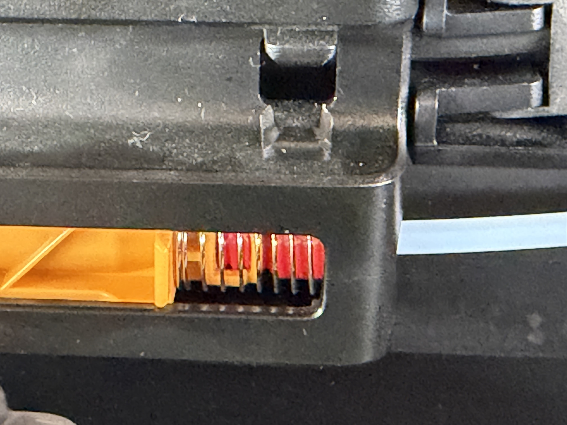

I had a L93A PTFE connector fail where the filament exits the H2D buffer. The Bambu Wiki instructions were to disassemble the printer and replace the buffer. No buffers in stock with Bambu. However; in a different Bambu Wiki it shows how to replace the L93A connector, by gaining access to both sides and prying the connector out. Bambu does not appear to sell the L93A, but Aliexpress and Amazon do.
Therefore, on the buffer I pried the one side I had access to:
Then I wrapped safety wire under the release button of the old L93A and pulled out the broken PTFE connector, without prying from the back.
The L93A has two flats that need to align with the bore before you can press in a new one. I did not have any L93A’s on hand and aligning the two flats would be very hard with the buffer mounted in the printer.

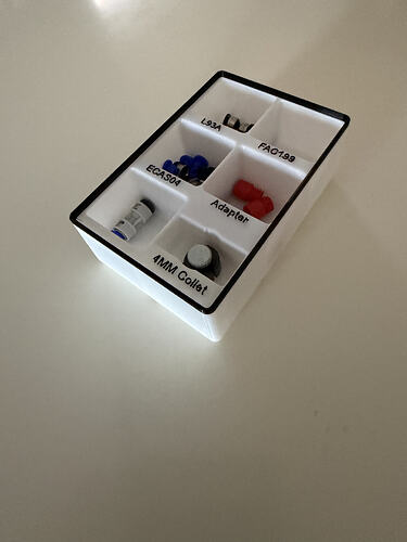

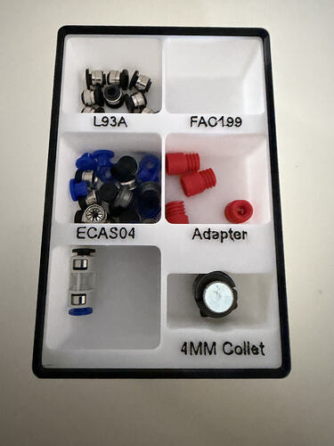

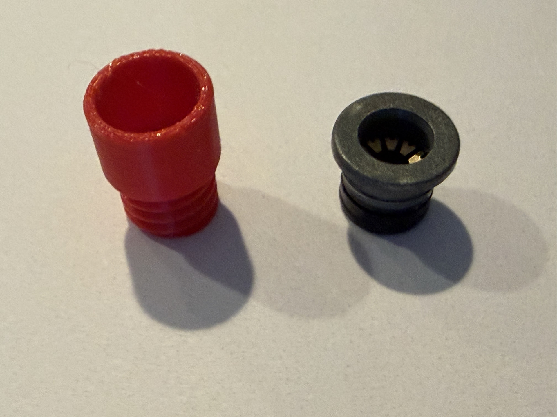

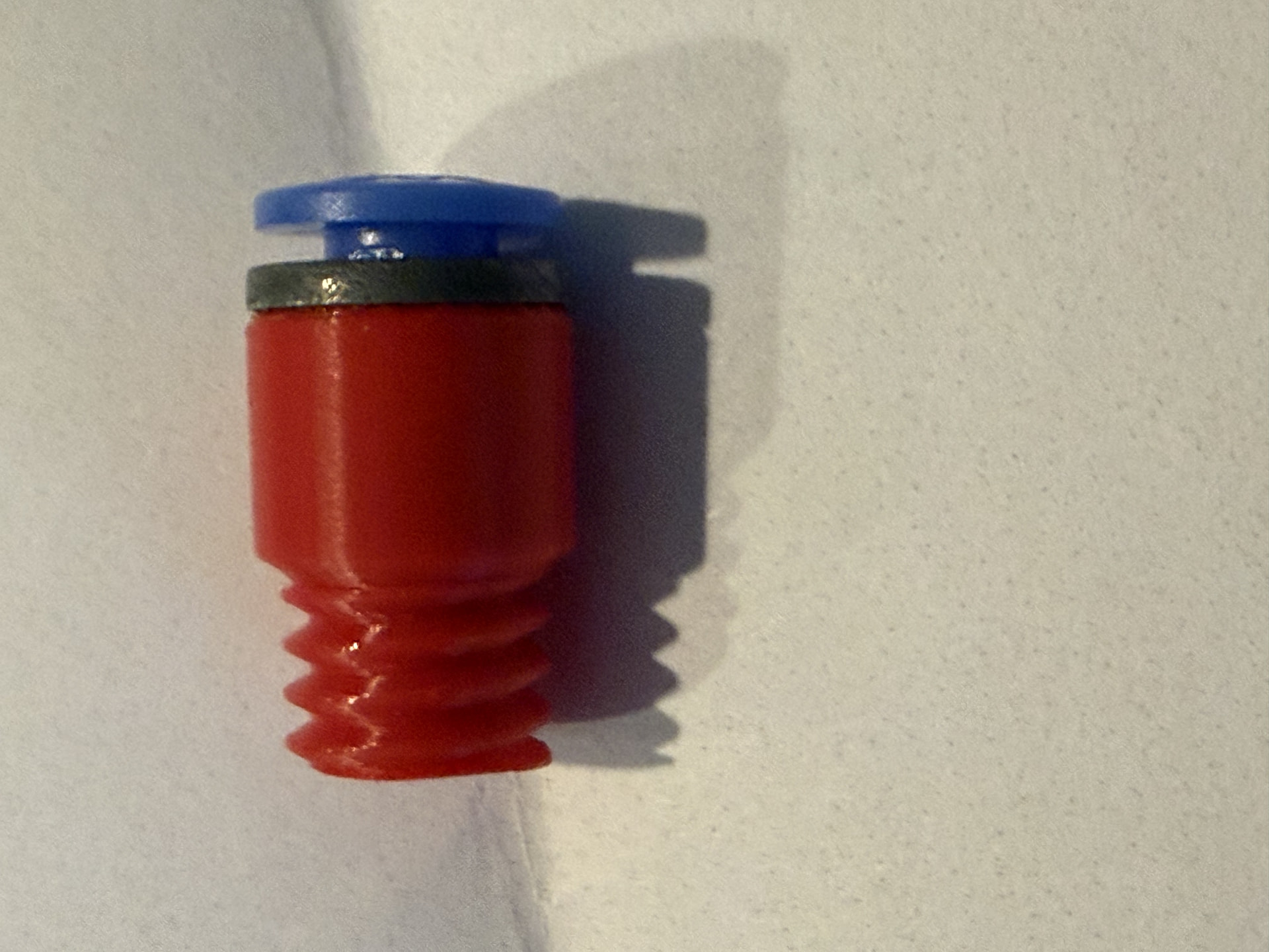

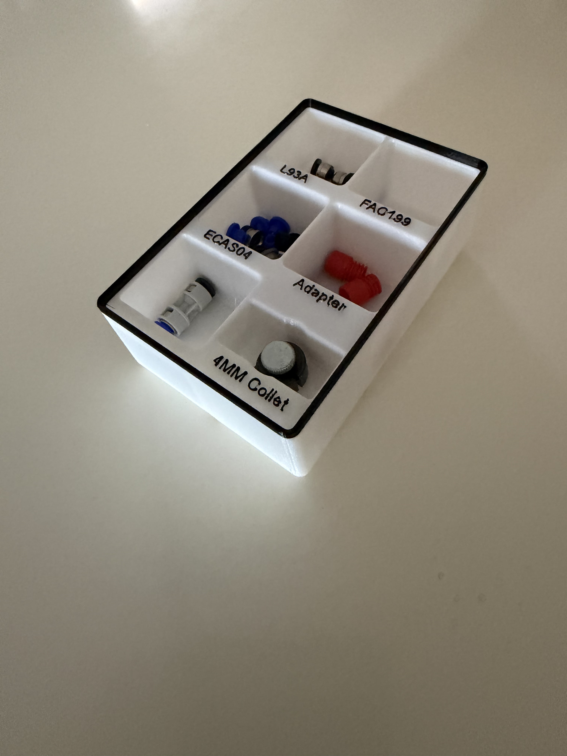

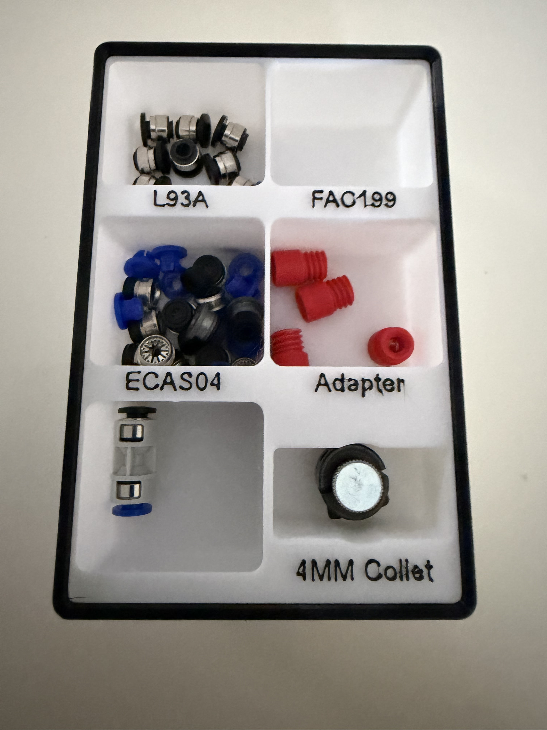

Anyway I prefer Serviceability, so I created a screw in adapter, which uses a ECAS-04 PTFE connector.
I consider this ECAS-04 screw in adapter an upgrade, because you do not need to disassemble anything to replace a bad connector after installing these adapters. Simply unscrew the adapter and screw in another !!!
Link to download my adapter is at the top of this post.

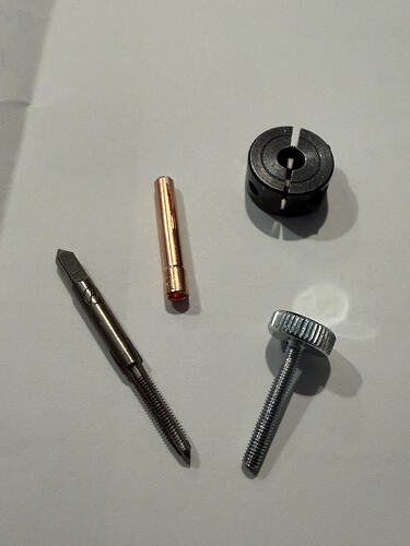

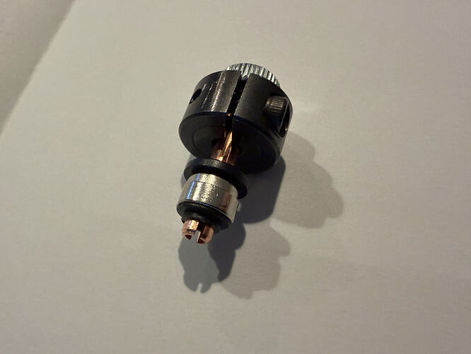

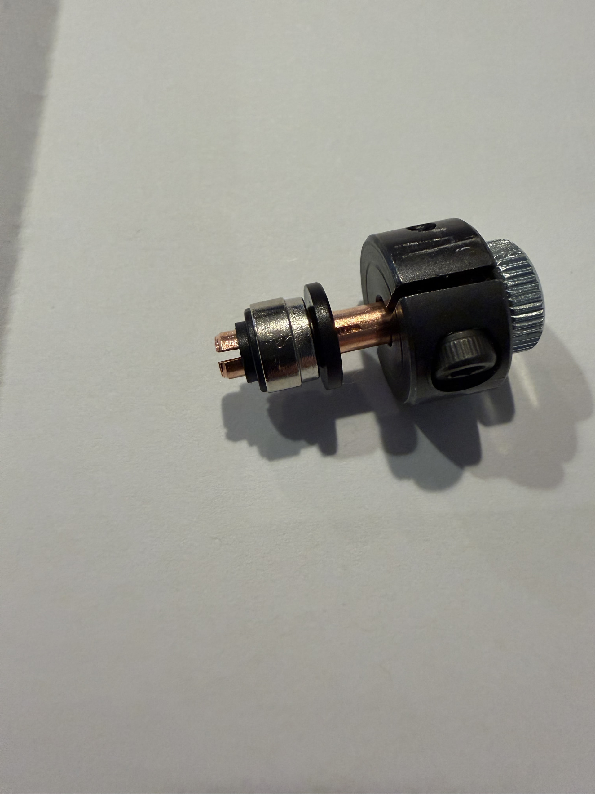

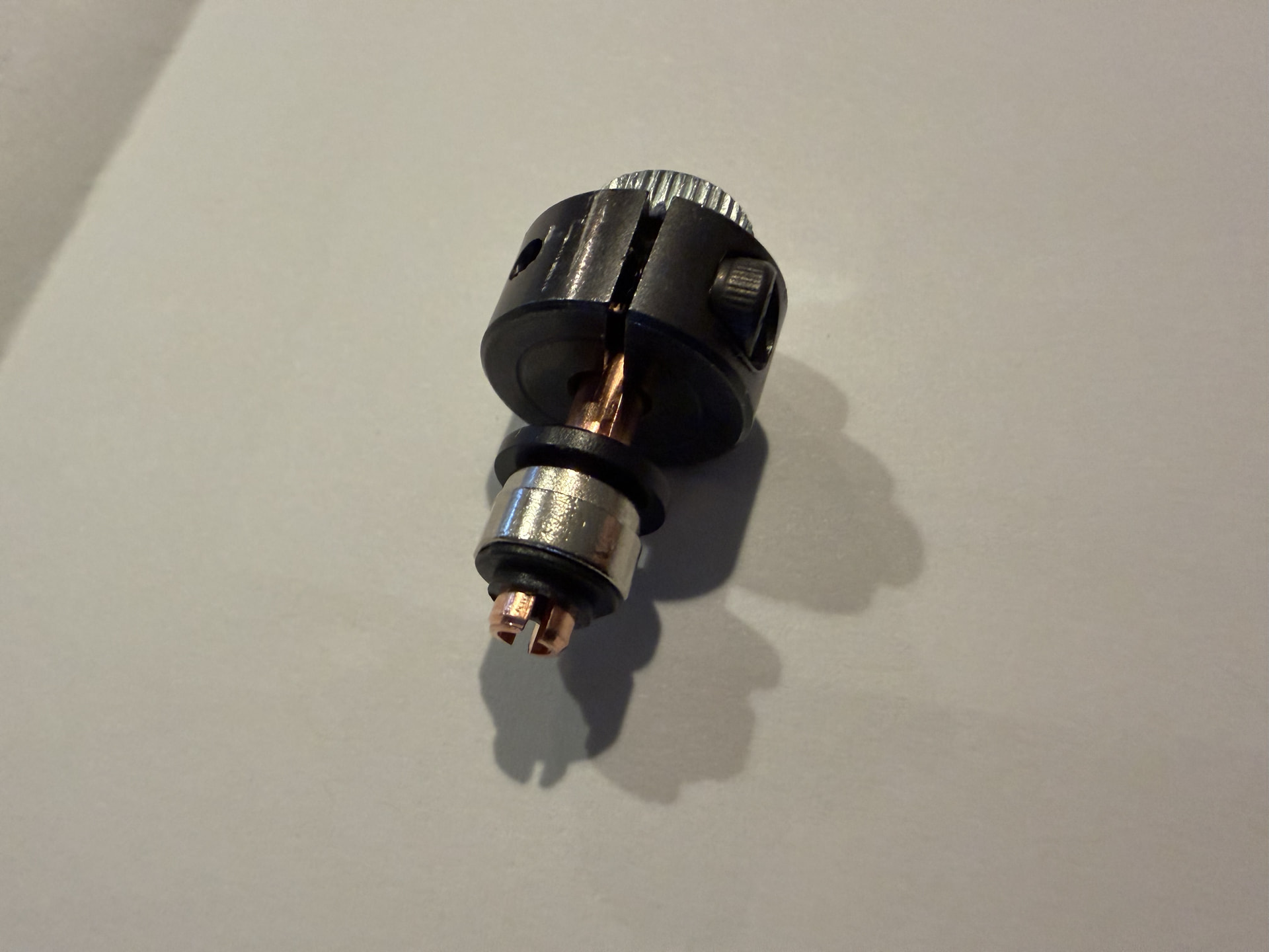

I was able to assemble a simple 4mm expanding collet for PTFE L93A connector removal, when only one side is accessible.
Link to download
https://cults3d.com/en/3d-model/gadget/ptfe-connector-removal-tool

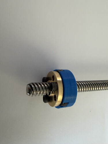

Aluminum aftermarket Z axis leadscrew nut adapter for Bambu H2 printers
Link to download
https://cults3d.com/en/3d-model/game/aluminum-aftermarket-z-axis-leadscrew-nut-adapter-for-bambu-h2-printers
Excellent! Is there any consensus as to which nut is better (POM or brass)?
I have 600 hours on the POM, which has been great. I think either one is fine.
The big difference is: you can forget lube maintenance with POM or just don’t use lube at all
I believe POM is close to what we use for our products which goes by the name Slipper Delrin. It has a brownish color and contains PTFE. Supper easy to machine.
