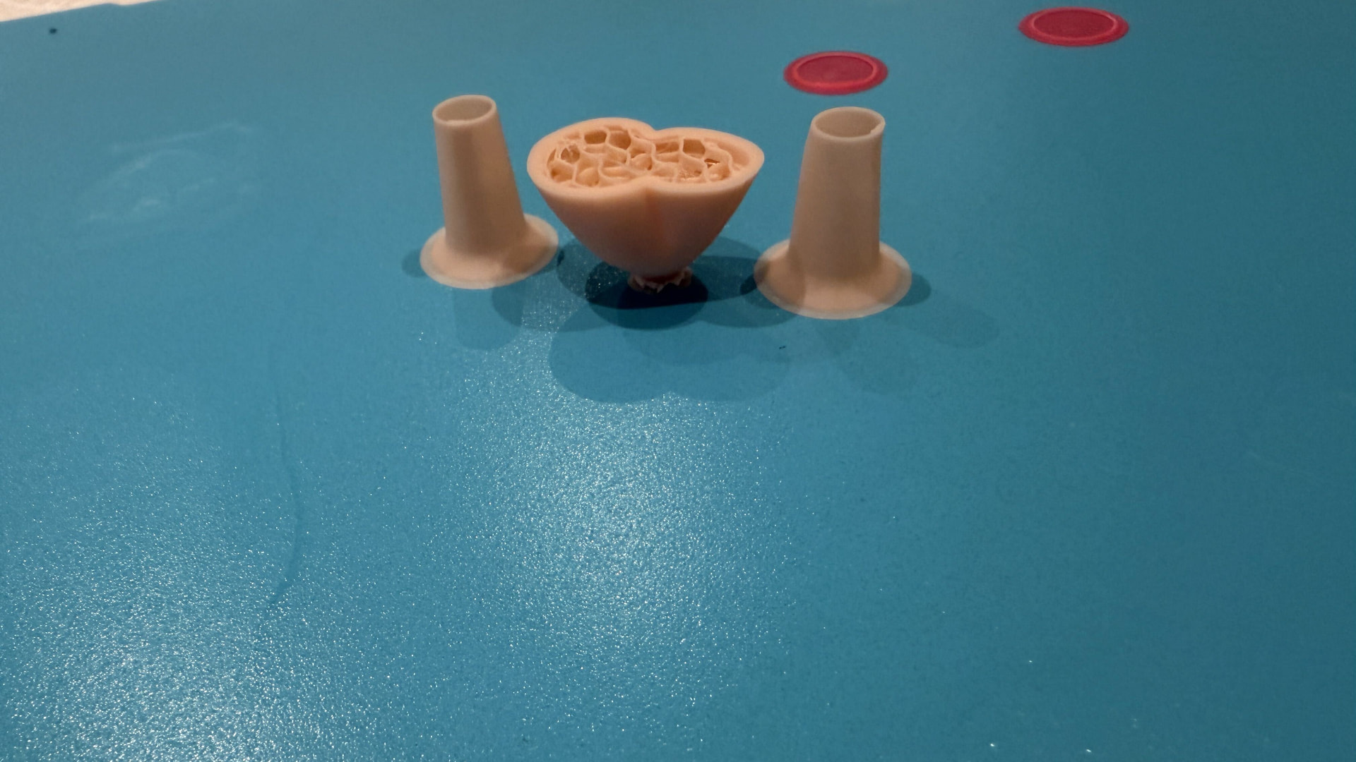

Hi everyone, I have the cryogrip Biqu Glacier, and the stock PEI textured bed. I always use the Glacier, but the last few weeks, my prints haven’t been sticking.

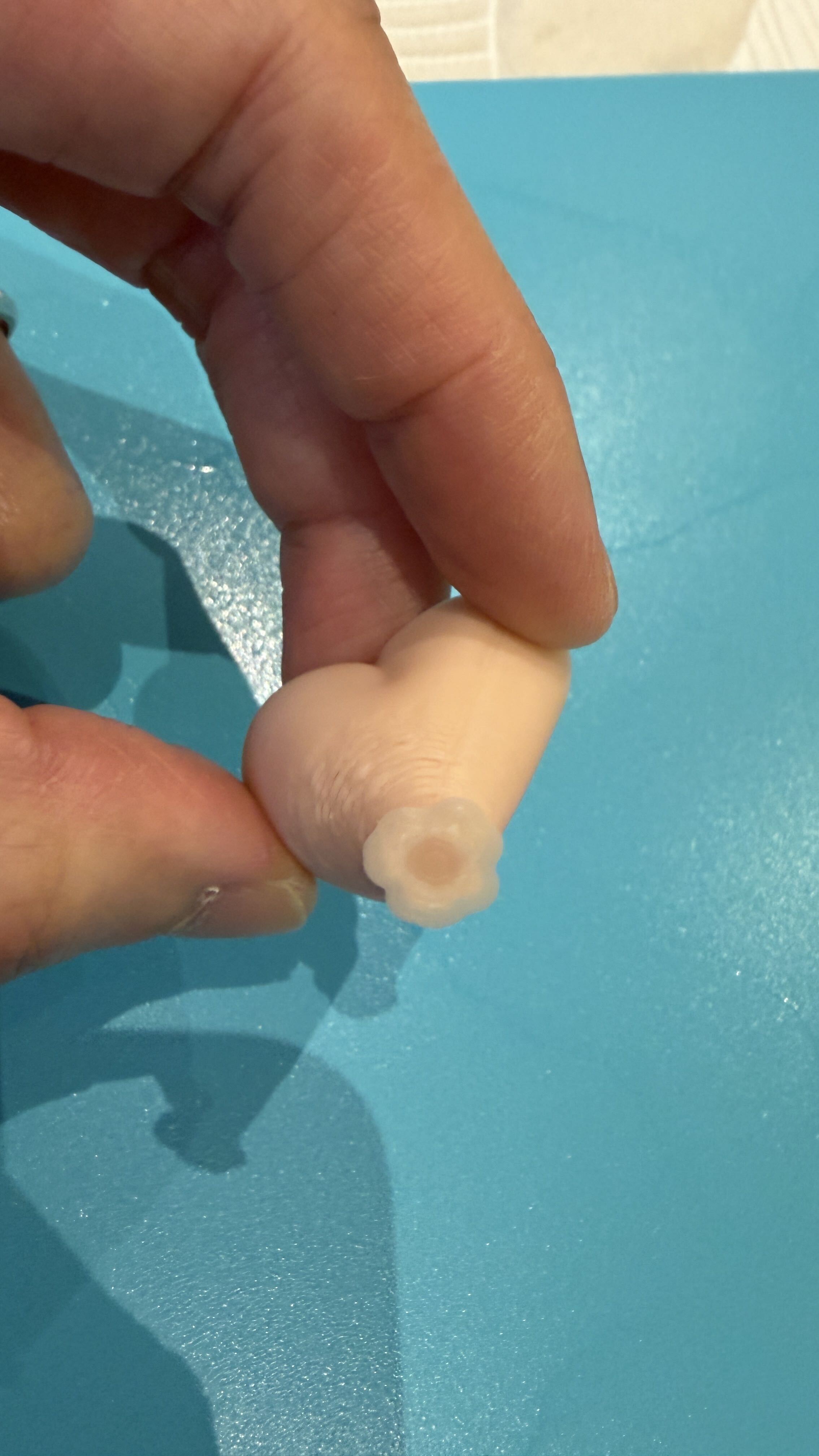

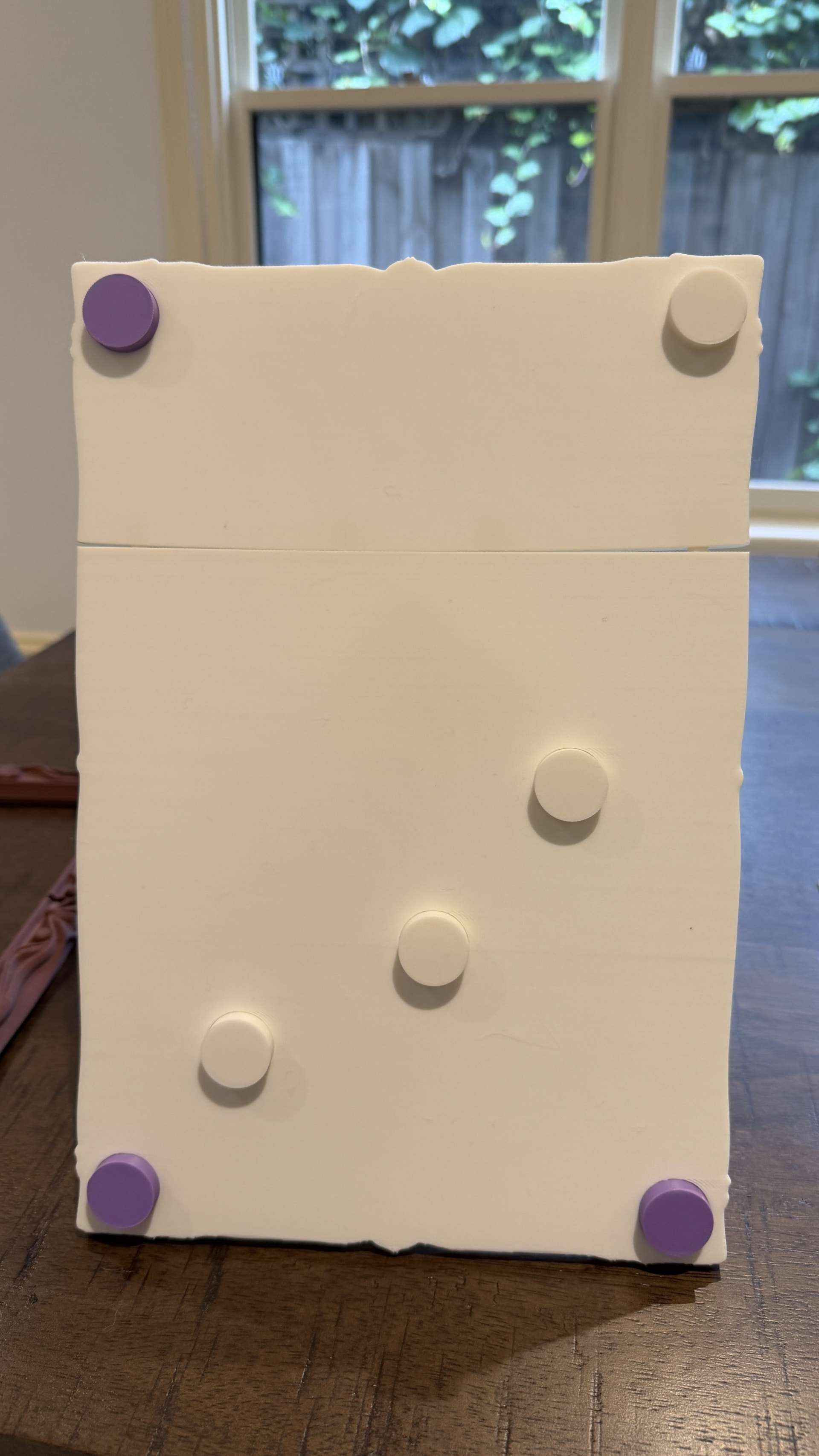

E.g. 1: i was printing a rectangle picture frame sliced in half, and as you can see in the photo, the edges lifted

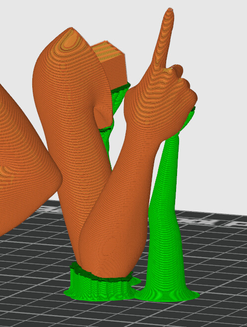

e.g. 2: elbow of an anime figure- keep detaching mid print- i think there’s not enough brim? However other prints keep debonding
I then started printing an anime figure this week. It has multiple parts, and most of them keep detaching midprint and i get spaghetti errors. I’ve tried printing on both the Glacier, and the PEI texture bed and the prints keep detaching around the same layers, so i don’t think it’s a bed issue, but maybe a printing setting issue

I would definitely go for a larger brim here.
The area holding the elbow is still relatively small.
Washing the build plate with the cheapest dish soap, rinse with water and dry with a paper towel usually does wonders also.
Regarding the large plate, those large sized flat objects tend to warp easily

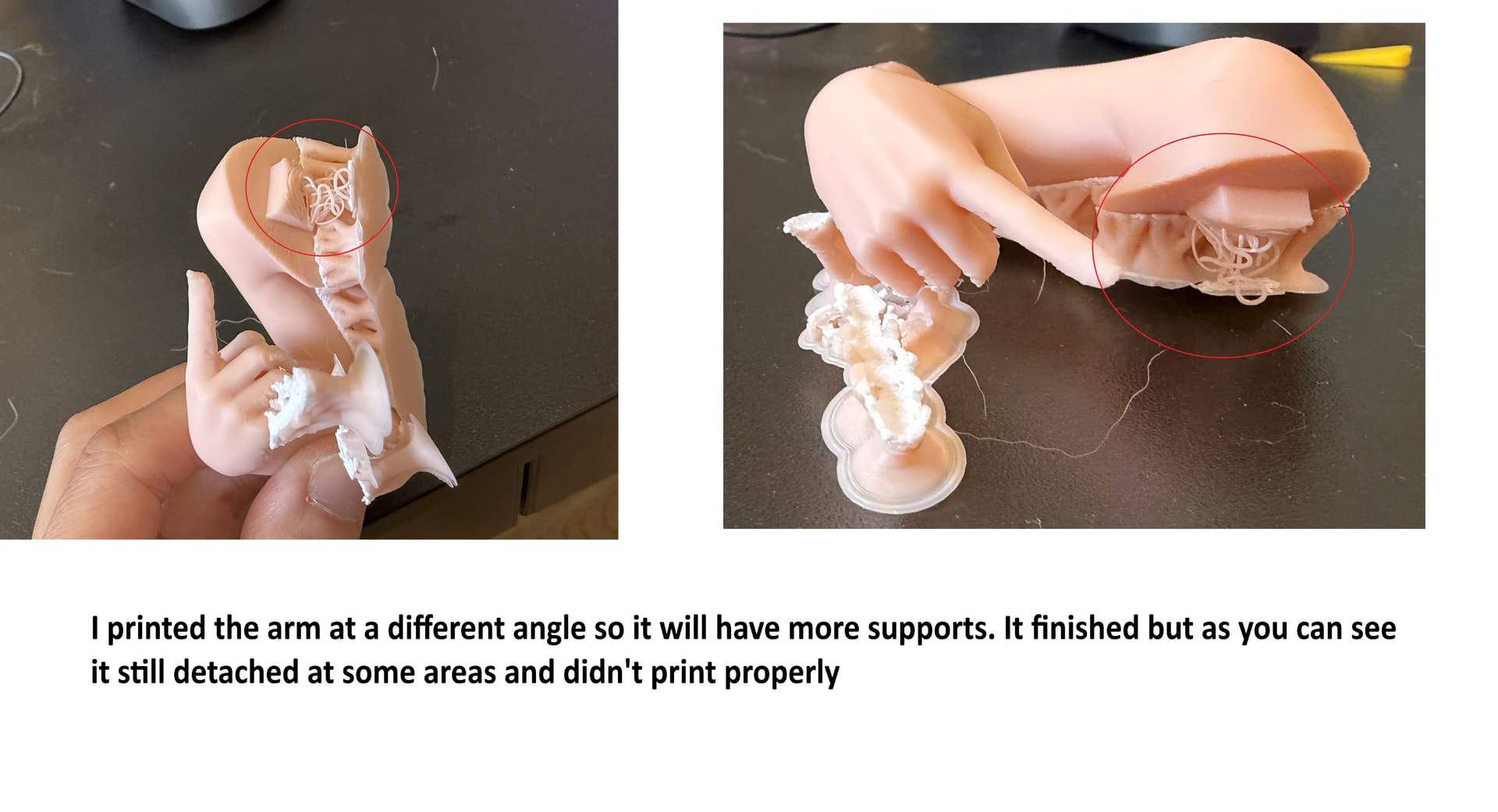

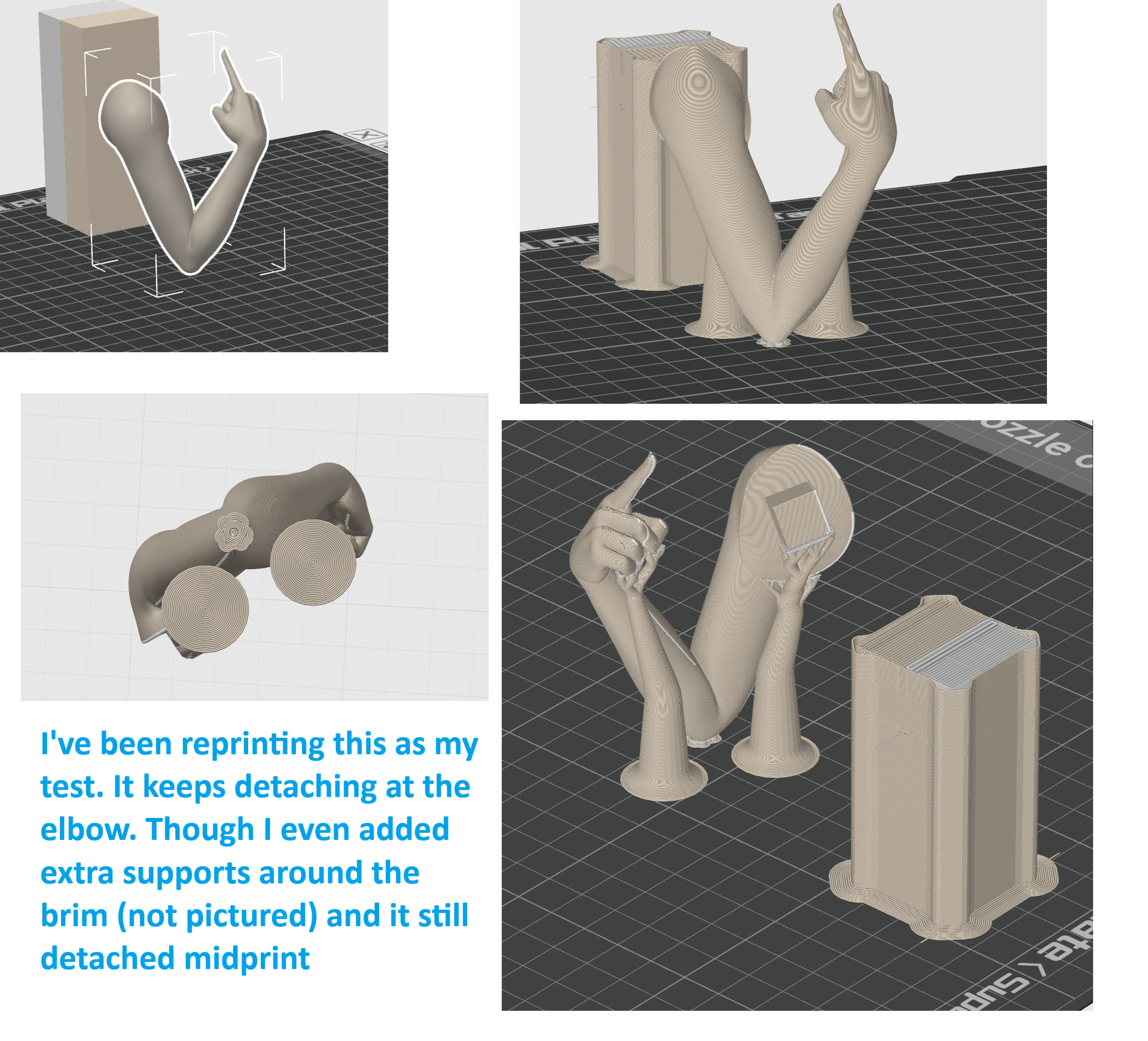

i haven’t tried a larger brim, but i have added extra supports around that elbow, and it still detached from the bed (this is after washing with soap AND adding an dehsive). Any other suggestions
At the height the elbow detaches from the build plate, the supports are not touching the part yet.
I’ve even done a print like this with added supports, but it still detaches from the heatbed

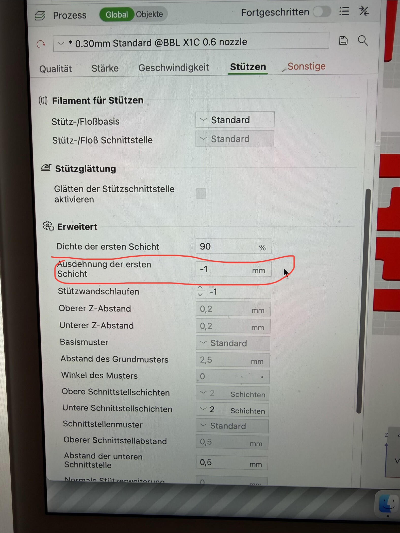

Also when i try to edit the brimears, i make the brim larger, but when i slice it, the new brim doesn’t show up. Do you know how to fix this brim issue?
It’s not bed adhesion issue. It’s your model part either warping upwards or over extruding causing nozzle knockovers.
Turn off “reduce retraction for infill”, reduce your flow ratio.
adding or reducing cooling might also help. it’s a game of balance.
For a tall thin part with small contact on bed, it’s always going to be a struggle.

If you want to create a ‚kind of brim‘ to your supports base you could also increase the wideness of the support 1st layer. This adds additional base layers to the support structure equivalent to a brim.
I added a screenshot. It is in German though but I think you‘ll get the setting. It‘s set on -1 for ‚no brim‘ and can be raised to your needs. Then it creates a bigger base for less warping of the support structures.
By the way I find similar issues too on my glacier with the H2C. Quite the opposite was my experience on the X1C. On my Glacier there I was able to nearly print everything no matter what kind of filament.
Try adding a pin or two on the lower arm, maybe the plastic is causing either the upper or the lower arm to move closer to the other part due to a bit of warping. You can use the add part (Cylinder and adjust to size and place between upper and lower arm sections) in the slicer and then cut the pin off after the print has completed
