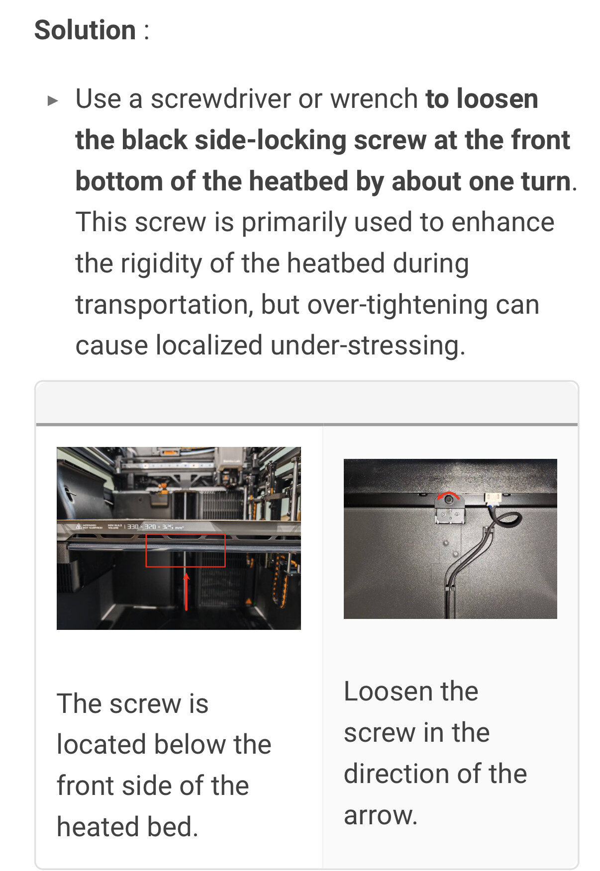

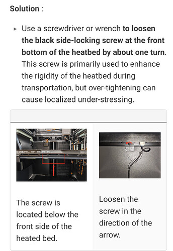

I found this bbl wiki
In there is has a section about a shipping bracket on the bottom of the heat bed that is not needed and can cause issues warping the heat bed. It can be fully removed or loosen but is not needed for normal operations, I’ve no idea why its not mentioned during the setup given the issues it caused me.

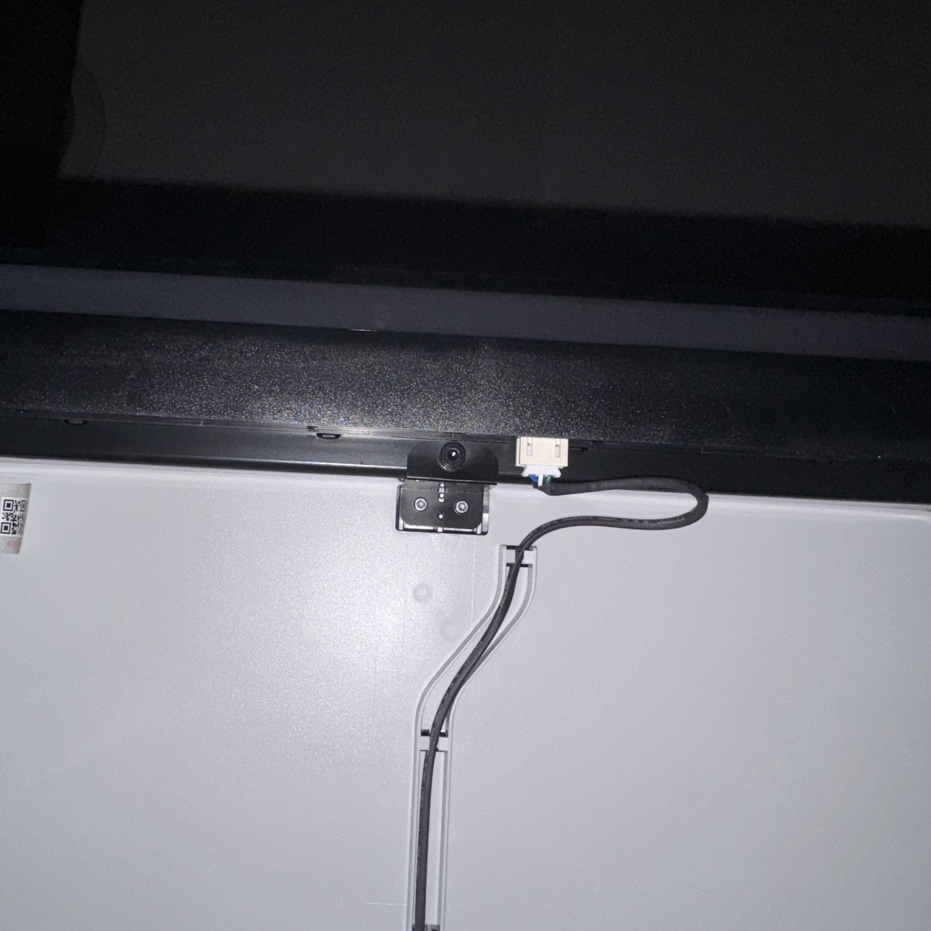

The infamous bracket :wink:
Many of us (a lot I think) have removed that bracket on our H2D for the exact same reason.
I agree, if it’s not needed, BL should ask to remove it as part of the initial installation as it may cause issues.
I removed the one screw with hex 2.0, but I can’t find a bit to fit the other 2. 1.5mm does not work for mine. What did you use?
If you read the wiki, it states that you only need to loosen the larger top screw.
Thanks. Some people said they removed the bracket. I did remove the larger screw but then put it back snug but not as tight as it was. So far, my first layers are printed better.
If it still gives issues, you can remove the entire bracket.
This is shown after the section I shared :thinking:
I noticed this when you read on in the wiki.
The bottom 2 screws can be removed with the 1.5mm allen key.
