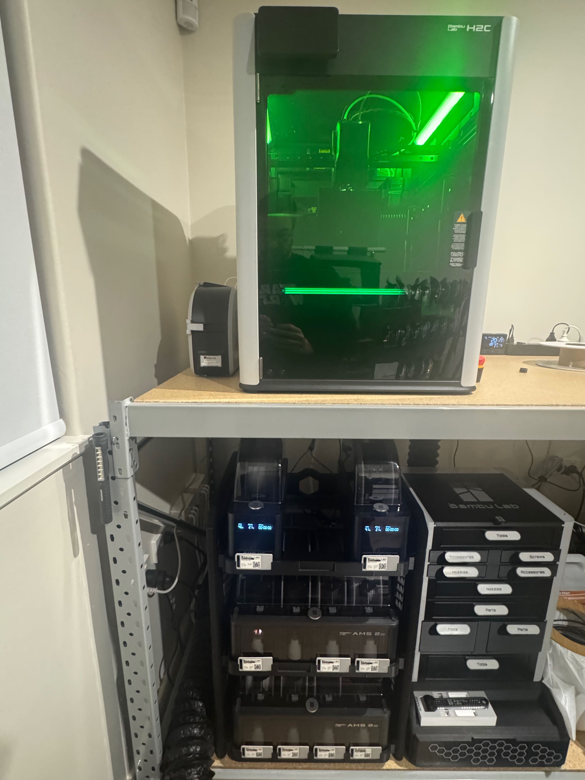

Unfortunately they have not been able to replicate the issue. They have requested a video which I have not been able to provide. Now, I am a little to blame for that, for for 2 reasons.
  1. I have been away for work for an extended period of time and eveytime I want to make the video, its sort of starts to work.
  2. I am limited with space. My setup is close to a wall, so it’s hard to get behind it and because my AMS stacker sits under my printer, its hard to get a proper video showing how the filament feeds up into the track switch..
Now, my setup (which I appreciate), isn’t ideal as the filament run is probably a little long. But, I have to work within my workspace, so I try to make it work. While I appreciate the filament run is long, when it works correctly, it does feed into the nozzle, so I don’t think that should be causing my mapping issues. (Pic below)
