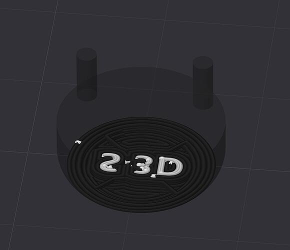

Found something strange about the nozzle selection.
A two colour print somehow used 3 nozzles.
When printing a model like this, instead of keeping the black filament consistently in the nozzle it was initially assigned to, somehow it got retracted, switched to left nozzle, then white got fed into another vortek nozzle.
After the dual colour part was done, it switches the black filament back to the vortek nozzle again.
