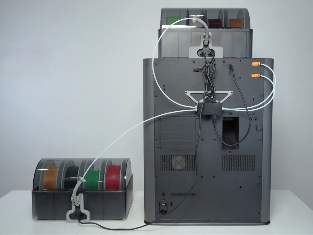

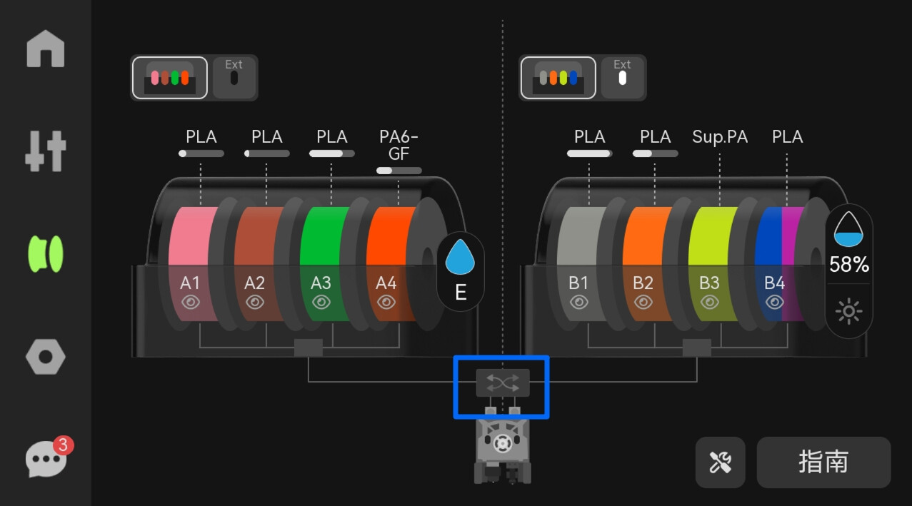

1. Added support for the Filament Track Switch
The filament track switch is specially designed for dual-nozzle printers, equipped with 2 filament inlets and 2 filament outlets, and supports seamless mapping between AMS and dual nozzles.
For more details, please refer to the wiki:
Filament Track Switch User Guide - H2 Series | Bambu Lab Wiki
This feature requires Bambu Studio v2.5.3.60 or later / Bambu Handy V3.18.0 or later.

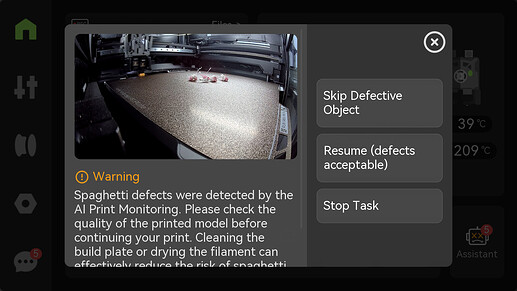

7. Added live image display in AI detection error pop-ups.

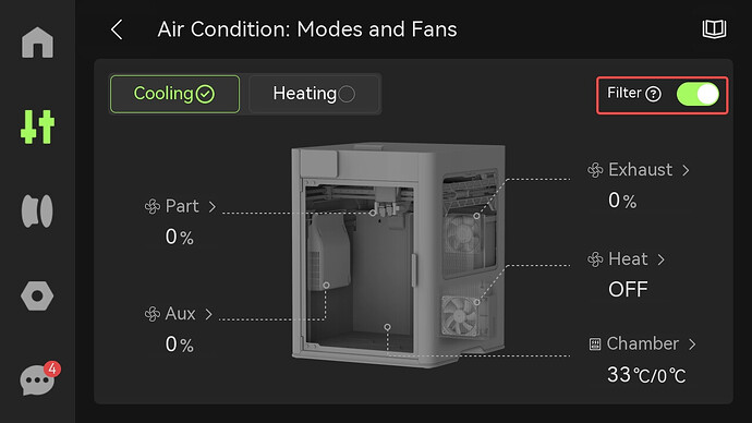

11. Added a filtering option with cooling mode for the adaptive air circulation system.
This option can be enabled via the slicer or the printer UI, and it’s mainly used to filter the air when exhausting the air for low-temperature filaments. Requires Bambu Studio version 2.5.3 or above.

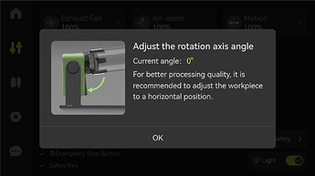

Added a new page for real-time rotary attachment angle monitoring.
This page allows you to adjust the target object to a horizontal position before engraving, ensuring the captured unwrapped image better aligns with the actual object and improving overall engraving precision.

Would be great if you could also share a design that’s putting the track switch closer to the ptfe inlets.
Currently, we only offer the design shared above. We will also include the STEP files when they get published to MakerWorld.
In terms of position, the curvature of the PTFE tubes should be considered, as the tube can restrict the filament movement and lead to load/unload failures.
