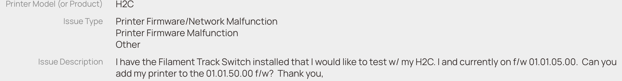

I submitted a ticket to get on the .50 beta the night before last and got put on the “3 business day” queue. I got notice this morning that the beta was available. I installed it, but need to wait until I get home from work to test it.
I did the same last night … I was told 3 days but don’t see it yet on the printer. BL should not call this a public beta, I feel it is a restricted distribution beta. Most companies who provide public betas don’t limit the audience… their attitude is the more testers the better… not sure how they pick their group of beta testers.. anyway, Hopefully I will see this shortly and can try and use my filament switch supported by this new code level.
