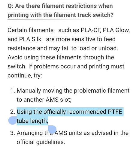

The accessory works as intended From the Bambu Wiki
The AMS has specific requirements for the physical properties of filaments. The following three types of filaments are not recommended:
  • :cross_mark: Too soft (e.g., TPU 95A/85A/83A/80A, damp PVA or BVOH): These cannot pass smoothly through the AMS / AMS lite channel, and can easily cause loading/unloading failures, clogging, and other issues.
  • :cross_mark: Too brittle (e.g., certain brands of PET-CF, PLA Wood, PA-CF/GF, PAHT-CF/GF): These can easily break inside the AMS / AMS lite channel.
  • :cross_mark: Too hard and rough (e.g., certain brands of PET-CF, PA-CF/GF, PAHT-CF/GF, PLA-CF/GF): These can easily wear down the internal feed channel of the AMS / AMS lite.
In addition, the AMS has an extra transmission gear that works together with the extruder gear to provide stronger feeding force. This helps overcome greater feeding resistance, so the AMS can handle some softer or rougher filaments.
These types of filaments were not intended for use in the AMS and hence the FTS. I have had very little problems with my FTS and long as I follow the specific requirements clearly stated by Bambu

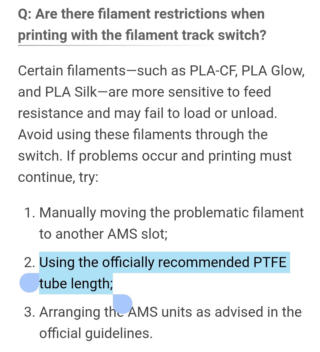

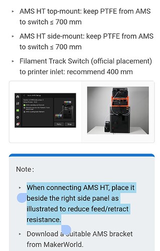

I re-read the Wiki for the install, I have a few questions about your install…

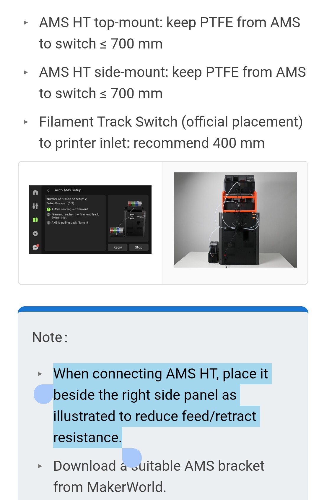

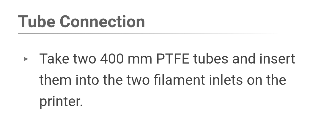

  1. For the tubes between the outlet of the FTS to the printer, did you use the supplied 400mm PTFE tubes, or did you use different ones/change the length?
  1. On the inlet side, did you use the supplied 700mm tubes, or did you use different ones/lengths? The Wiki is a bit conflicting, one place says “<700mm”, but another spot has an interesting comment:

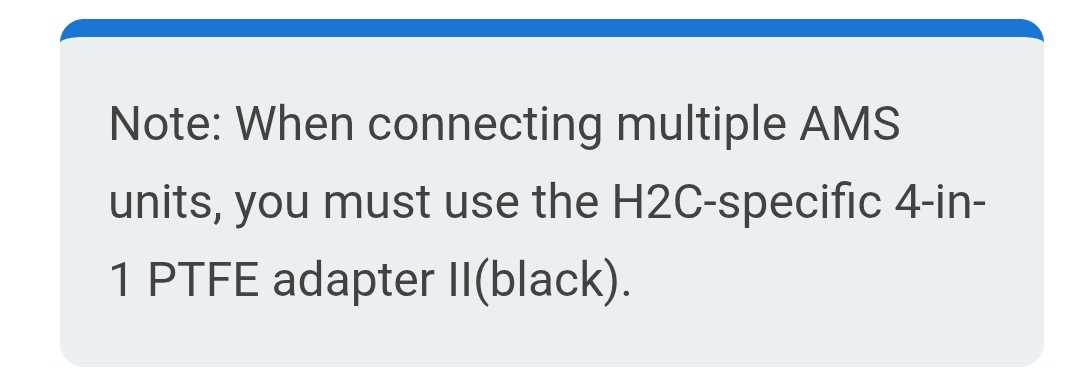

  2. Are you using the new style PTFE 4 into 1 adapters or the old ones?

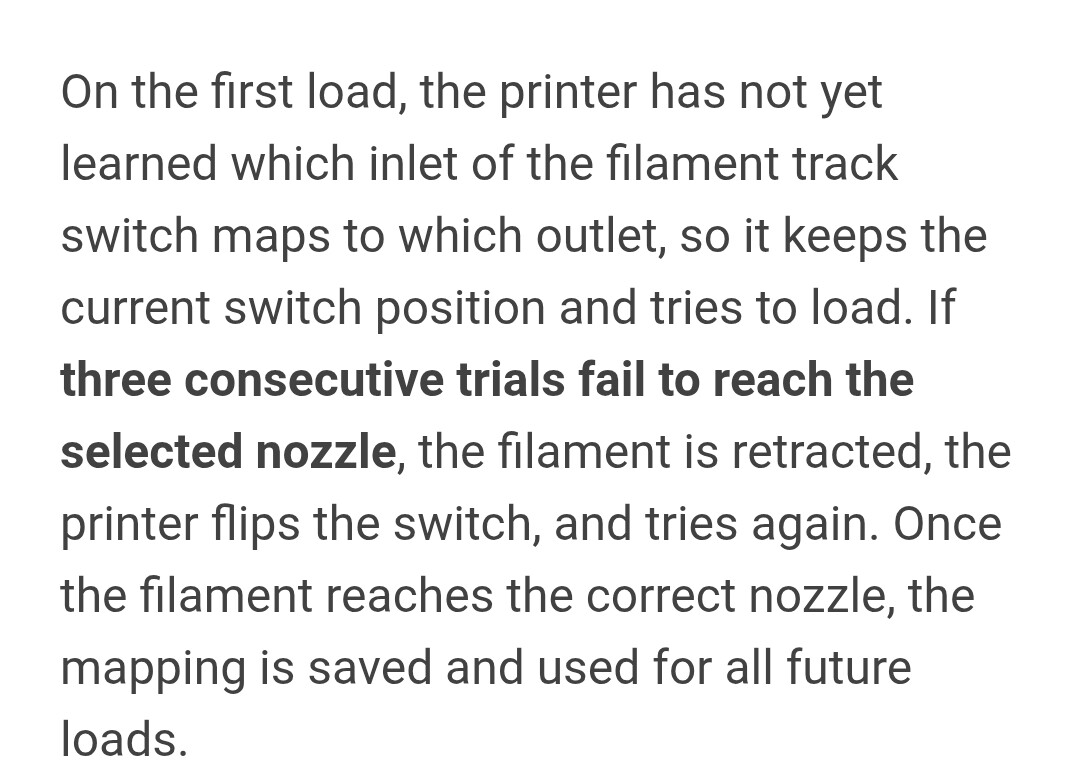

  1. It sounds like you’re using a mix of AMS 2 units and HTs, it sounds from the wiki like the HT is more sensitive than the AMS 2 - for your 3 filament test what happens if you put all three in your AMS 2?

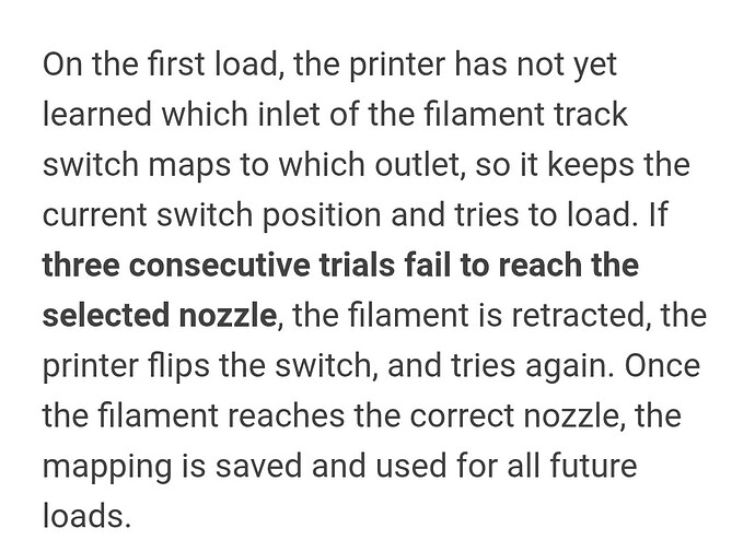

  1. I wonder if this is a wrong mapping issue? Have you tried resetting the mapping and putting only one filament in each AMS initially so it can re-learn the connections to each nozzle?
