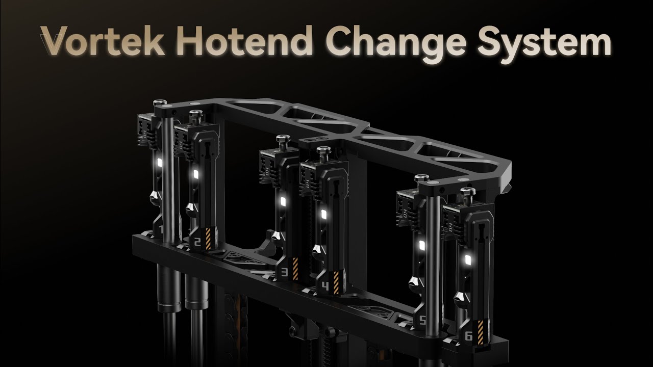

The contamination only happens at the nozzle, but the nozzle doesn’t work alone. It needs the motion system, filament feeding, heating, and temperature sensing, all wired into the printer. Disconnecting and reconnecting those systems during a nozzle switch is a reliability nightmare. The more components you swap as a package, the fewer connections you need to worry about — but that comes with a larger footprint and higher cost. The less you swap, the cheaper and smaller things get, but the harder it is to be reliable. In the end, it’s always a trade-off between reliability and footprint.
Here’s a quick tour of the options:
Plan A: Swap the whole gantry. Straightforward, no connectors to worry about. The catch: you need a full gantry for each nozzle, which makes it expensive and bulky. This is the IDEX approach — usually limited to just two nozzles.
Plan B: Swap only the toolhead, while sharing the same motion system. This saves cost and space, but you now have to deal with mechanical connectors between the gantry and the toolhead. Toolheads are still bulky, so you can’t fit too many of them. This is the “tool changer” approach, seen in products from E3D, Prusa, and later Snapmaker.
Plan C: Swap only the hotend assembly. That way you share the motion system, extruder, and cooling, which saves even more space and cost. But then you face the headache of connecting all the power and signal cables for heating and temperature sensing. A pogo pin connector works in demos, but making it reliable over millions of cycles is a whole other story.
Plan D: The simplest idea — if you trust thermal conductivity at the interface, you could heat and measure temperature from the toolhead side, like in the A1 nozzle. Then you’d only switch the bare nozzle and heatsink. The challenge is ensuring consistent thermal conductivity, especially when the nozzle needs to be changed thousands of times more often than on an A1.
We could keep going with Plan E, F, and beyond, but let’s stop here. In 2023, we decided Plan C was the sweet spot — the right balance between reliability and footprint — as long as we could crack the connectivity problem.
Our secret? Ditch the mechanical connectors and go wireless. Induction heating can already heat the nozzle wirelessly, but heating alone isn’t enough — you also need to measure the temperature. Our solution was to design a custom microcircuit on the hotend that receives power, measures temperature, and communicates wirelessly with the toolhead. It might not sound fancy on paper, but making it robust, reliable, and certifiable took a ton of engineering and know-how. In the end, this integrated approach let us shrink the hotend assembly down to just four parts: nozzle, heatbreak, thermistor, and a compact PCB — all packed into just 10 grams and a 20 × 15 × 56 mm form factor.
