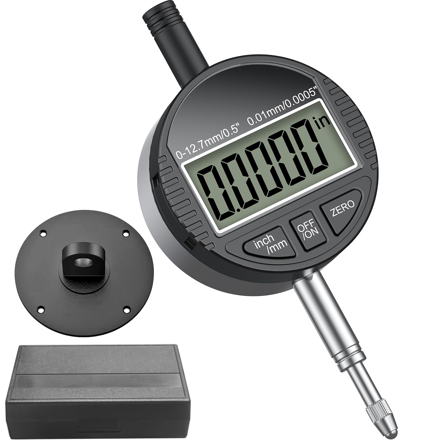

This is how I ended up tramming my bed. Plastic shim was just not working for me. Imgur: The magic of the Internet It was fun.

I actually just bought a dial indicator and it arrived this morning! I’m going to do this today or tomorrow. Thanks for posting that.
Support replied this morning as well and they want to send me a new eddy sensor, I had to buy some filament anyways so I just purchased one. Maybe they’ll send another and I’ll have a backup. I thought the purchased one would probably get here quicker so it was worth the $10.
Which bracket did you use for your dial indicator? It looks like you are using the tramming gcode, the mounting bracket I saw says it’s incompatible with that. If you found one that does work with it I’d prefer to go that route
This is the one I used. With my indicator it works with the Bambu g-code. Every indicator is different however.
Awesome, I think thats the same one I bought with a different brand name:
To clarify, I meant the indicator I used in my video. A rather old but high quality analog one. I don’t know how it will work with yours; if you can use the factory gcode or if you need the custom one in the link.
But it does make the tramming process a whole lot easier and accurate. I also heat my plate to 100C to do it…be careful if you do.
The last thing to point out is I noticed that I had to do a high temp bed level, run a few prints/heat cycles, and then run the high temp bed level again. I guess there was some thermal settling. Weird.
