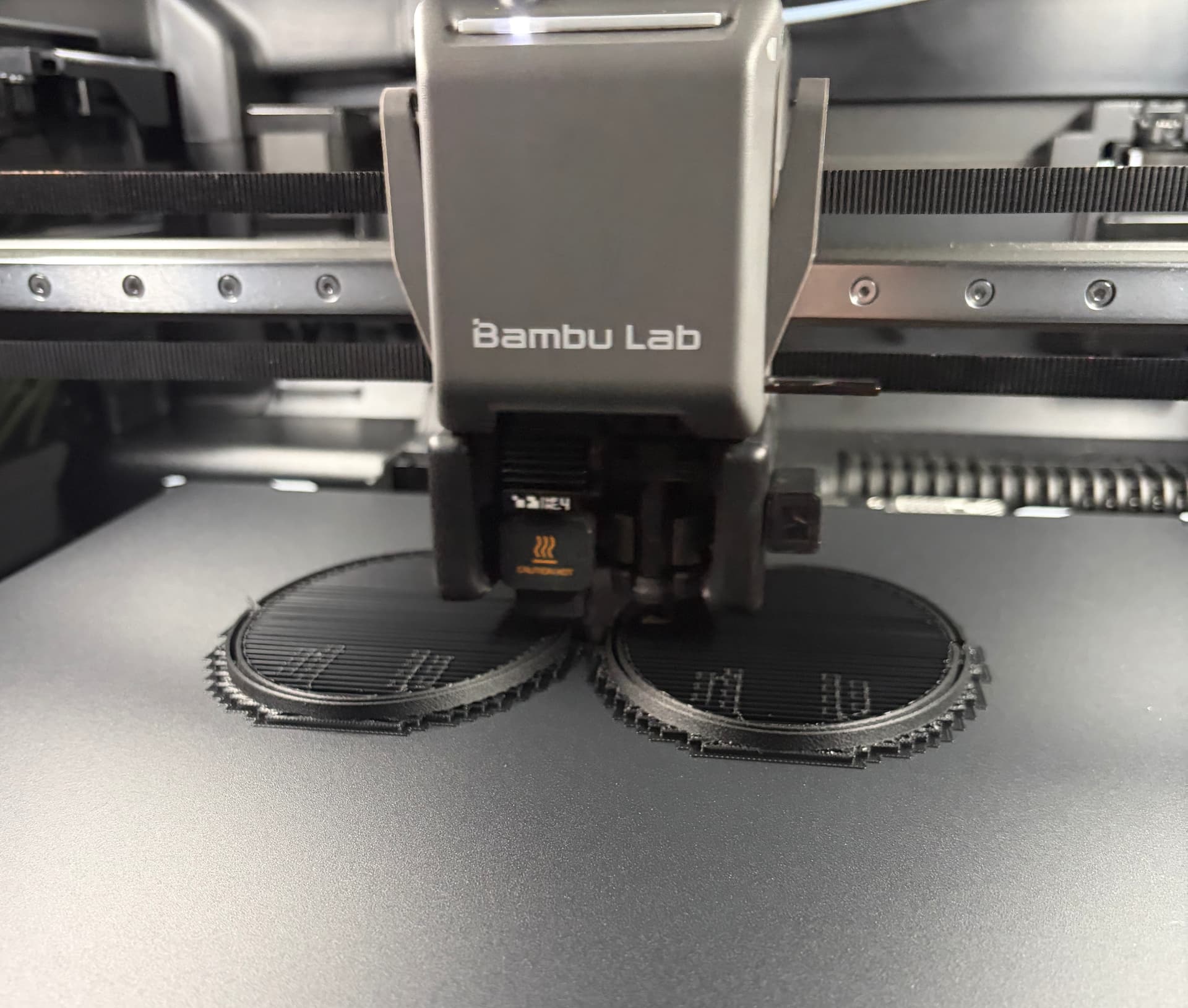

For 95A I have no issues with OEM PEI plate, comes right off. Its only 90A that sticks too much, but like I said on the new engineering plate no problems. I dont like glue either and only use my nano polymer for nylon or other extreme cases. But with the Glacier plate on H2D I had no need for glue with nylon either. Im doing a PAHT + ABS supports print on the engineering plate right now with no adhesive and seems to be working perfectly. This new engineering plate is different than the old one, seems to be very similar to the Glacier, ill post after this print how the adhesion is.
Definitely interested in the results.
The adhesion is really good for both ABS and PAHT. The PAHT is a very thin wall on that model, one line wide and it tends to curl up after the first layer on most plates. Only on the Glacier I had no issues and this engineering plate is performing similarly. Will let you know how the adhesion is when its time to remove it tomorrow, the extrusion priming line had very good adhesion when I removed it. If it keeps working this well I might skip the Glacier for the H2C. Will have to try PPA and PPS on it.
Well it stuck really well until the end and popped off after i let it cool and flexed the plate. If the grips does not diminish with time, I wont be buying the Glacier. This new engineering plate works great with PA and TPU, my main uses for the Glacier.

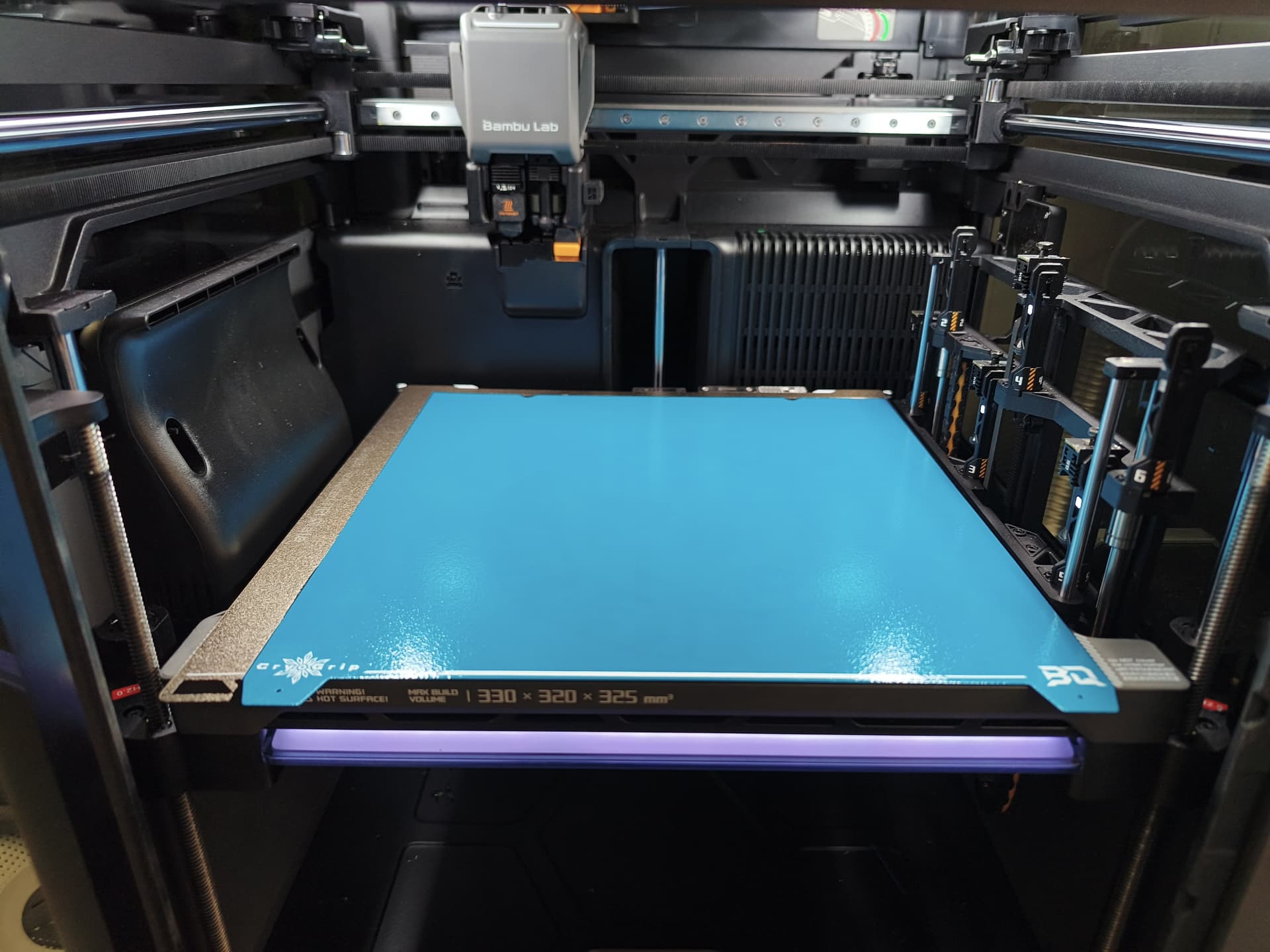

I LOVED my frostbite plate on the X1C! It worked great for every filament I used: PLA, PLA-CF, PLA-Wood, PLA-Cu, PLA-SS, PETG, PCTG, and TPU. (I don’t print in ABS or ASA)
When my H2C arrived, I tried the Bambu Textured PEI plate it came with and I was quickly disappointed when I had adhesion issues, even with large brims and careful temperature controls.
I went on Amazon and bought the biggest frostbite plate the H2C bed could handle which turned out to the be the 310x315mm for $50. Immediately, all of my adhesion issues went away. I placed the Frostbite plate in the front right corner and just avoided printing in the back or on the left. I did lose out on auto-bed leveling for a little while, but then I realized that I was never going to print on the Bambu Textured PEI Plate, so why not cut it and use it as a spacer?
You could have bought an H2D plate and cut off 10mm from each side to make it fit. How did you cut the plate?
What did you use to cut the plate

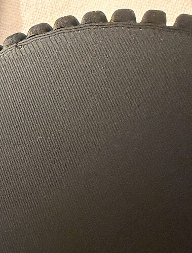

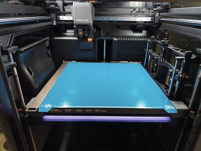

the new super tack for the h2c arrived today, have to say that I love the surface finish, even more than the glacier which has been my preference on the h2d
Here’s a pic (pla-cf)
