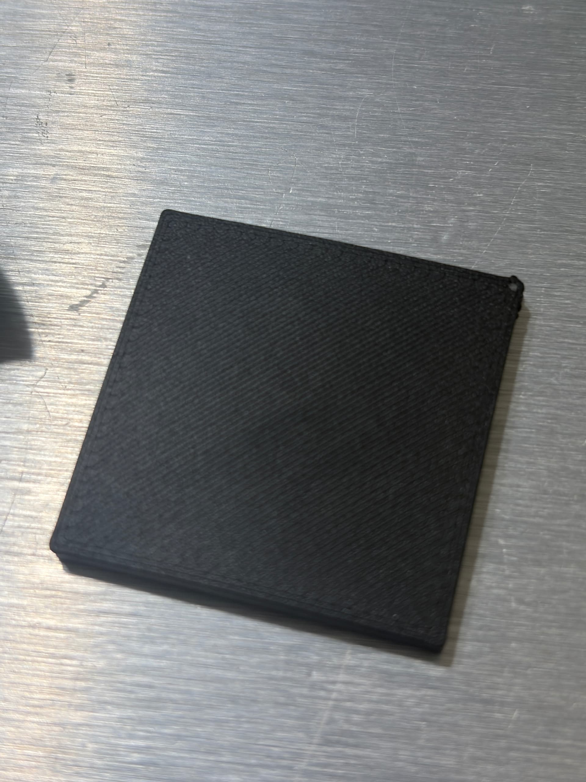

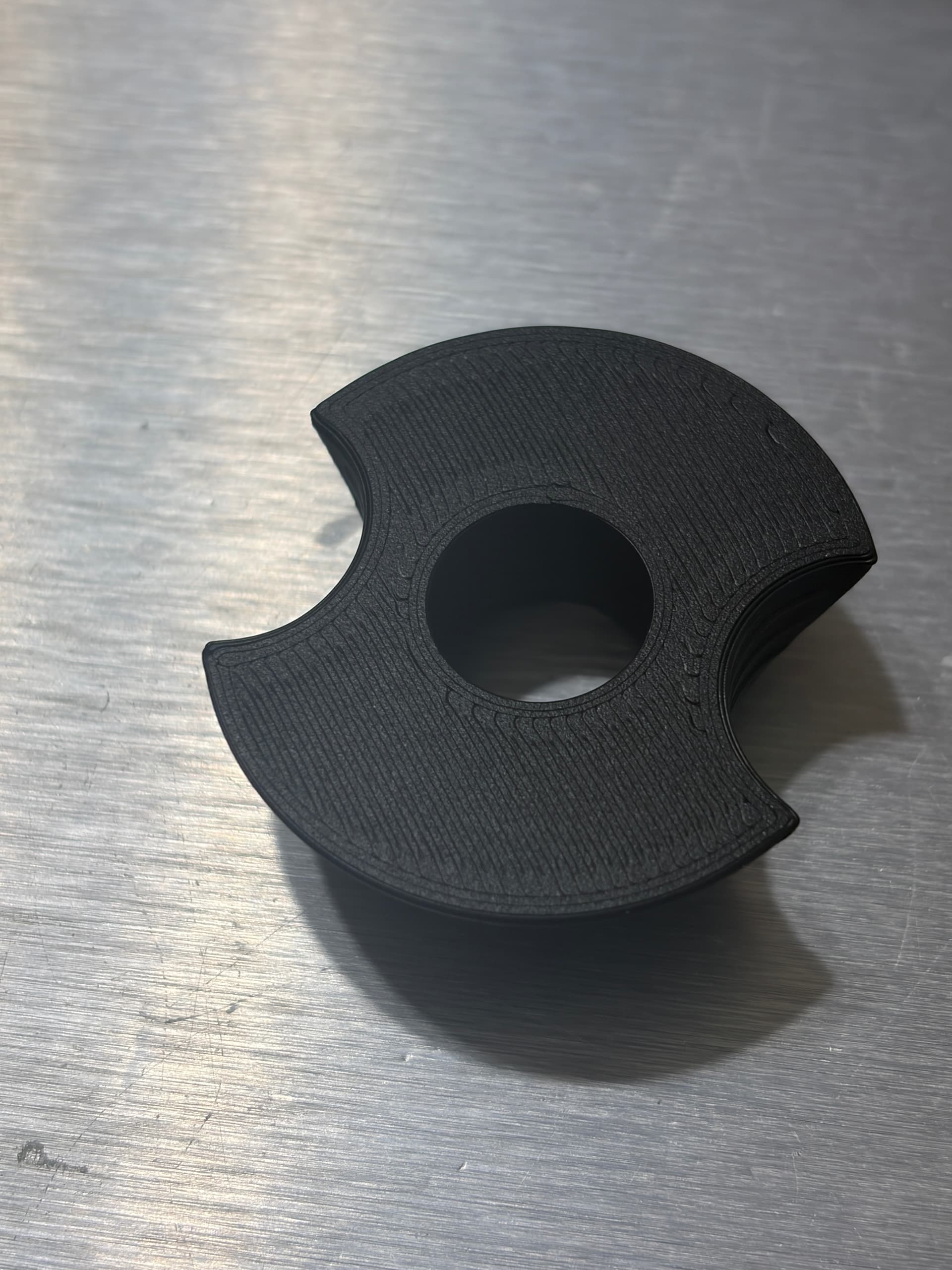

I got the new engineering plate and it leaves a very similar bottom texture to Glacier, matte and smooth. Works great for 90A and softer TPUs, on the textured PEI plate 90A was sticking too much without glue as release layer. Also works well for PLA items that have a flat contact area without glue. I will try PETG, ABS and nylon without glue and report back.
PLA:
TPU 90A:
Have you ever tried to apply a couple of drops IPA around the periphery after the print to remove the TPU?
The capillary effect pulls the IPA between the part and the plate. You just pick it of the plate without any problems.
Definitely no glue or other release layer required.
No have not tried that. I usually print my TPUs on an aftermarket (cheap) textured PEI plate that dont have a coating like the OEM one. No problems with TPU sticking too well on those, just have not purchased one yet.
Personally I hate glue and other stuff that needs to be applied to the build plate.
It’s messy and requires you to wash your plate regularly.
In the past it usually required a lot of force to remove TPU until I read a tip here on the community to use IPA to release it.
Works great on smooth and textured plates.
It’s definitely worth a try, given that your plate has no issues with IPA.
