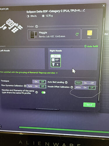

New H2C owner. Curious why it is messing with the left nozzle when my entire print is on my AMS riight nozzle? Is there somewhere I can set to prevent this waste of time?
What do you mean messing with?
Can you post your 3MF here so we can take a look at it?
I mean why is it spending time running all over the plate tapping the left nozzle on a print I am only using the right nozzle? I am very new and only print from the Bambu app so far. I don’t have a PC so all I have access to at the moment is the app from iPad and iPhone.
When you are only using the right nozzle, turn this off when you send the print. Or you can leave it on Auto. It should only do the offset calibration if it is set to on, or when you are printing with both sides and it is set to auto.
