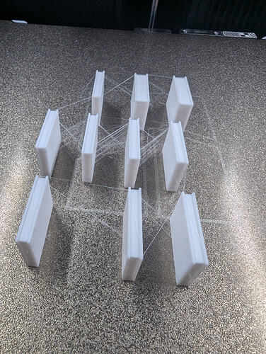

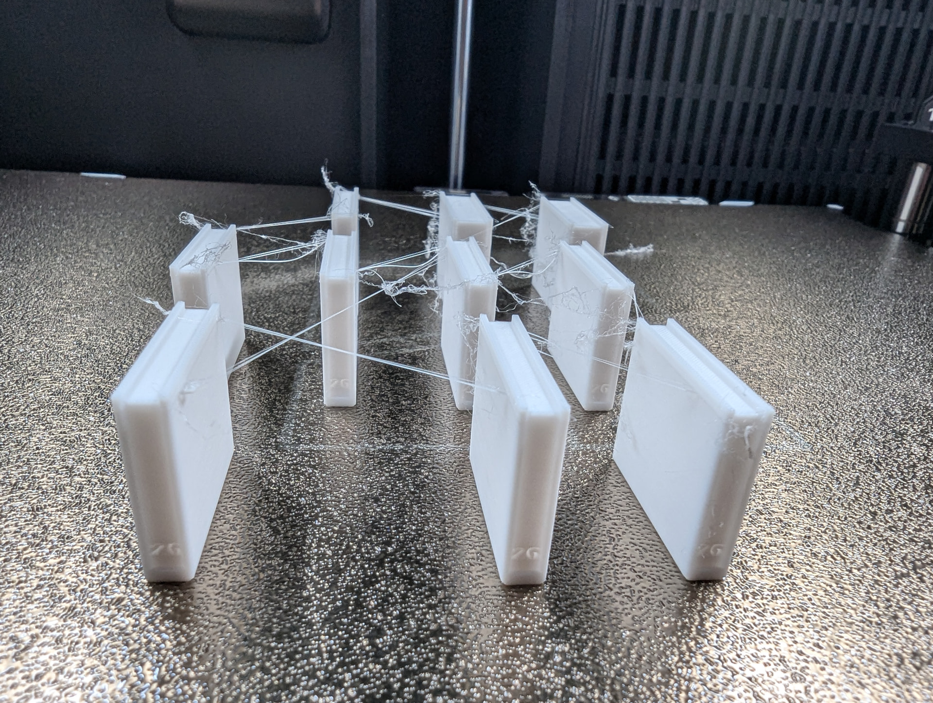

Hi everyone, I am really dissapointed with my H2C as I have issues with stringing, blobs and tolerances I never had with my X1C.
I already got a replacement H2C from the support but unfortunally I still have the same problems.
From the beginning I noticed that the walls on my prints were not as smooth and clean as on my X1C. I hat blobs around the prints. I also had problems printing relatively simple models from the Bambulab App. These were almost never a problem on my X1C but with my H2C I regulary get failed prints where the model has been moving on the build plate. At first I thought it was a bed adhesion problem (Textured AND SuperTack) but it seemed more that the print head was knocking things over.
I printed mostly with PLA or PETG. The problems were more apparent on the 0.2mm Induction Nozzle than on the 0.4mm. And even more, if I printed multiple small objects at once.
So I started some tests, contacted the Bambu support and ultimately got a replacement H2C. But with the replacemant I have the same problems.
I’m hoping that somebody can point me to a solution to my problems.
I printed these mini books for my tests: Mini books for anxiety bookshelf - Free 3D Print Model - MakerWorld
The results always looked like this:
I tried different spools of filament (also different colors) and also dried them before use (Sunlu S4 dryer). Always same results. Sometimes the toolhead also knocks one or two of the books off.
I also have random small pieces of PLA lying arount the build chamber after the prints. As if the nozzle knocks a little bit filamet off the print.

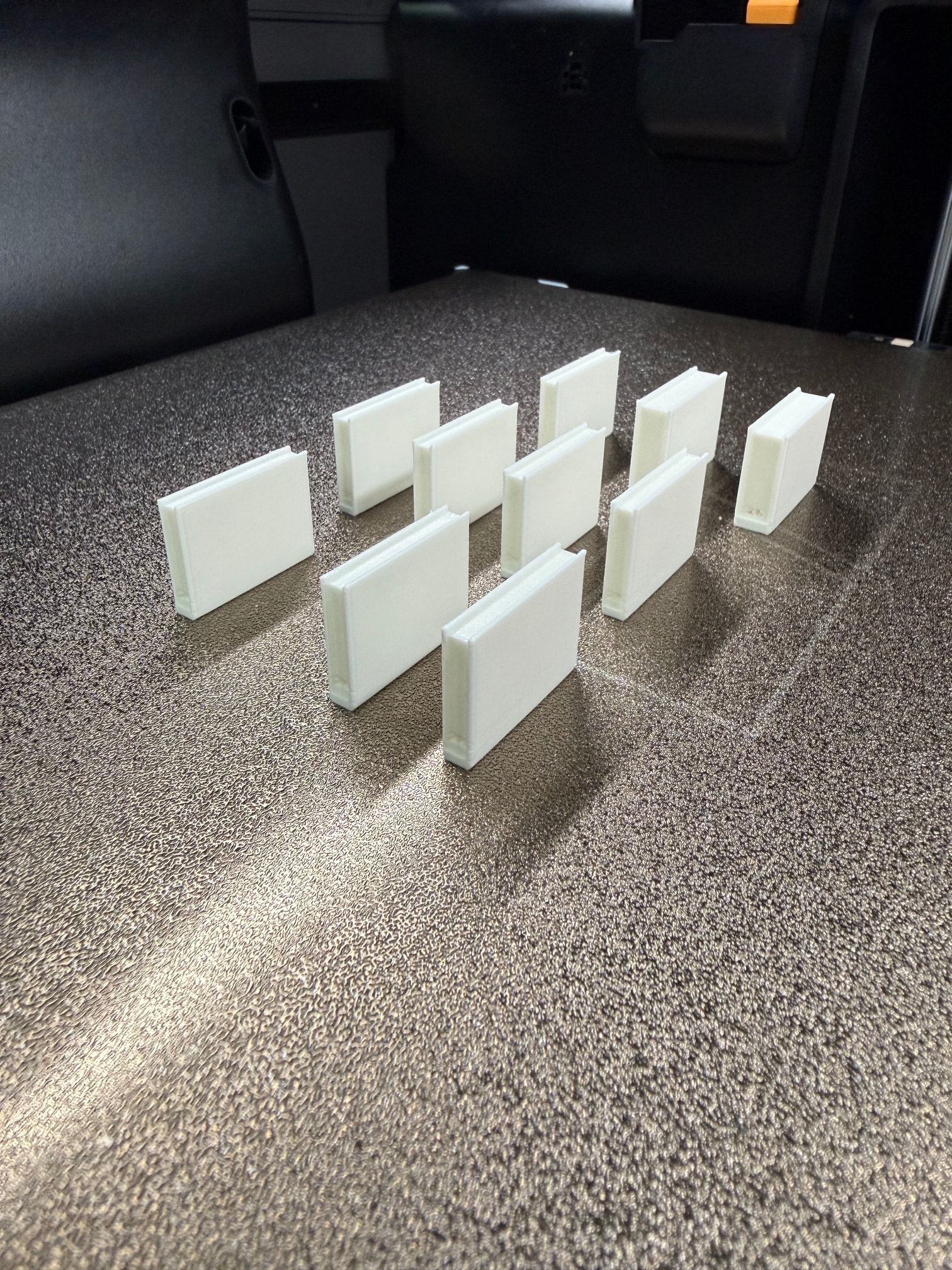

I also loaded the same spool into a X1C and printed the same 3mf file (just with X1C settings, of course). And the results were nearly flawless. Yes, there was a little bit of stringing on one of the back ones, but it was easily removed. The sided were clean and smooth. The edges were sharper than on the H2C:

There’s a very good chance this is due to the setting “reduce infill retraction”. May even be the reason for the crazy stringing, assuming your filament is dry and you’re running it with a proper profile.
This setting is supposed to turn off retraction and Z hop when the print head travels over infill areas. It doesn’t stay within the infill boundaries. So a little bit of oozing and no Z hop is surely to lead to collisions. This setting is known for taking out tree supports and scraping infill. Try disabling it and see if anything improves.
Have you created any custom profiles for your filament? - If this is what it is like from the left nozzle, try doing it on the right nozzle, and vice versa. also select bambu basic PLA as a test, see what it does.
My opinion: probably what you don’t want to hear, but you are really going to have to calibrate your filament / tune your filament to the machine. The H2C, while the “flagship” printer, still only ships with some basic profiles for filament and even more generic when you get down into a 0.2 nozzle.
The closest settings you could “borrow” from another printer would be an H2D. The X1C is going to have a completely different type of calculation for your extruder steps for instance (digital / analog etc.) amongst a plethora of other things.
You are looking at tuning pressure advance, retraction, flow rate, and nozzle temp. The default speed for PLA / PETG should be fine along with bed temp tbh. If you were running engineering filaments that need high heat / heated chamber then you for sure would need to do that as well.
There are all sorts of models / tests on Makerworld to be able to perform temp tower, retraction, flow rate etc., and it’s not very hard to do.
My 0.02c is I would start there. That’s what I’ve had to do for all my H2C stuff for high temperature filaments (99% of what I use). And now they print great.

Had a printer free so I tried the model.
The is ABS with my settings with high flow 0.4 nozzle at 30mm^3/s volumetric speed. 53 minutes for the print.
No issues I can see on a quick glance.

If you’re running third party filament and with a 0.2 nozzle. Can you run the Flow Calibration from your Bambu Studio. Most likely the profile is not optimal for your H2.

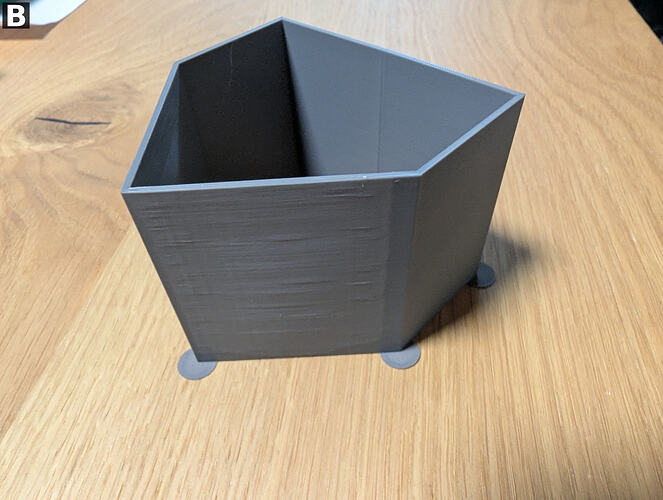

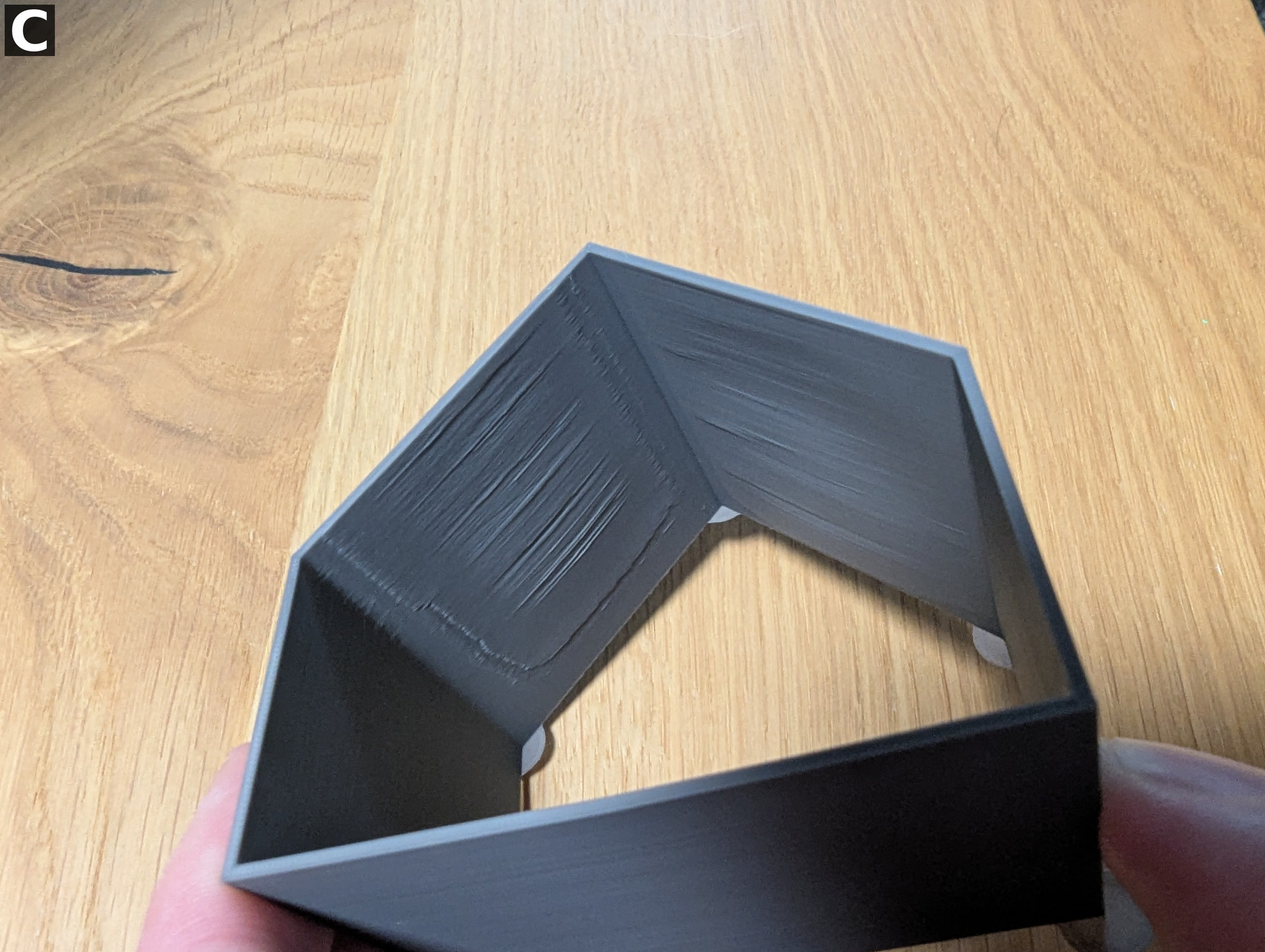

@Tool_Maker I tried to calibrate the filament and while tuning pressure advance I got some interesting results:
I did the calibration two times, once with Sunlu (white) and once with Bambu (gray) filmanet. Then I exported only the STL model and printed the model without different Pressure Advance values, just the plain model.
A: 0.2mm Nozzle, White Sunlu filament, calibration mode
B: 0.2mm Nozzle Gray Bambu filament, calibration mode
C: 0.2mm Nozzle Gray Bambu filament, only STL, Automatic Flow Dynamics Calibration enabled
D: 0.4mm Nozzle Gray Bambu filament, only STL, Automatic Flow Dynamics Calibration enabled
As you can see on the photos the diagonal walls have a lot of defects.
One side has them on the outside and the other side has them more on the inside.
This problem is not apparent on the 0.4mm Nozzle (D).
Any ideas?
