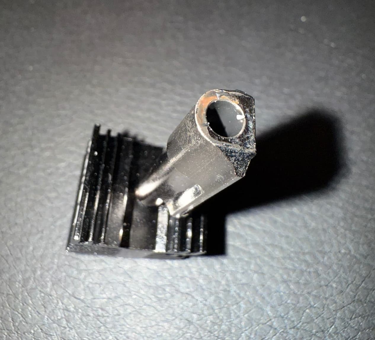

Well yeah… It’s due to the way how HF nozzles are made, since all of them have that “Y-spliiter” be a heat insert, so there is always a risk to literally yank that thing out.
(picture stolen from the same forum):
Not what happened to me. The thing failed internally from heavy use. Externally it looked perfect and the issue was not caused by cold pulling.
The nozzles are consumables at the end of the day. If you can justify the cost i see no issue running abrasives. For my hobby projects I prefer running non hf nozzles when using cf or gf.
