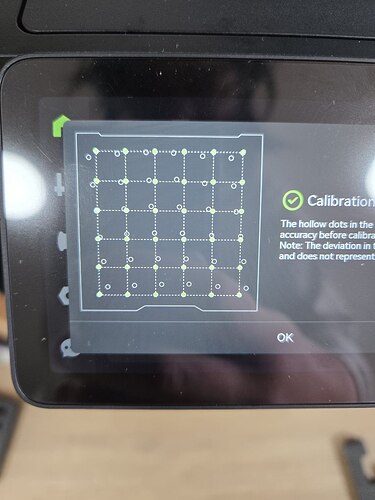

Then I went for bed tramming using a dial gauge. Well out of the box the tramming wasn’t good, had 0.8mm ish difference across all 4 visual markers on the plate. After the tramming, the area within 4 markers have been optimised but I didn’t go for the outer area. It seems that I’ve got a taco plate, which is sad because again my earlier H2D nuked it, both before and after tramming.
I did a motion accuracy test again, got same results as before, so I guess there’s nothing I can do for now, just trust the software and hope for the best.
  • 3. Print Quality
    OK Print quality as for now is ABSOLUTELY AMAZING.
