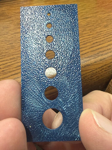

Yep. Here’s something with holes.
Would you mind printing the test model with standard profile we all use? https://github.com/user-attachments/files/26799077/holes_test_standard_profile.3mf.zip It is only a few minutes.
Looks perfect other than where I scraped it off too early, not letting it cool down lol.
Done in ABS (I don’t own a roll of PLA). HF BL 0.4 nozzle at 30mm/s volumetric speed.
I would say you’ve got some pretty good size gaps in your top layer. Way more than I had on my x1c.
Probably.. this was printed at super speed with a HF and no ironing. But it’s definitely not under extruding lol.

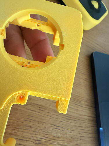

My bottom layers always look good. Black hides it well, but yellow, white, gray, they show it bad.

Yeah.. but you aren’t really showing anything bad there. You have a round nozzle coming up to the edge of a straight wall.
Yes, the circle is a straight wall that’s anywhere from perfectly perpendicular to the nozzle to almost parallel. And each time it goes into the wall of that circle, you are only allowing 15% (by default) of that nozzle to enter the wall area (which is tiny for an already tiny 0.4 nozzle), and a tiny model, and a tiny hole, then asking to retract and turn around.
That’s why you see the perceived “gaps” not where the nozzle is turning around with wall of the circle directly in front of you (perpendicular) but as that round nozzle of 0.4mm tries to angle into the wall of that circle that’s at even more of an angle and telling the printer that you will only allow 15% of the nozzle to get inside that wall before it turns around.
Because a wall that’s perfectly perpendicular to the nozzle, even at 15% of the nozzle only allowed to go into the wall, that wall still has coverage on both sides of the nozzle.
As you can see by your picture., at the extreme angles, a nozzle needs to go much further into the wall of that circle to fill the gap, but your slicer settings, if default, are telling it explicitly not to.
Change your infill / wall overlap to 35% and try the same thing. Change nothing else. Then you’ll probably see a large majority of the gaps you think are issues, dissapear.
The other lines definitely look like you have some sort of underextrusion, but you can control that in an infinite amount of ways for surface quality.
I’m sure the X1 / P1 etc., have perfect profiles as they have millions of more hours combined of people making profiles for them. The H2C you pretty much have BBL filament and generic to get you going.
I do believe that the stock Monotonic Line does not use the infill / wall parameter. If you change it to monotonic it does.
I have tuned it out with these three changes…
Top surface pattern = Monotonic
Infill / wall overlap = 45
To surface flow = 1.02

I can defenitely confirm that this is an issue. Not catastrophic, but an issue. I printed a remote and was not impressed with the bottom layer - I adjusted the flow rate 1.05 and it is muuuuch better. Now I will gradually take it down a notch, as this kind of fuses my prints to the bed.
