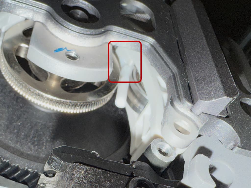

So it was jammed above the extruder.
I had to disassemble the extruder and pull it out from the bottom - which was a pain - because the filament was still in the filament guide which makes it hard to remove.
I’m including some pictures - one shows what I saw when I got the filament guide out, the other shows the filament itself.
What happened is while I was printing with PLA it was extruding fine. When it went to push the filament back out - it was too soft and just … mushroomed above the extruder.

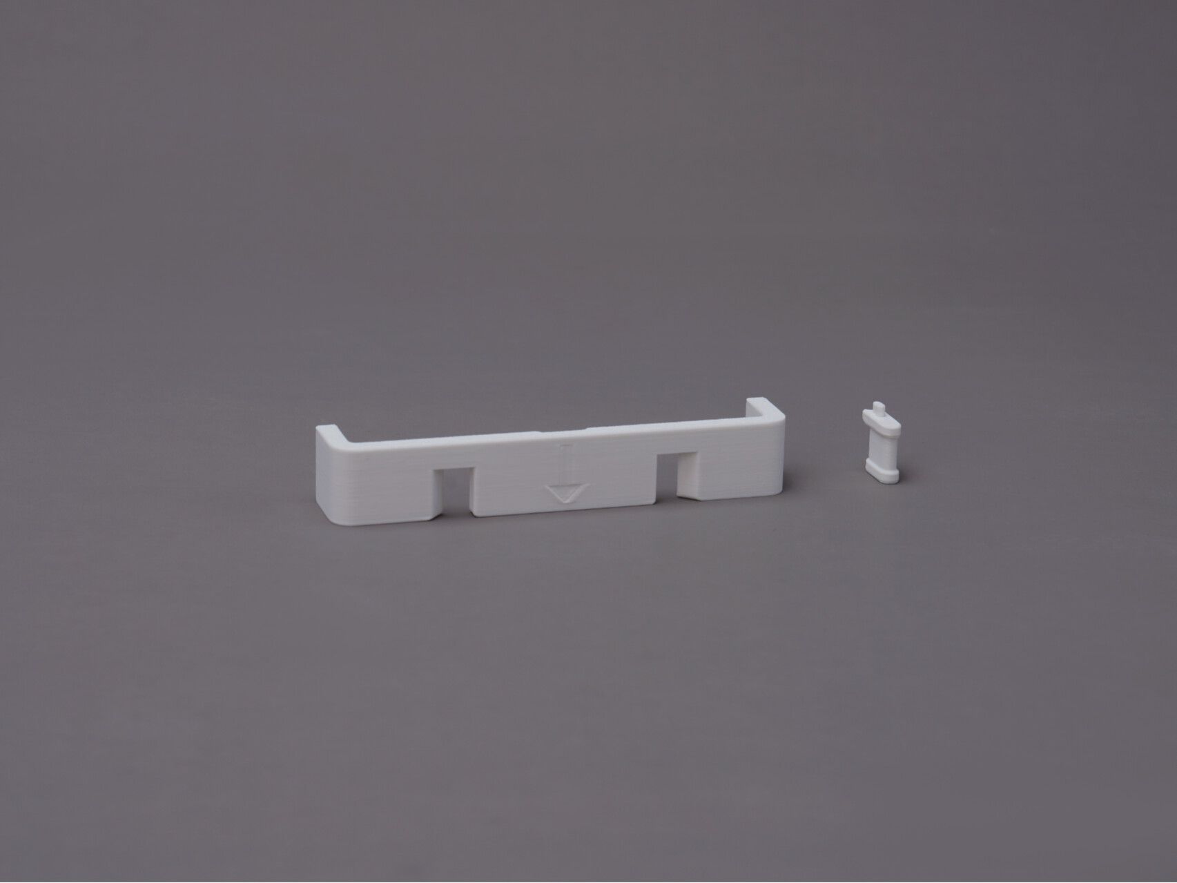

Most extruder clogs can be cleared by just removing the filament guide instead of full disassembly. Bambu also just published a model to aid with it:
That’s exactly what I did.
That said - those parts they used in that guide … I’m printing them now - those are fantastic.
