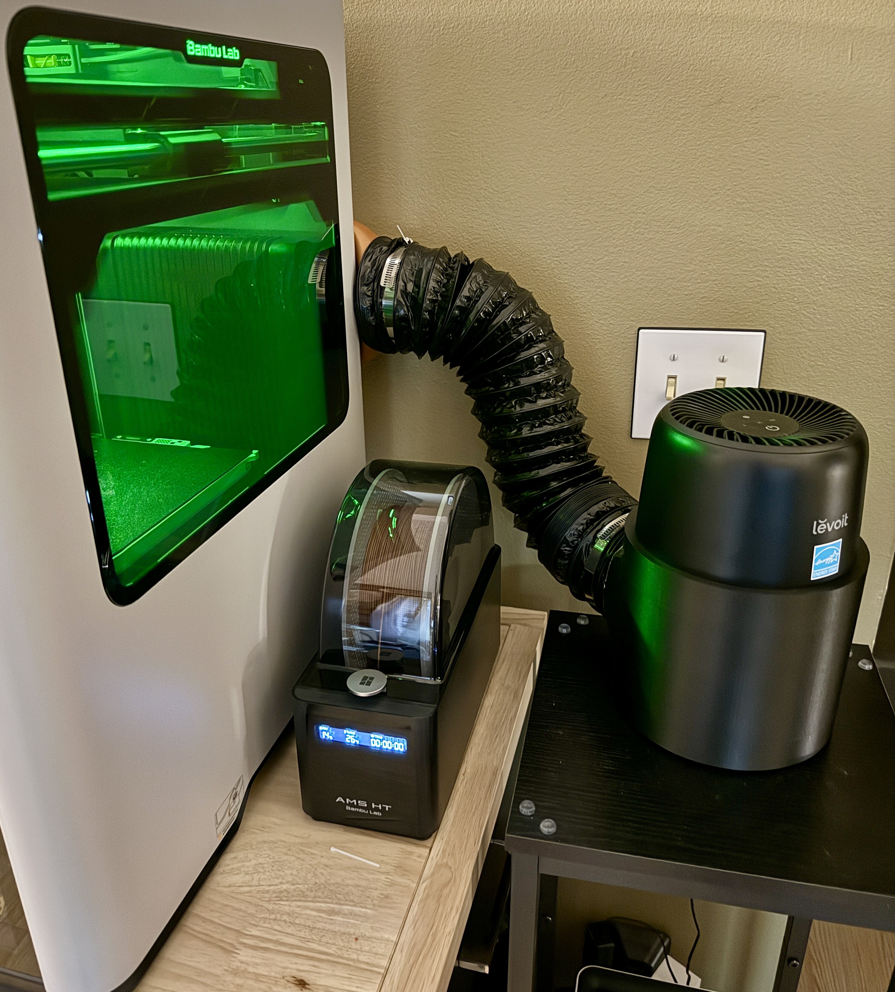

The levoit air purifier mod I posted earlier seems to be a better choice if you still want to extract and filter air but at a slower pace so chamber temps can remain decent for anti warping purposes. The levoit core mini on low setting with the H2D setting at 10%, with the inlet carbon filter mod 1/2 full, it pulls just the right amount of air to keep PETG chamber temps around 40. The high setting would facilitate a good chamber temp for pla (low 30’s). I might wind up keeping this setup.
I also have a laserpecker air purifier on the way that I will test out. Hopefully the air movement on the low setting isn’t too much like the xtool. It is much smaller, so fingers crossed. This might be a much better option than the Bambu smoke purifier for normal printing purposes. It’s cheaper (350), looks better, and filter packs are cheaper too. Wouldn’t be too hard to design a DIY filter pack though. Maybe one that uses like 3 or 4 Bambu filters.
Anyway, sorry for the X1-c content. Just wanted to let y’all know the xtool might not be the best option for printing fumes and keeping the chamber warm enough to mitigate warping prints. It might be way better than the Bambu one for laser stuff though. I don’t plan on lasering so I can’t test that one out lol.

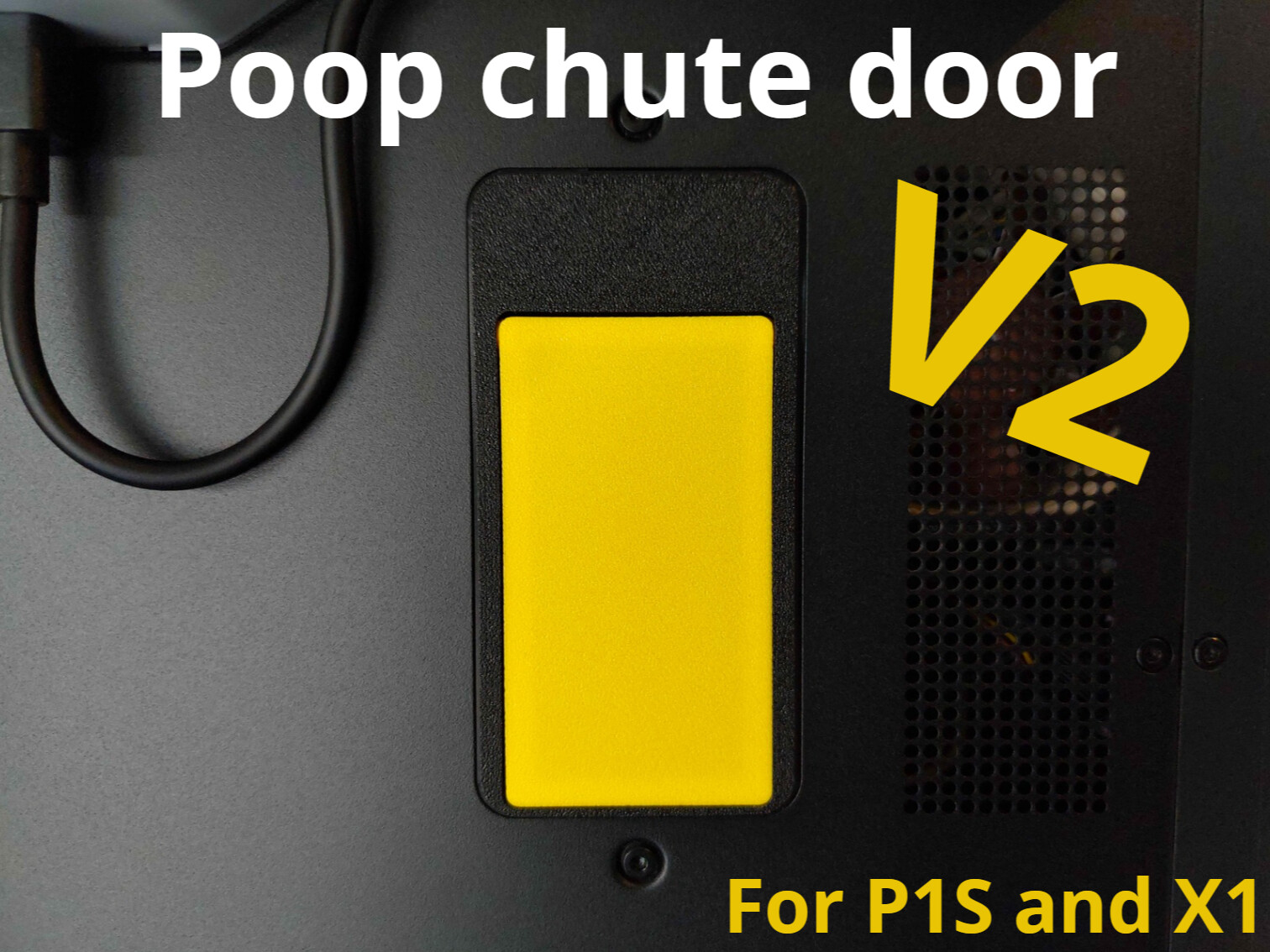

Taped up the poop chute port the other day (single colour print) made no difference to my AQM near/next to the poop chute in terms of VOCs although I didn’t pick up the poop - it may be the poop pile off-gases for a period of time after printing.

Printed it in ABS, added a little glue tape on the sides, more for the ā€œtactā€ and works awesome!
For what it’s worth, and if you’d like to keep a chute, KYZ’s banana chute does a good job of sealing the chute. Before I had it and would print bambu’s PETG-hf my meter and air purifier would go nuts during the purge process. Now with the banana chute I get nothing.

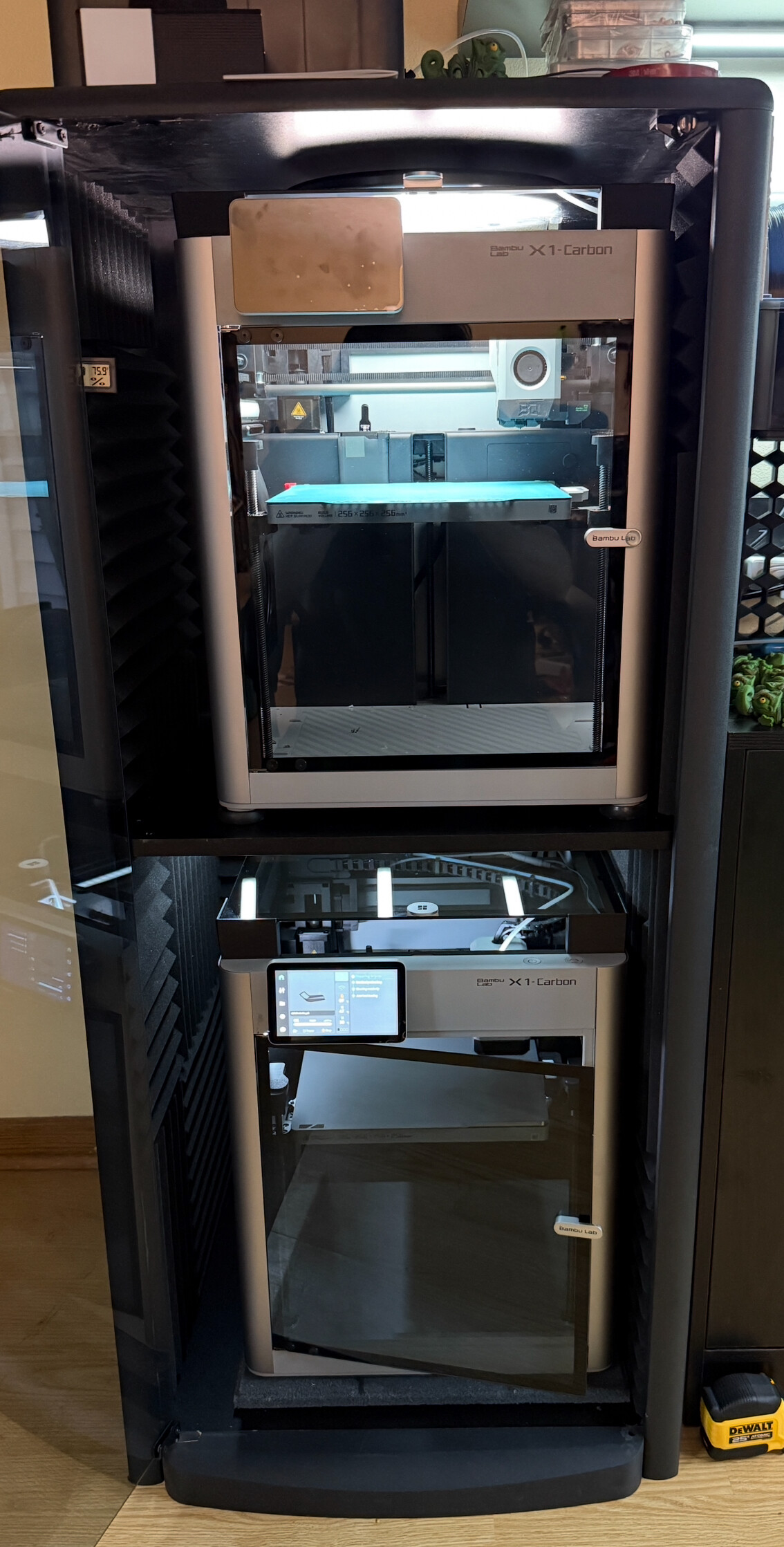

Once I find a more permanent spot for the H2D I’ll likely be buying the clearview plastics enclosure for it, or build my own, and will vent the enclosure air to the outdoors. Putting the box in a box is really the only sure fire way to go to maintain zero exposure.
Just had a look at the Clearview setup - interesting but gets pretty expensive quickly and that’s before I factor shipping and taxes. A lot of doors which is great for access but no great unless you run it as a negative pressure case as I can’t see any seals in the photos. Can’t see the re-circ setup being that effective as it must leak a fair amount of gas.
Won’t be able to fit the laser emergency stop on the small version either as its too tight if you also want to keep the external spool holders.
Be interested to see how heat soak impacts the prints that need the top vent open on the smaller case as its a tight fit in that one.

A framed grow tent is honestly the best and cheapest option. You will always have negative pressure with any sort of inline fan going on the for the extraction out.
Bonus is that these tents allow easy access to opening and closing.
The only reason anyone goes with the plexiglass is for looks.
As chamber temps for PLA and such, if you decide to keep the inline fan on, it won’t matter as fresh air will be brought in anyway because of the negative pressure. Else, you just unzip it open.
