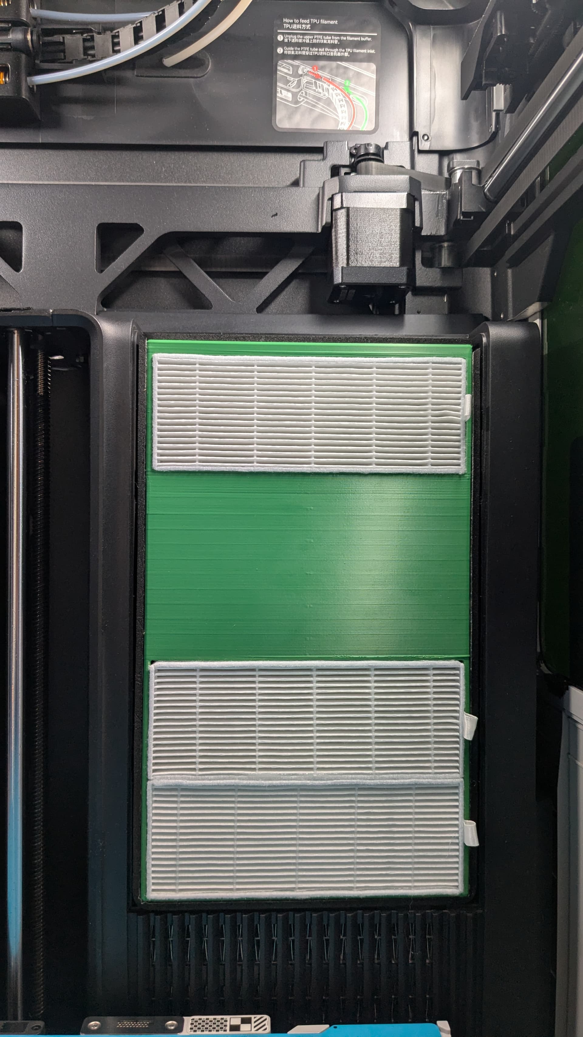

Really solid design! I printed it in Poly lite ASA it all assembled very easily. I just finished two prints in PETG. My shop smells much better! Thanks for sharing! :smiley:

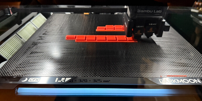

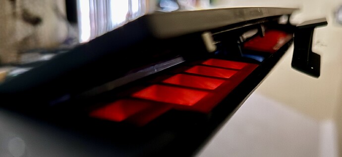

Just wanted to share this new model I printed last night. H2D top Vent - filter by DRCGRAPIX MakerWorld: Download Free 3D Models It filters the incoming air through the top vent with some foam. I’ve been waiting for a while for someone to finally make this so excuse my excitement lol. I just need to get some filter foam to throw in the buckets now.
I did slightly change the uploaders print profile with modifiers so that only the bottom of the buckets were mesh.
Looks nice. :slight_smile: What will you be using for the foam? Standardized filters or will you cut material to size yourself?
I bought some of this Amazon.com: PATIKIL 20" x 20" x 0.1" Air Conditioner Filter Replacement, Washable Reusable Cut to Fit Foam Filter Air Filter for RV AC Vent Window Purifiers Computer, 40PPI : Home & Kitchen and then will cut it to size.
I rated your model today(to which you responded)! My roommate(who pulled it from the printer for me) said it ‘looks certainly interesting’. Haha. I’ll be sure to post how the support removal goes when I get home.
Thank you for making that for us.
Printing and reviewing remotely, while on vacation, that is commitment to the craft :smiley:
xD. I actually have something else going that is probably be done by now.
